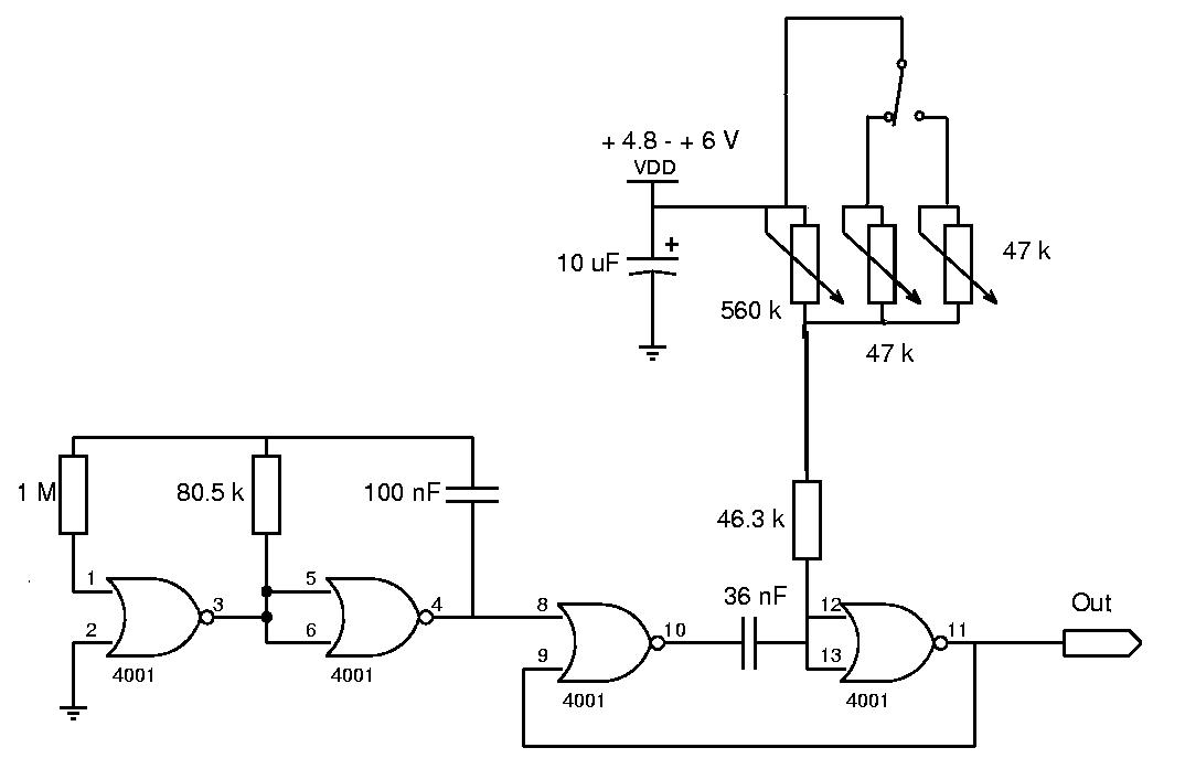

I need to open and close a "door" with a single push botton switch only, with a hobby servo, all I found is using RS232 and controlled by a PC.
I do not need that, all I need is a single push botton that does the open and close a "door". (move forward and back)
where can I find this simple circuit diagram DIY ?

You could easily do it with a PIC (which would make you component count VERY! low). However, you can easily use a couple of 555 timers and a handful of components to do it, try googling for "servo tester" - it's a VERY common project!.

yes I fount the tester using 3 bottons, left, center and right.
but since I'm not electrnic person I can't modify using 1 single push botton to do left and if I press again it will rotate right.
this is what I want.

there are plenty of toggle circuits using CMOS chips in the forum.
just add one more inverter to this and make sure to connect upper side of potentiometers through diodes to outputs of toggle circuit.

sorry, no time... you can forget the toggle circuit and just use maintained button. connect common to +V, NC to one pot (set closed position), NO to another (set open position). you could replace sw. contacts with outputs from another circuit.
