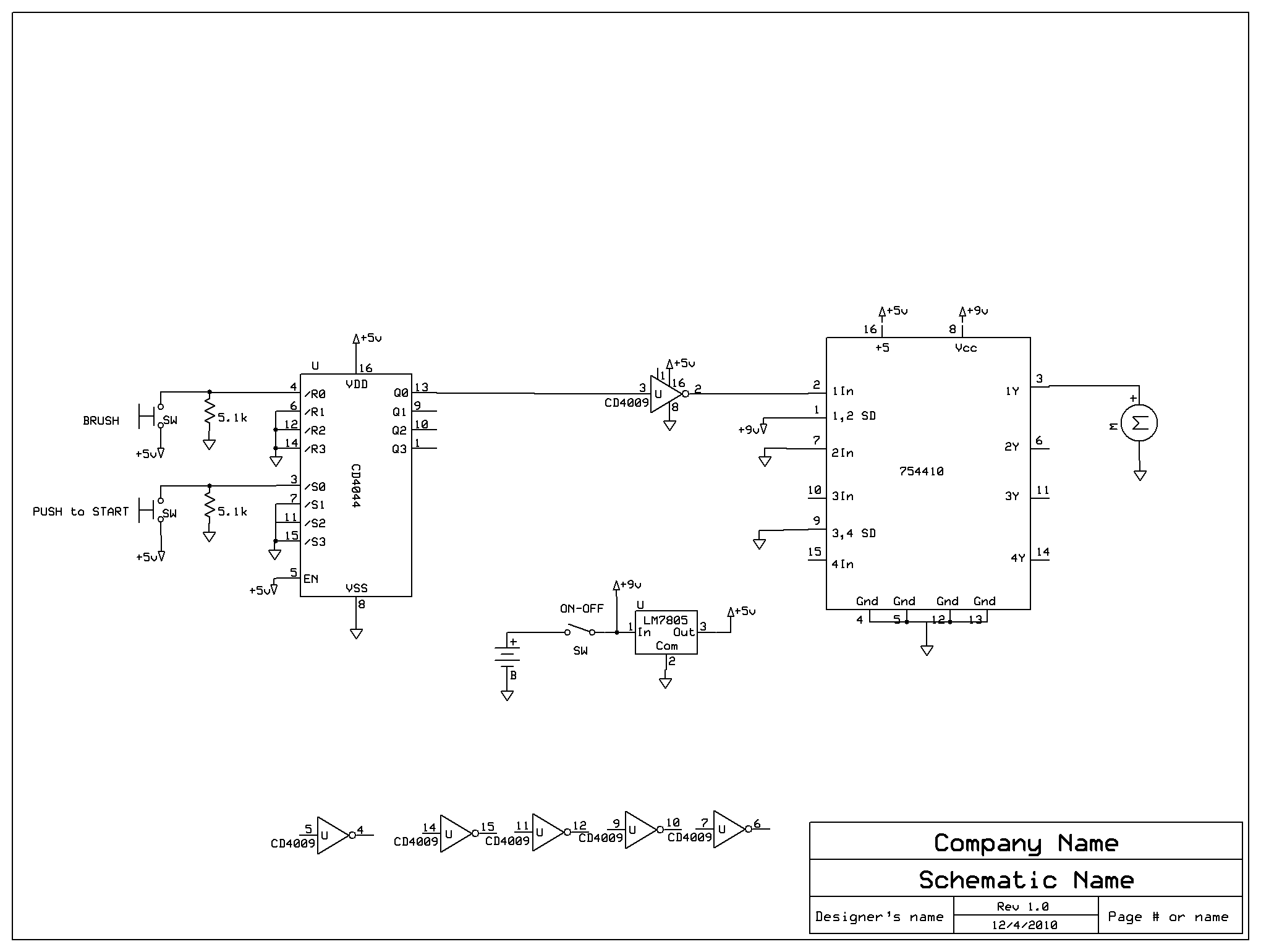

Auto Driver
Here is a circuit using a brushed gear motor like this one. **broken link removed**
A switch to set a latch to start the driver, and the brush idea to reset the latch.
An inverter to get the polarity right for the motor driver. A motor driver.
I think this configuration will brake the motor when it hits the stop so it should stop quickly. If your screw is like a 4-40 you should be able to get withing a couple of hundred micro inches.

If a stepper motor is indeed the most accurate motor for my application, I would require just a stand-alone driver, with speed control. It would also only need to rotate in a clock-wise direction. And of course a way to stop the spinning of the motor as soon as it makes contact with the shim.
Using your electrical sense method, how would you over come the problem of, as soon as you put the driver on the screw it would complete the circuit? Unless your rocker arms are made from a non-conductive material as soon as the shim and driver are both in contact with the engine the circuit is completed, and the motor won't turn.
I thought about that, and I wondered if it would be possible to coat the underside of the shim with a non-conductive material. But then again, that would most certainly wear out after only a short little while, and render the entire project a failure. I could change my point of view slightly and try to keep things simple. The "clutch ball" works as it should in its current design. I could keep it as simple as possible and use a motor to spin the clutch assembly, and allow the clutch to disengage as it currently does. That would certainly reduce the wrist strain demonstrated by the operator who has to constantly spin it to adjust the tappets.

How about we limit the current (thus toque) to the motor and just let it stall when the whole thing comes together. This would keep the torque constant on the screw while the nut is tightened. 20 um! Things have changed since I adjusted lifters.
Perhaps I may have confused some of you. The spec for these particular lifters is 0.24mm, if I'm not mistaken. The range is plus or minus 10 microns, thus the 20 micron range. The clutch ball does an excellent job of keeping it in that range. It does however vary, and its quite inconsistent. The goal is to make the job ergonomically more friendly, and also hopefully try to illiminate certain factors that would cause those inconsistencies.
