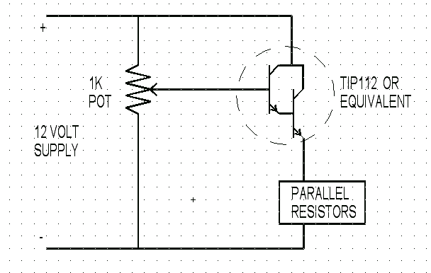

thanks for your replies gentlemen, but as i said, im a complete newb.......could any guys point me in the direction of suppliers(uk only) and part numbers please
Will this be easy for me to integrate within the circuit i already have?

could 1 of you gentlemen be as kind as to draw me a very very basic circuit diagram for the above please?.......i know its an ask, but i really do need to sort this asap, as i can't take my 'scope out for very long before its frosting up!!
As i said, the more basic the better.

Here it is:
many many many thanks...........just got time to go get the bits, put them together before tonights observing.......many thanks again
