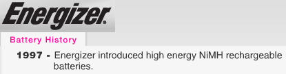

Also AG Energizer doesn't make many NiCd's anymore and I'm not sure what PDF you're referring to but if anything was obsoleted it was that specific NiCd chemistry. New anode/cathode materials membranes and variations on electrolyte chemistry have been developed, just not be Energizer. Sanyo has something like 4-5 different specialized NiCd cells currently in production.
Energizer has most of their Ni-MH cells made for them in Japan, maybe by Sanyo. Their Ni-MH 9V battery is made for them in Germany.
They mass produce their own alkaline cells in USA. I don't know about their tiny cells for watches and hearing aides.
They haven't sold a Ni-Cad cell for about 14 years when their much better Ni-MH cells were introduced and obsoleted the old Ni-Cad cells.

ag, please refer to the following links.
https://www.electro-tech-online.com/custompdfs/2011/06/nickelcadmium_appman.pdf
That's the last reference to an Energizer product that I can find that includes information about NiCd's, and it's 10 years old.
They might not produce them anymore, probably never did as you said Sanyo produces their NiMh line, Sanyo still produces NiCd's, Energizer just stopped selling branded NiCad's publicly.. Oh wait....
