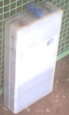

I just acquired a bank of 10 nife nicad batteries as shown in the photo, but 1 of the batteries was tipped over some time ago and the electrolight was spilt and not replaced. The voltage on this battery is 0.97 volts where the other 9 batteries are all around 2.47 volts. also there isn't any details of the amp/hour capacity on the label but here are all the specs off the label
maker:- NIFE made in australia
Type:- SBH38-2
IEC Standard:- RPH38P
Code:- 941
Now for the questions
1) I assume the electrlight is just distilled water, is this correct?
2) I've searched the net for hours to no avail so how can I work out the amp/hour capacity
3) since the electrolight level is nearly empty and the voltage is down to 0.97 volts is the battery stuffed?
I have made up a smart battery charger that will charge nicads aswell as every other type of battery around so once I replace the electrolight I can try to charge the battery.
Cheers Bryan1

Hi Bryan,
Google couldn't find Nife of Australia but instead quickly found Nife of India. They make many batteries, their link is here:
Hi Bryan,
NiFe is not exactly the same as NiCd the Fe stands for iron since they from the beginning (100 years ago) made the negative plates of iron. The electrolyte is an alkaline mix of potassium hydroxide and a small amount lithium hydroxide, do not fill it with water if it’s nearly empty! If the plates and mass in the empty cells have dried out they can get irreversible damage.
Thanks for the quick replies Audioguru and Ante :D
I've sent off an e-mail to hblnife with the battery specs and I will go and see the local battery expert in my nearest town tomorrow. I really hope the battery is OK as shown in the photo there is still about a 1/3 of the electrolyte left and I intend using these batteries as part of my hydro project described in another post.
Cheers Bryan1 :)
