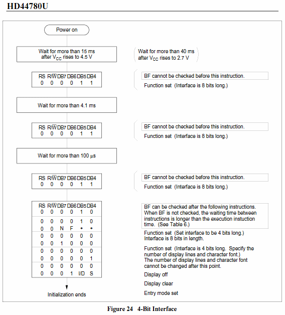

I'm a bit confused how he sets up the LCD.
He sends "Display Shift is On (0x28)" to lcd which is 101000 binary, the MSB is the 5th one, which points to that he modifies the "Function Set" register (according to the table he has on his LCD tutorial page). But there is nothing in this register that has to do with shifting, only the bits for selecting 8 or 4 bit interface, 2 or 1 line mode and the dot format.
The register he should be modifying is the "Character Entry Mode" with the value 111 which is 0x07 to turn shifting on. Despite my observations his routines work. WHAT am I missing here?

Nigel's tutorial works with the assumption that the LCD has correctly powered On self reset and ready to accept command.
However, this self reset will only occur if the power supply line rises to correct voltage within 10mS max. according to the HD44780 datasheet.
In all other cases, you are better off following the manufacturer's Init. procedure to the word.
To set the display shifting you need to set bit 2 to 1.
