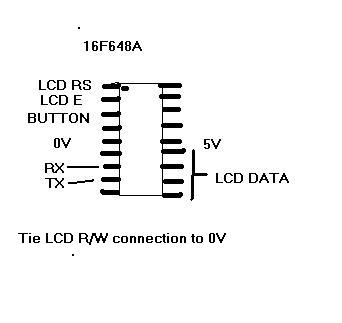

I've built an NMEA: LAT LON TIME ALT reader with TX, I can share.
It switches between LAT LON and TIME ALT, by pressing a button, and gets it's information from a GPS, such as a NEO-6 module, connected to a 16F648A PIC RX pin.
When button not pressed, it will output TX using two wires, Gnd and signal and needs an FTDI serial to USB adaptor to connect to a computer.
Have fun,
Camerart.
'PIC 16F648A 4MHz INT NMEA LCD 260316 0900
