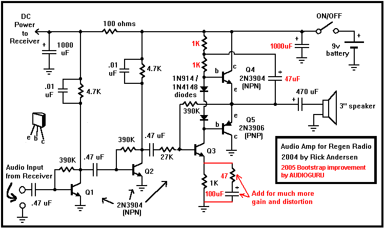

Here's the interesting part. As soon as I try modifying the amplifier portion of the radio, it seems that I'm getting an extra tuning control with my hand. As soon as my hand is at most 2 inches away from the actual tuner, the stations automatically change on me. I don't want this to happen.
Basically, my amplifier design is quite similar to Rick anderson's own version of the "Radio Shack powered amplifier". found at this link: **broken link removed**
BUT I have made a few modifications.
The amplification stage on the left is eliminated.
the 0.47uF is changed to 100pF because the results are clearer and sound less distorted (and less volume).
the 390K in the 2nd stage (of his circuit) is changed to a 1.5M. Another 1.5M is placed between base and ground.
Both 4.7K resistors are changed to 20K resistors, and the capacitors connected to them in parallel are removed.
the 0.47uF capacitor between Q2 and Q3 is changed to 0.1uF and the 27K resistor is shorted because I dont want to lose too much volume.
the 390K connected to Q3 is changed to a 470K.
the two diodes are changed to one diode and its part # is 1N4007
the 2.2K on the right is changed to 4.7K.
the 1K between Q3 and ground is changed to 12 ohms.
Transistors Q2 and Q3 are now BC547's instead of 2N3904's.
Transistors Q4 is now TIP-31 and Q5 is now TIP-32.
My power source is 6VDC.
So is there anyway I can improve the signal quality without losing a great amount of volume? and is there any way to minimize or prevent the stations from continuously changing as my hand moves anywhere within two inches of the tuning capacitor?

Why?, I hesitate to use the term 'random changes' again, but this appears to be what you have done again?.
Fair enough!, if you only need low gain you can remove that stage.
BAD MOVE - 100pF is FAR too small, 0.47uF should be fine, leave as 0.47uF!.
BAD MOVE, the 390K provides local negative feedback, your change will reduce the quality and upset the DC conditions of the stage.
Sounds another BAD MOVE, why did you do this?, and what is the collector voltage now?, an dwhat was it originally?.
SERIOUSLY, SERIOUSLY BAD MOVE! - the 27K resistor is one of the gain setting components (along with the 390K) - you should refit the 27K, and I see no reason to change the 0.47uF, all it will do is reduce your bass response.
Again WHY?, you've already ruined the operation of the stage, so it can't really make it any worse!.
Again WHY?, they set the idle current of the output stage, doing this will give MUCH higher distortion at low volumes.
Why?.
Another BAD MOVE - presumably for no good reason?.
No problem with that.
Or that!.
Probably NOT a good move, more voltage is always better, 6V is pushing this type of amplifier a bit.

You should have titled it, "How to ruin an amplifier design". Sorry. :oops:
Goodbye bass and most other audio frequencies.
Less base current and the 1.5M from base to emitter has such a high value that it doesn't do anything.
Increasing the resistor's value increased the gain about 4 times for each one and agrees with the similar change of the bias you made with the 1.5M resistor.
The caps reduced high audio frequencies and it probably sounds better without them.
The cap change doesn't make much difference.
Shorting the 27k resistor makes the amp have about twice the gain. It works because the output impedance of the preceding transistor is about 20k. It won't work if the transistor had a low output impedance.
Its value should be adjusted for about half the supply voltage at the output transistors where they connect to the output capacitor. The resistance depends on Q3 because each transistor isn't the same.
Now you have crossover distortion. Two diodes are used in all audio amps to provide temperature compensated about 1.3V between the bases of the output transistors to keep them turned-on slightly.
With a single diode or no diode, the transistors are off until a high enough signal level abruptly turns an output transistor on.
The 1N4148 diode spec'd closely matches the base-emitter diode of the transistors. The big 1N4007 rectifier doesn't.
The amp will have about twice the gain but its 390K resistor will need adjusting to compensate.
The max output level will be reduced.
This totally messes-up the DC bias. Use the 1K resistor as shown, and connect a 47 ohm resistor in series with a 100uF cap across the 1K resistor for much more gain and distortion.
Same things but different pins layout.
TIP power transistors have much less current gain than small audio transistors. They will work in this circuit but will produce a lower max output level and have more distortion.
The max output level is reduced to about half.
The biasing of all stages must be adjusted by a similar amount since they were designed for 9V.
Why not make the circuit as designed, removing the 0.01uF caps at Q1 and Q2. Add a bootstrap network as the load for Q3 for a higher max output level and much less distortion.

Add a filter cap across the power supply. All battery powered circuits should have one. :lol:
Why not make the circuit as designed?
Because the original circuit was intended to operate at VHF, and I want to enter UHF. And I thought I got more gain by increasing the negative feedback resistors in each transistor stage.
Thanks for the circuit.
In your last circuit, is the impedance of the signal entering Q3 27K, 31.7K, 4.7K, or am I lost?

Yes, I'd have added the bootstrap circuit as well, it's a VERY simple change, and will increase the power capability of the output stage quite dramatically (particularly with the low supply rail).
The input impedance of the power amplifier will be roughly 27K (the value of the input resistor), it's basically a simple inverting opamp circuit.

The bootstrapping in my last posted circuit increases the AC amplification of Q3 to a high amount, therefore with negative feedback through the 390k resistor the input impedance of Q3 is very low. The 27k resistor determines the input impedance of the Q3 to Q5 output amplifier.
I think you would understand DC biasing, AC gain, clipping and crossover distortions much better if you used an oscilloscope and a sine-wave generator to see what happens when you change something in an audio circuit:
1) You could change the negative feedback resistor in a single transistor stage and watch its collector voltage change with it, until the transistor is cutsoff when you will see the top part of the sine-wave get clipped, or until the transistor saturates when you will see the bottom part of the sine-wave get clipped.
2) You could also see a high level output of a high output impedance single transistor stage get reduced by being loaded-down from connecting a low impedance circuit to its output.
3) You could also see the interaction of stages and see the gain of the Q3 to Q5 output amplifier get reduced by increasing the value of its 27k input resistor when you expect more gain from the preceding single transistor stage since it wouldn't be loaded-down so much.
4) You could short one or both bias diodes in a complementary emitter-follower output stage of an amplifier and see the crossover distortion that is produced. :lol:

You basically told me everything I knew in general.
But I have a question, and I'll say it again.
What is the maximum reactance I can have at audio frequencies? and what is the limit on reactance at RF?
There is no set maximum or limit, but above (or below) certain values the changes cease to make any difference.
For an example, consider a simple high pass filter - a series capacitor, and a resistor from the output down to ground.
When the frequency is such that the reactance of the capacitor equals the resistance of the resistor, the signal passing through will be attenuated by half - a simple potential divider with equal values.
As the frequency increases, the reactance of the capacitor decreases, and the attenuation of the potential divider decreases. You will eventually reach the point where the attenuation is negligible - increasing the frequency further will have no further noticeable effect.
Incidently, this simple high pass filter is one of the design elements you were altering by changing the coupling capacitors.
I think there is a catch,
but I'll take your word for it and I'll see if my design improves.
I think capacitors are a benefit to my design. I just added another one between base and +ve of the NPN transistor driving the push-pull pair.
there was already one between base of the same transistor and ground.
It seems that station quality at VHF improves from this.
Now its a matter of finding perfect values.
This is what I mean by 'random changes', you appear to have no idea what the capacitor you've added is supposed to do, nor if it should be there or not?.
In actual fact it's simply in parallel with the lower one!, depending on it's value it's probably giving treble cut?.
If I only had a cap from base to ground, then I would get more treble. If I had both capacitors, it seems that more bass is applied, and therefore, the sound is more normal.
