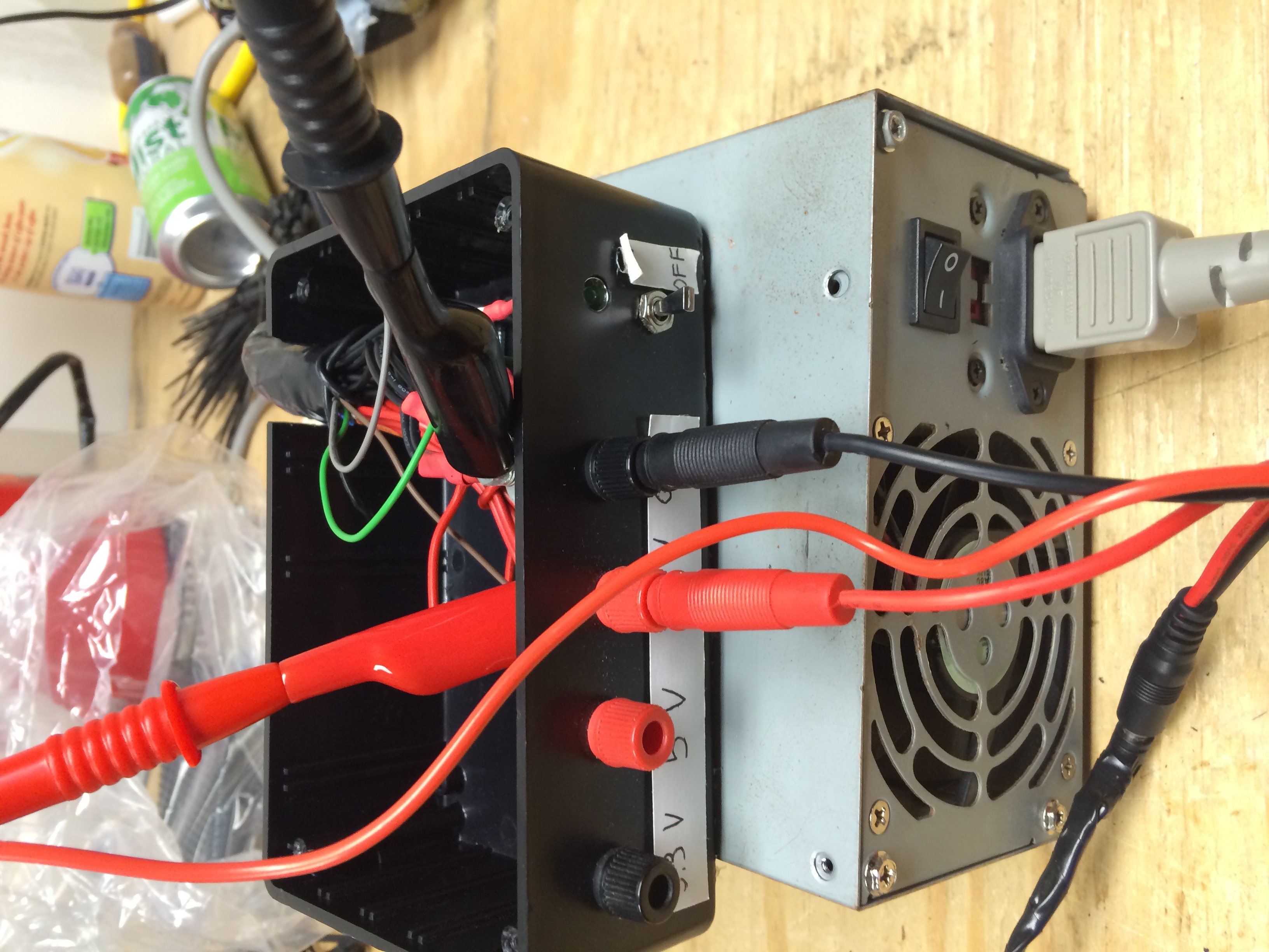

recently I put together a SSTC based of this scem( https://uzzors2k.4hv.org/projectfiles/pllsstc1/PLL Half-bridge SSTC 1.GIF ). I put everything together and powered it up with mains 120v not realizing I had to tune it first. I blew the IRFP450s and ordered some new ones. after that i realized id forgotten to put in the feedback antenna, a dumb mistake on my part. so i put the antenna on and got some new mosfets in and started it up with about 30VAC. i get no output. when i try to tune it with the pot it seems to do something though, my 30vac supply starts humming at different frequencies. since its doing that i would think i didnt fry the chips. unfortunatly i have no scope to see any of the wavelengths to see if thing are working properly. and i also dont have the money to get new chips, so incase thats not the problem is why ive posted this thread. im young and naive so im having many accidents :D any help would be very appreciated!
Could you post a photo of your setup? I think it will help a lot.
Thanks,
Matt

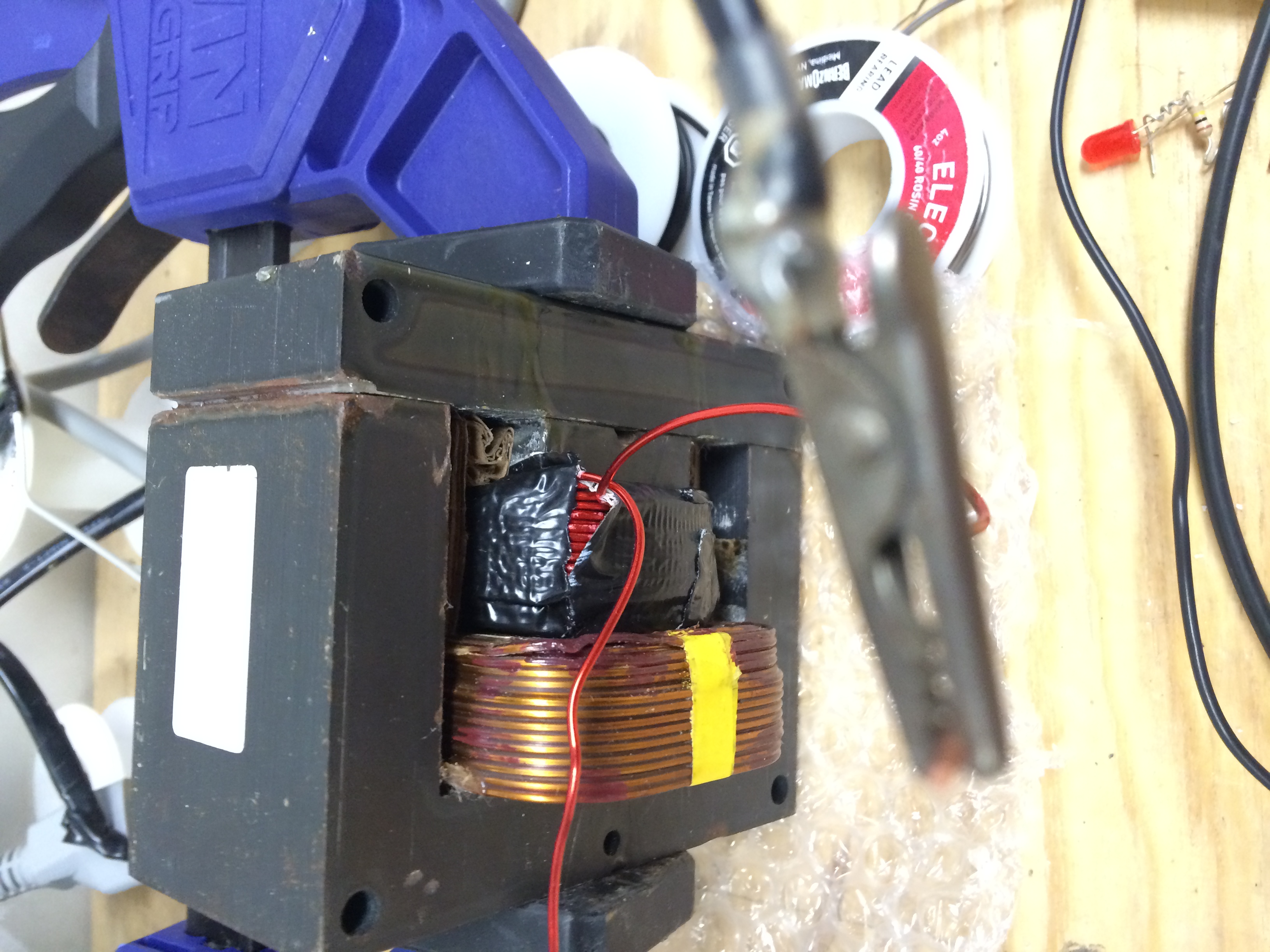

Also, what are you using for your main transformer? Did you make sure the two primaries have opposite polarity? That is very important. If they are wound the same direction you will not get the necessary oscillation on the Tesla Coil primary.

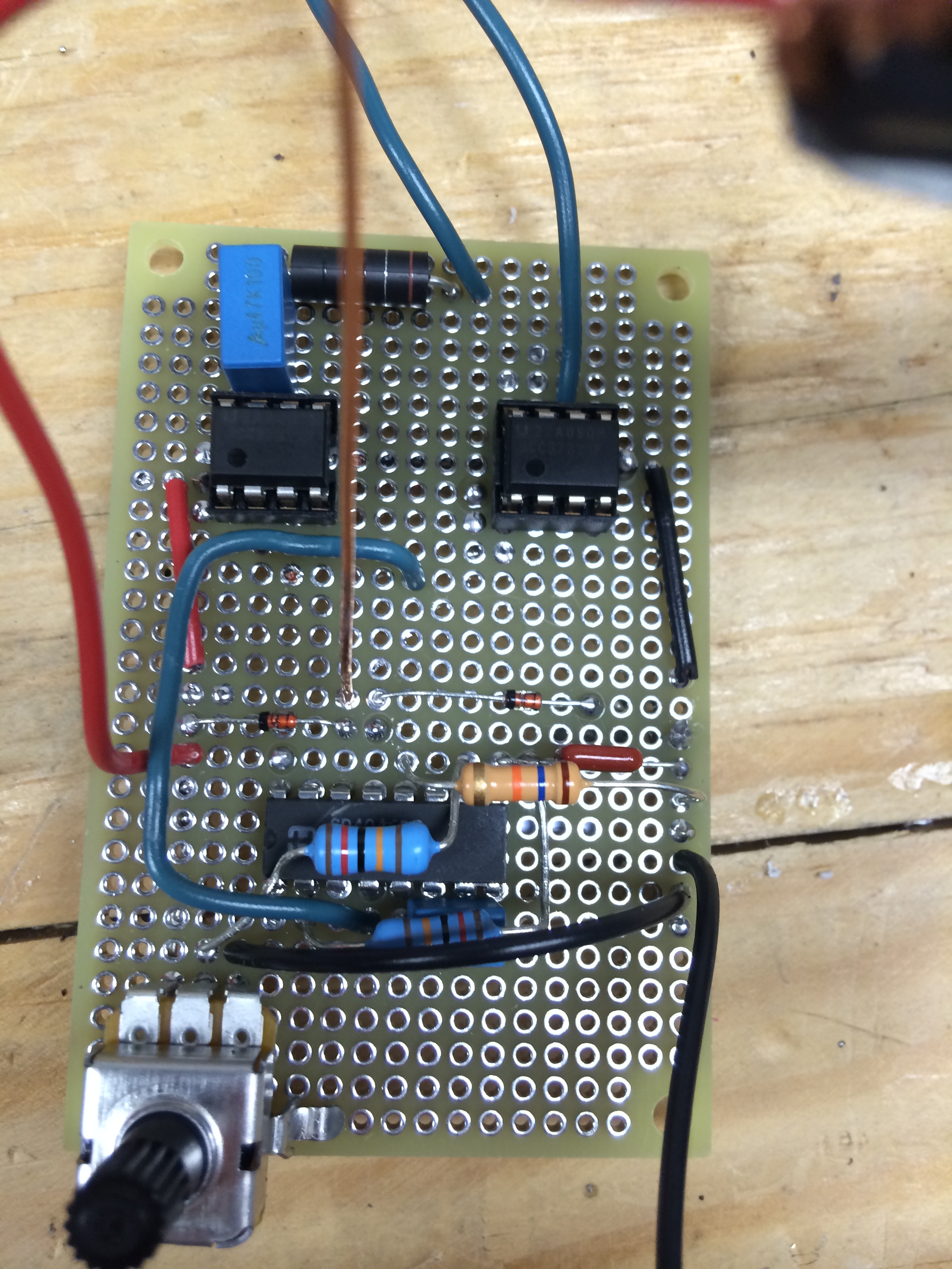

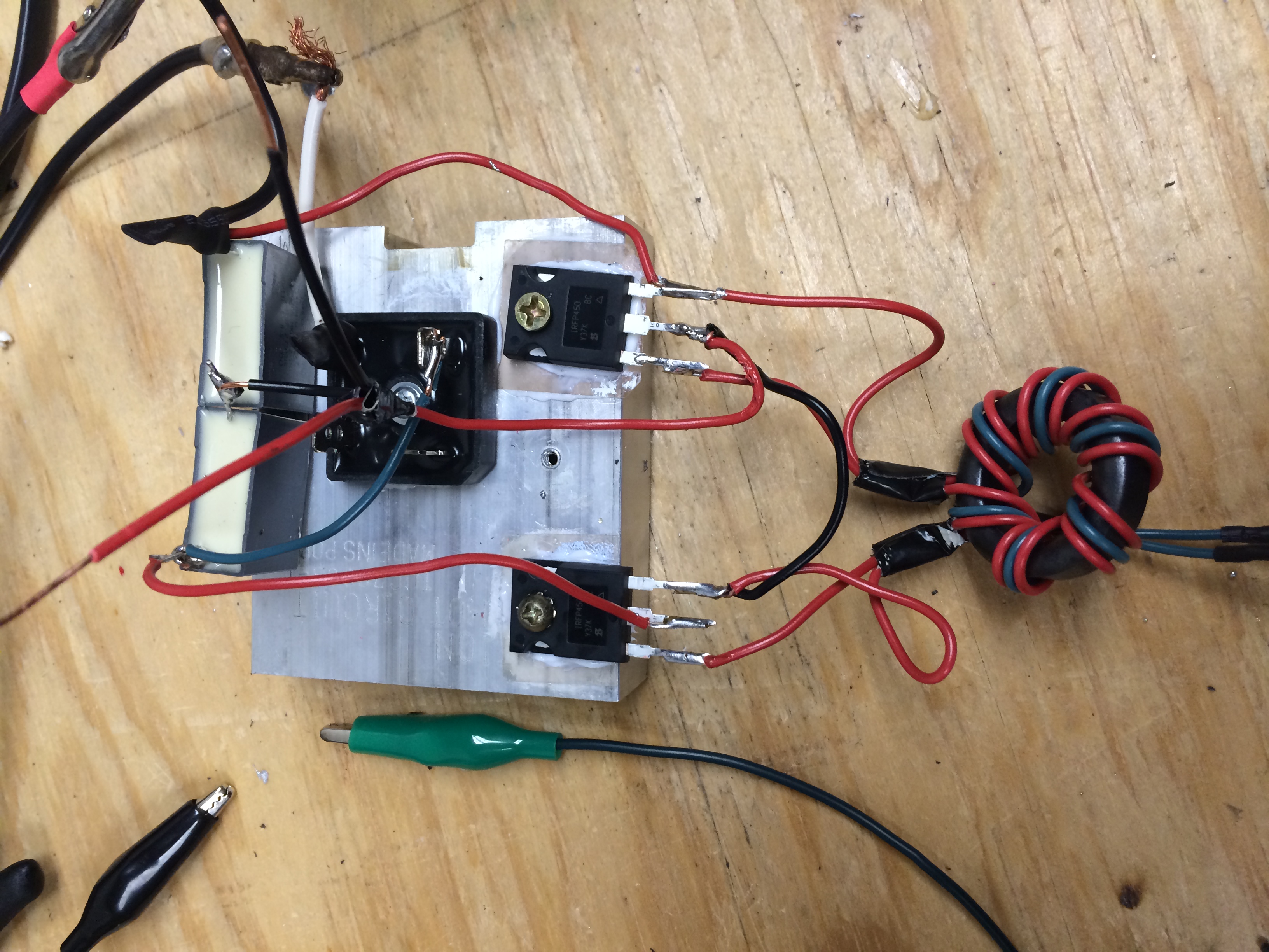

what are you referring to as the two primaries? Heres the pictures of the setup dont know why they are sideways

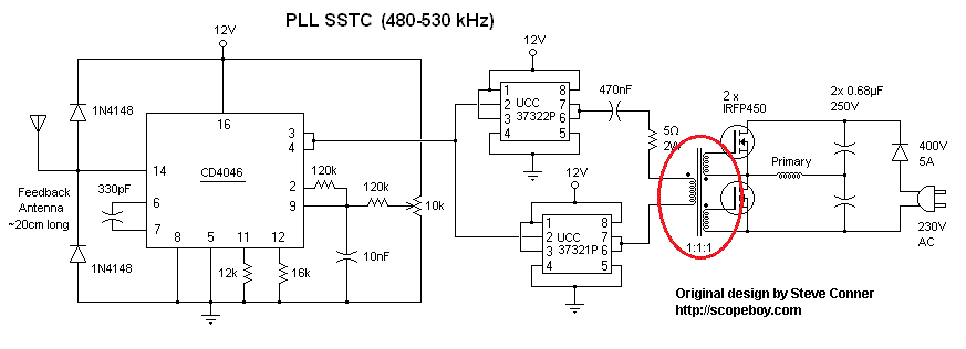

Sorry, they're not primaries. I mean the two coils on the GDT, circled in the image below:
You should make sure you have the phases correct, the two coils on the right should be 180° out of phase with each other (note the phase indicator dots).
Thanks for the photos. However I'd like to see the rest of the setup (the coil itself and everything on the mains side of the FETs) if it's not too much trouble.

I have made roughly the same SSTC in a few configurations. The schematic you are using is likely to continue to blow the MOSFETs. Look at the protection and clamping diodes in this similar circuit:
https://www.angelfire.com/electronic/cwillis/fetcoil2.html and noted here as well: https://www.richieburnett.co.uk/sstc02.gif
As DerS. noted the primary windings of the coil itself need to wired properly. And the tuning is key. I have found that the primary tank circuit is not critical at all in the SSTC design, it is all about the self resonance of the secondary coil. Measure this with a scope and signal generator then preset your drive oscillator for that frequency and make only small changes to that.
The other thing to keep in mind is that a tower Tesla coil radiates a lot of energy into the air, and if that couples back to your drive circuit, then you will blow the MOSFETs and usually a few of the protection diodes. So shielding and short run traces are key. It is easiest to build a horizontal TC with point to point arc contacts first.

Thanks DerStrom! you where right the GDT coils where not reversed! fixing that allowed me to get a very small output. Heres a video showing the complete setup, i also have two other coils, one very tiny and one skinny and really tall. i have some questions in my video, heres the link (
