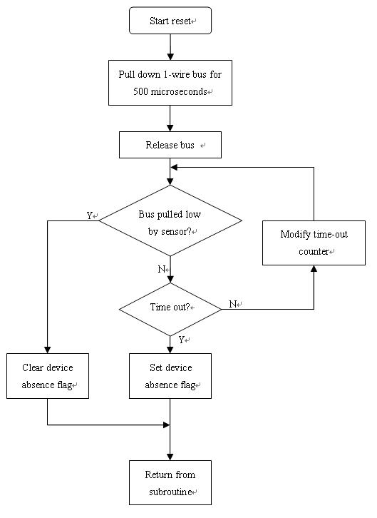

I've never been into MSP430,but I've used 18B20 with 89S5x.It's quite simple to initialize the sensor.I have the flowchart of the procedure of my subroutine in the attachment.You may refer to it.
