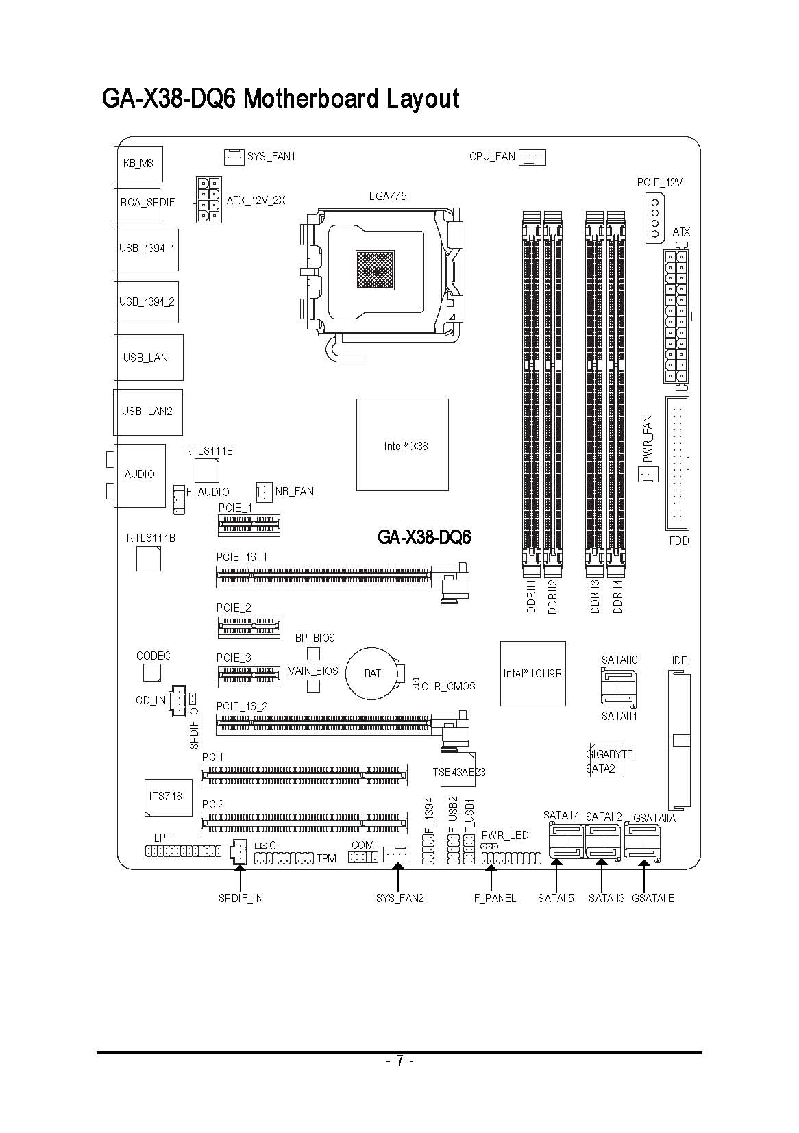

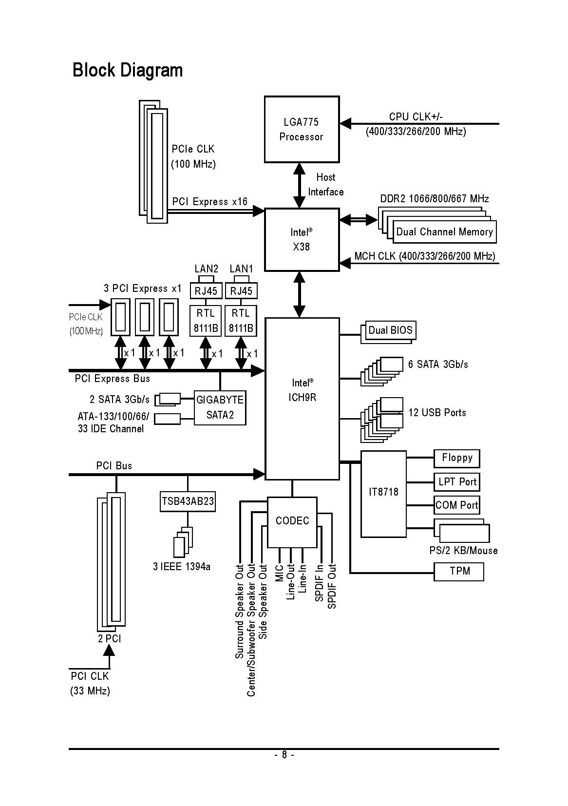

There is an additional GIGABYTE SATA2 chip (Image) for 2 extra SATA ports, in addition to the 6 provided by the southbridge. See link above for full motherboard specifications.
Note that the component images above are only samples taken from other motherboards and may not be exactly the same on my motherboard.

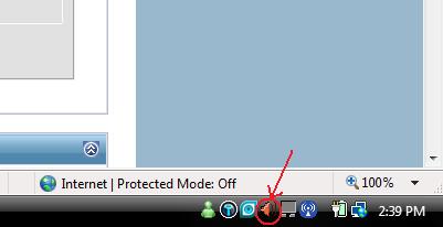

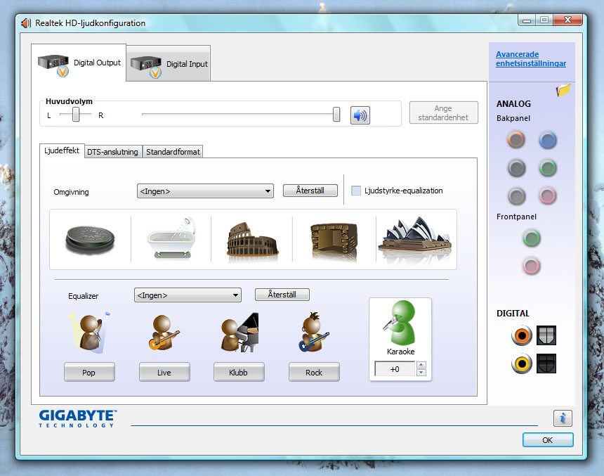

- The Realtek HD Audio Manager configuration utility **broken link removed** in the system tray (or notification area of the task bar) popped up a message saying something like "the device has been unplugged".
- Shortly after, Windows Vista showed an error message saying that Windows Shell Common Dll has stopped working. I forgot to click on the "view problem details" button to see more information and closed the message. But afterwards I went through the Windows logs and found exactly the error message information as quoted below (it's in Swedish - see Google translated English version).

Ever since this happened and the Realtek audio driver and the HD Audio Manager was installed, every time I open it (by double-clicking on it's system tray icon) only the tabs "Digital Output" and "Digital Input" were visible on the top of the program window, while the "Speaker", the "Line In" and the "Microphone" tabs were not (**broken link removed**, **broken link removed** - the first showing another persons Realtek window and what it should look like, and the second one showing what mine looks like).

- My first thoughts were that the problem was software related, so first I started off by reinstalled the Realtek R2.07 driver. No sound!
- Then I uninstalled the R2.07 driver first by using the uninstallation process from the Windows Control Panel, and then I fresh-installed it again. No sound!
- I downloaded a, back then newly released (2008-12-31), R2.13 version of the driver and installed it over the old one (the old is removed during installation process). No sound!
- I uninstalled the R2.13 driver by using the uninstallation process from the Windows Control Panel, and then I fresh-installed it again. No sound!
- I removed the R2.13 driver by using the Uninstall option from the right-click menu in the Device Manger. I chose to uninstall the Realtek device and remove the driver completely. Then I fresh installed it again. Still no sound!
- I uninstalled the R2.13 driver again by using the uninstall process from the Control Panel. Then I installed the R2.07 driver again. Still no sound!
- I restarted the PC, entered BIOS and verified that Azalia codec was enabled. It was already enabled. I disabled it, saved the settings, re-entered BIOS, and then re-enabled it again before entering Windows. Still no sound!
