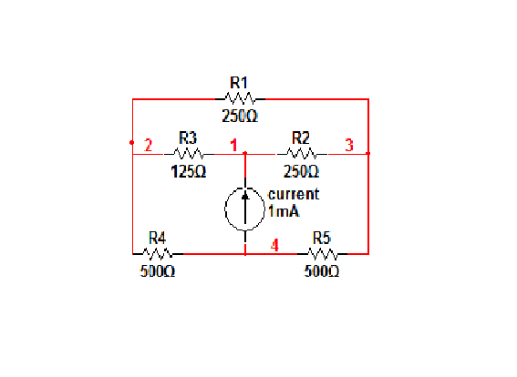

Hello guys,
I am trying to solve this circuit by finding out what the voltage across the R1 resistor is...
I cant seem to get the right answer (21.7mV)
Any help!
PS: we are supposed to use Nodal voltage Analysis

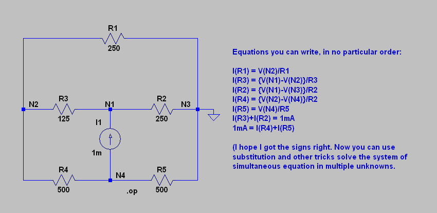

All that verbiage and musing above is not giving you the node equations you said are wanted. Can you make an attempt to write the node equations?
Ratch
Here is some guidance:
ps: I just noticed that V(N3) = 0.

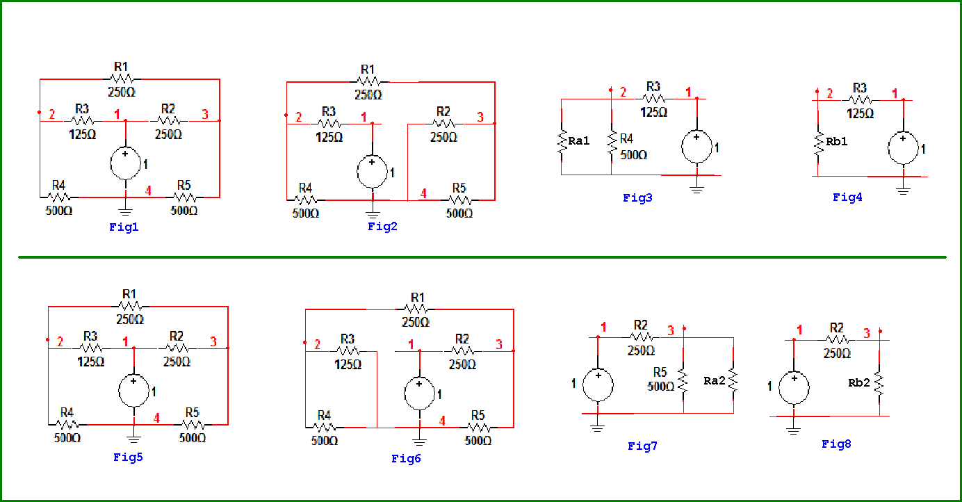

Hello there,
It always helps to look for symmetricalness in a circuit and in this circuit we find just that with R4 being equal to R5. This leads to quick simplifications. Since these simplifications are best shown graphically, i've included a diagram.
Referring to the diagram, in Fig 1 we have the original circuit. If we look carefully we can see that R1 is in parallel with two resistors R4 and R5 which are both the same values (500 ohms each). This means that if we were to divide R1 into two pieces R1a and R1b that were exactly one half the original value then the center tap would have the same potential as the center tap of the two 500 ohm resistors, and that means we can short the two center taps together and end up with the same circuit. This is the circuit shown in Fig 2.
Note that with this seemingly small transformation we have now greatly simplified the circuit, because now R1a is in parallel with R4 and R1b is in parallel with R5 and this means we can calculate a new value for both of these and reduce the circuit to four resistors This is shown in Fig 3.
Now we note that both sides of the circuit each have two resistors in series, so we can again simplify by calculating their combined series resistance on each side. This circuit is shown in Fig 4.
Finally we see that this circuit has been reduced to two branches where we can use simple current division to calculate the two branch currents.
Now knowing both branch currents we can refer back to the original circuit (Fig 5 with blue arrowheads showing the branch currents) and use simple Ohms Law to calculate the voltage across R3 and across R2, then subtract those two to get the final voltage across R1.
Note that if R4 and R5 where not the same we would have had to divide R1 up differently.

Thanks a LOT! I do find it a little hard to see how R1 is in parallel with R4 and R5, though I think if I look at it a little longer I shall get it. :)

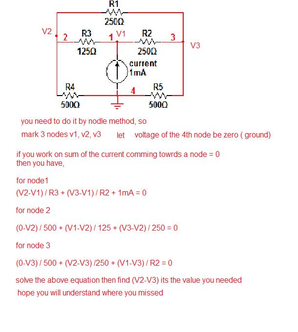

see the attached file, this is how you have to work to solve it using nodle method.

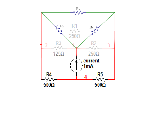

Convert to from triangle into star structure
Hi.
Also an easy method to solve this is to convert R1, R2 and R3 into an equivalent star resistor network.

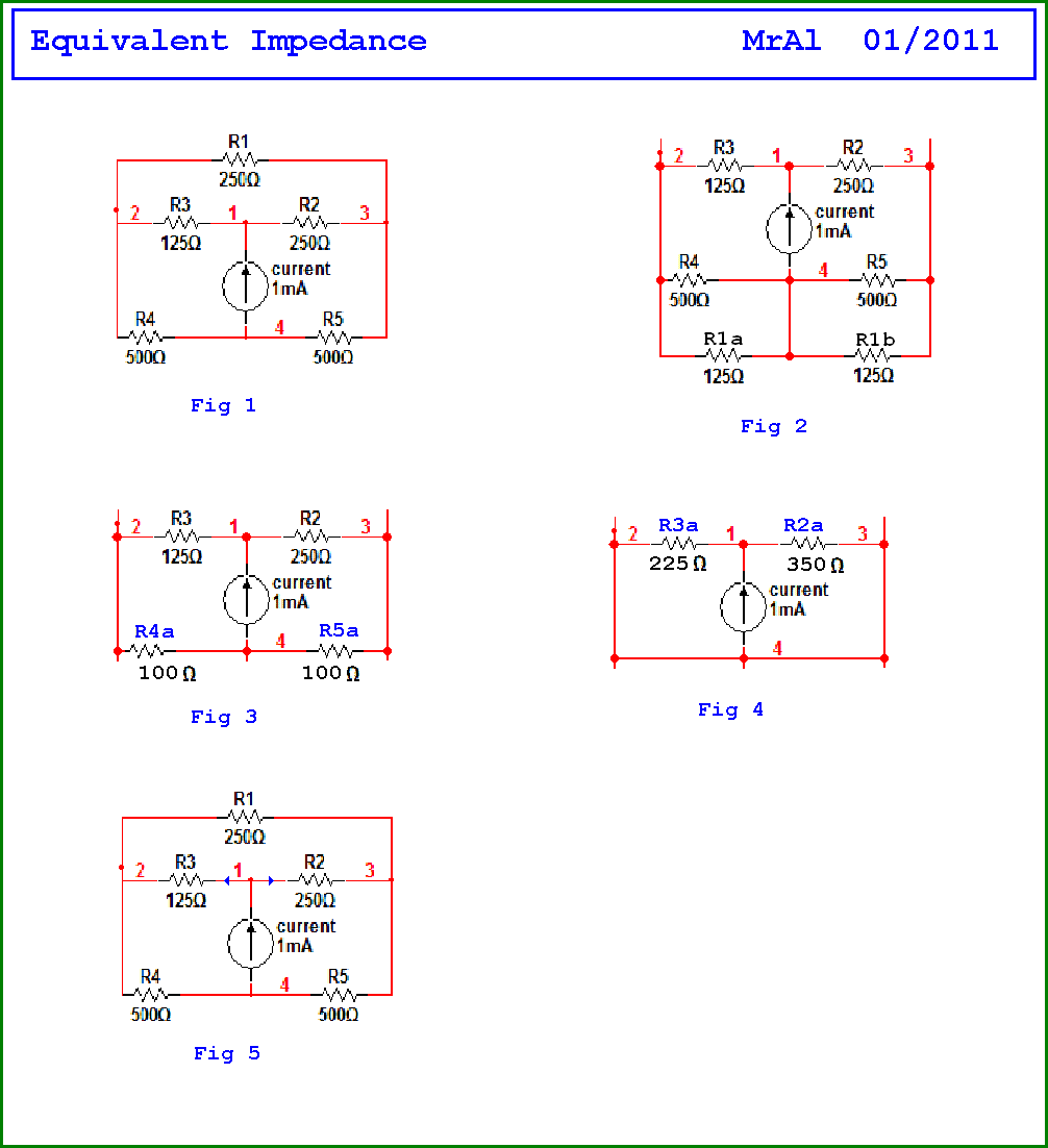

Hello Electrician,
Actually, this is a general topology transformation that works in any circuit and the reason i showed this example was because i wanted to show how we can sometimes simplify circuits by doing these kind of transformations. Note how with this circuit we never had to do any real network analysis, just simple calculations and simple graphical transformations. That's the beauty of it. There's another example right here on this forum where we did another network using ideas like this (topology transformations with equivalent impedances) but im not sure where it is now.
1) The WHOLE idea was to find that voltage and we of course keep this end goal in mind when we start out which means we know before hand that what we are doing is going in the right direction. That's part of what network simplification is all about. We dont simplify if it's not going to produce the required result, that's obvious, but sometimes we can find an intermediate result which aids in the determination of the end result. For example, sometimes we calculate the parallel resistance of two resistors even though in the end we need to know the current through only one of those resistors. Two resistors in parallel with another resistor in series with those two would mean we would first want to calculate the parallel resistance in order to find the total current. Once we find the total current we could then use current division to calculate the individual currents. There we had to modify the topology first too (three resistors into two resistors) although we dont usually think of it that way. Once done, we get information that leads to the answer we really are seeking.
2)Sometimes it's possible to allow a change just to get some intermediate result which helps in the end result as in #1 above with the parallel resistors.
3)Actually, if you note my last sentence in my previous post, you'll see that i noted that we might have to choose the two resistors differently according to the ratio of the other two resistors. In other words, we dont depend on the happenstance of the voltage between the two new resistors, we FORCE that voltage to ALWAYS be the same as the other node so that we can ALWAYS short the two. That's part of the method. In other words we have to impose the constraints:
A) R1=R1a+R1b (to satisfy the impedance requirement)
and
B) R4/R1a=R5/R1b, the ratios of the two pairs of resistors have to be the same (to satisfy the node voltage requirement).
With the resistors shown, we satisfy both of these conditions so the new network is equivalent and thus simplifies the math greatly. For another example, if R1 was 1800 ohms and R4 was 500 ohms and R5 was 400 ohms we would have had to spit R1 up into 1000 ohms and 800 ohms instead.
Taking both constraints into account we end up with the following formula for R1a:
R1a=(R1*R4)/(R5+R4)
and then R1b=R1-R1a of course.
This isnt the only kind of topology transformation that comes up in network analysis though, see also the more commonly known delta to wye and wye to delta transformations here:
https://en.wikipedia.org/wiki/Y-%CE%94_transform
Note that we end up with some pretty drastic changes sometimes but the resulting sub circuit still acts the same way.

Hello again,
Ok i see what you are getting at now. The source has to be a current source or else we can not meet the requirements for the node. The question was for a current source though, so we did get it right.
However, given a voltage source then we would have an entirely different circuit which we could approach using different transformations that do lead to a valid solution (see attached diagram).
Transforming the circuit from Fig1 to Fig4 in the diagram, again simply combining various resistances we end up with a simple voltage divider circuit where we can easily calculate the partial voltage at node 2. Now knowing this voltage, we can backtrack and calculate the partial voltage for node 3. Then, transforming the same circuit from Fig 5 to Fig 8 we can again end up with a simple voltage divider to calculate the other partial voltage for node 3 and again backtrack and calculate the other partial voltage for node 2. We then have two partial voltages for each of the nodes 2 and 3.
The voltage for node 2 is then the sum of partials for node 2, and the voltage for node 3 is then the sum of partials for node 3. Knowing these two again we can subtract and get the voltage across R1.
I guess i find these kinds of circuit transformation very interesting because they simplify the math. It's not usually too hard to transform the circuit but i guess it could get tricky.
