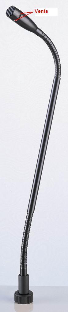

I have a pretty good quality Audio Technica gooseneck mic connected to my computer to measure speaker response. It is electret type and gets its tiny amount of power from my sound card. Its active end is a little bigger than the end of a pencil. Maybe it is what you call a "boom" mic.
A noise-cancelling mic doesn't have filters. If you hear noise, a filter would also filter desireable sounds except if the desireable sound is narrowband like a telephone then filtering out the low and high frequencies might reduce some noise.
Many mics are omni-directional and pickup sound (and noise) all around.
Other mics are uni-directional, also called cardioid and hyper-cardioid and pickup sound very well on axis, a little less to the sides and much less to the rear. They cost a little more and are probably called "noise-cancelling". Because of the long wavelengths of sound, their directionality isn't perfect, being much poorer at low frequencies. They work by using vents mounted on their sides which are ducted to the rear of the diaphram.
Very expensive noise-cancelling mics use 3 uni-directional mics, two at the sides connected out-of-phase with the one at the front. With noise surrounding them, they are very quiet. But when they pickup voices or music from the front, it sounds odd because some desired frequencies are cancelled.
