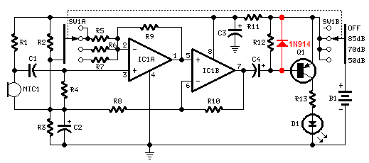

Is it this circuit? I think it is missing a diode. Room Noise Detector - RED - Page16

its the same as the circuit I simulated but since I couldn't get a 2 poles 4 ways rotary switch in multisim, I decided to make do with a DIP switch coupled with a bus bar (I don't even know how the busbar operates it is just lying there fallow...except I constructed the bus bar wrongly-would not mind also being helped in this area too :) ).
Using the signal generator at the input, I guess I was meant to have a dB reading at the bus bar output...Im really confused there cause I am not getting that. How am I to incorporate the dB meter with a bus bar...Im not also sure if I constructed the bus bar correctly, here's an attachment of my circuit with multisim.

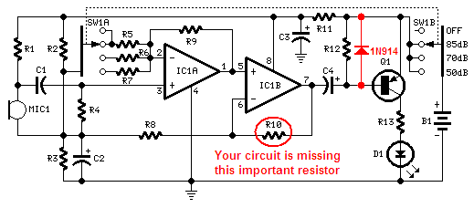

There is no "buss bar" in the switch. It is a simple two poles 4 positions switch.
Your second opamp has no gain because you have R10 in the wrong position.
