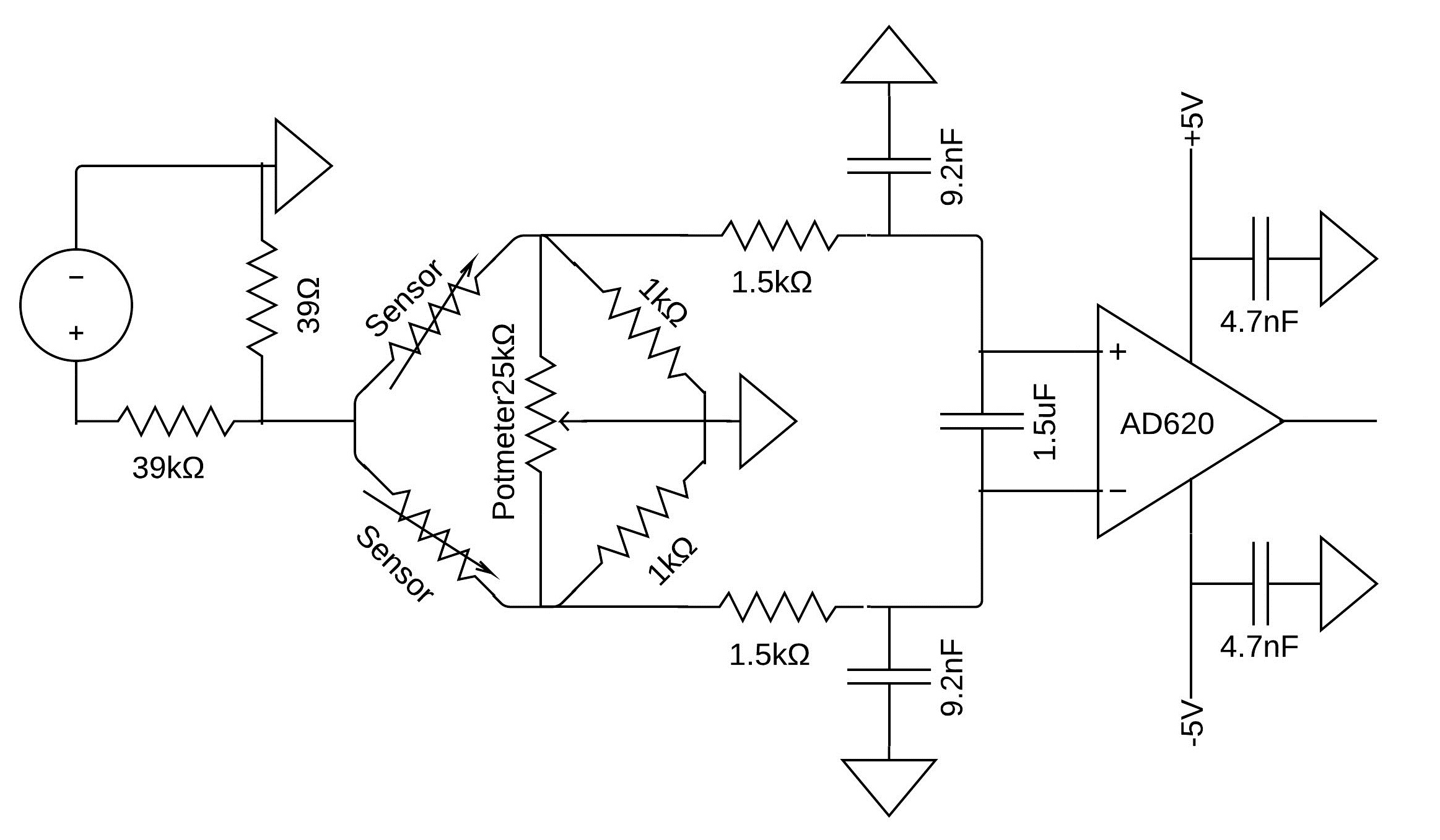

HI. Im designing a temperature sensor circuit to measure the heated effect of a silicon photo diode. For the temperature sensors i've used two thermistors, attaching one of them to the backside of a silicon photo diode and the other as a reference sensor on a piece of copper. By illuminating the diode with a laser, the change in resistance in the thermistor will provide a voltage drop different from the reference thermistor. To amplify the difference i've used an instrumentation amplifier (AD620) wtih a gain about 225. But im having noise issues. Any idea where it origins from? The circuit is inside an aluminium box. And input voltage is 5V.

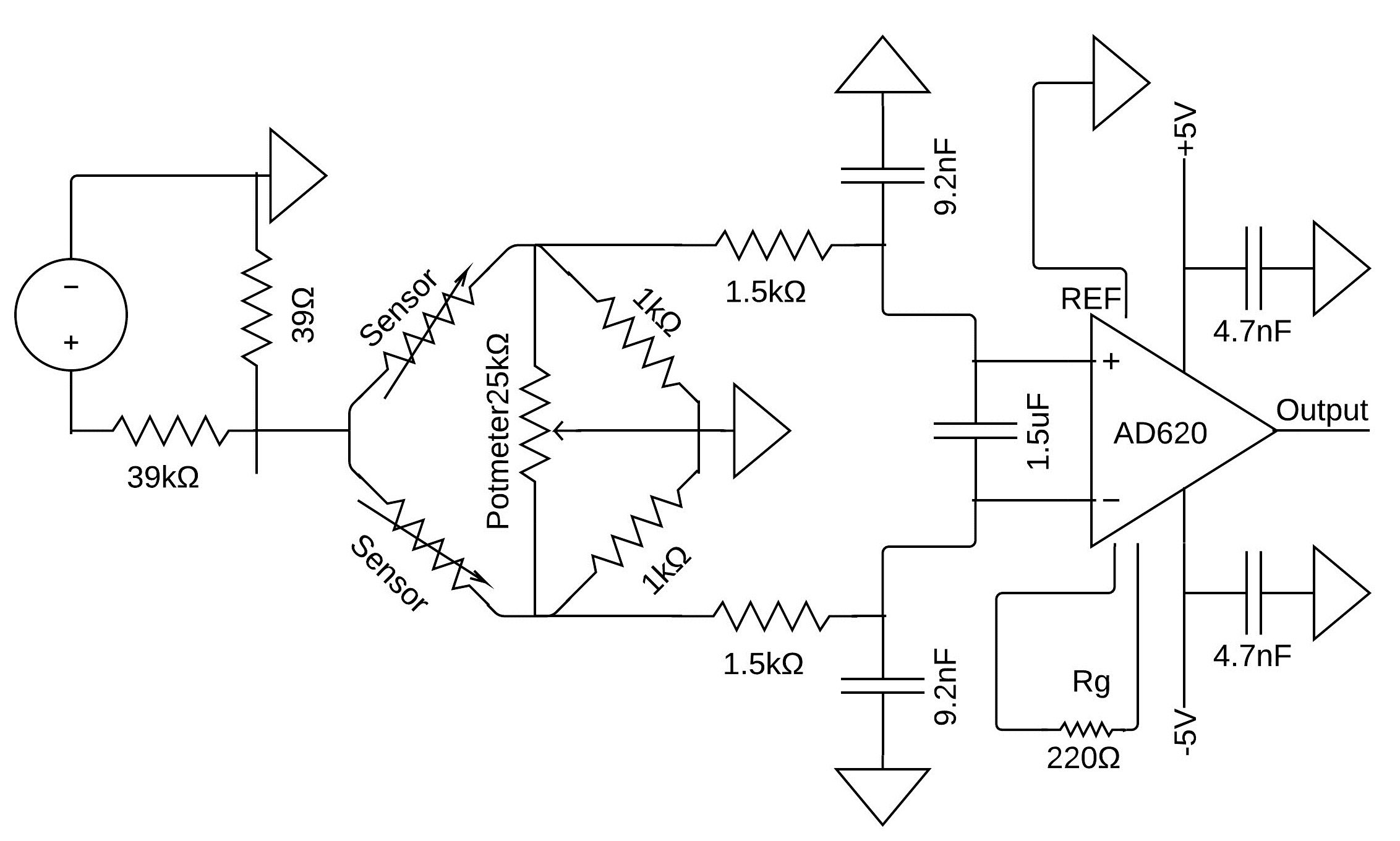

Sorry. My sketch was a bit unclear. But i do use a positive and negative supply. The gain resistor is 220 ohms and the ref pin is grounded.

Can you take a snapshot!! Are you using a scope or just a multimeter.. How much noise is in the circuit... Pots are notorious for noise, try a multiturn trim pot...
Without seeing the noise it's hard to comment!
Does the noise have a main's frequency component or other specific frequency, or is it hash (white noise).
