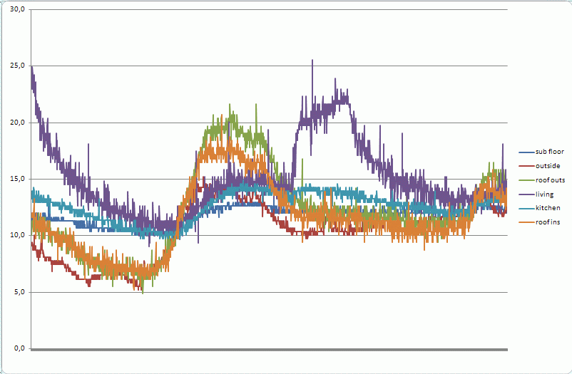

Howdy,
I do some temperature logging with LM35s, hanging on cables with various lengths. AD-conversion is done with Logomatic. I put an RC filter in as recommended in the LM35 datasheet and the logomatic gets external 3.3V supplied, was too whacky before. What else can I do?

What resolution is the A2D convertor.?
Do you have any filtering on the output of the A2D.?
I would temporarily replace the LM35 with a two-resistor voltage divider fed with the same 3.3V supply you are using for the LM35, and log that for a few hours. See if the noise is still present. If it is, you need a better 3.3V supply or better shielding...
Is there no way to use a digitally reporting sensor like an LM75, or something else that reports over SPI or I2C?
12 bit. Amounts to 3 bit per centigrade. 10mV per Centigrade, 3.3V reference, 1023 bit.
at the output? Logomatic is done by www.sparkfun.com, so no idea about their filtering. Just wired in the sensors and a few Ls and CS and an LM1117 incl LC filter for the 3.3 V. Normally Logomatic generates 3.3 V on board, did not work all too well. So Excel would do the filtering....

When testing the divider, what caused the voltage to sag off? I would have expected a straight horizontal line with just whatever noise superimposed on it?
I think I'm just seeing +-1 LSB of noise, which is usual for an ADC. Re-do it at the end of your cable.
When you get the data to a PC, read it into Excel, and use the scatter plot to display it. Add a "running-average" trendline, which lets you specify a running sum over enough data points to get rid of the random variations.

btw, looking at the multiple traces, there is high correlation between the noise in adjacent channels, meaning that the noise is either in the power supply, or the cabling.
Two years ago I interfaced some LM335's (used as temperature sensors) into a multichannel datalogger to measure and record temperature. The LM335's were at the end of 100 foot cables. Had a similar noise problem on all temperature channels. The temperature recordings were done in a home, not industrial, setting.
I tried trying adding additional filtering to all the supply voltages which didn't help. In my case, the solution was using twisted shielded pair cable. The drain wire (shield) was tied to common (ground) only on the datalogger interface. The drain wire at the LM335's were not connected to anything. Thus, there was no current flow in the shield.

>reg correlation in noise:
filtered only noise (difference between one pint and the next), if there was a correlation, all the graphs would be parallel?
Its 1300 or so measurments, about 21hrs then, if there are some peaks could be changes in temperature as well. Windy day, weatherboard house. The peak in the first third would be half an hour or so.
The other graph from 11.51AM, these sensors been 1cm apart, if I remember right, one got RC filter, the other didnt, but would not have much of a difference, just 10-20cm wire do the ADC. Anyhow, may as well try the voltage divider bit.

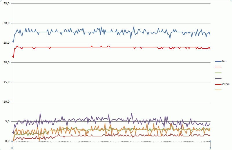

Have you carried out the Vref test as suggested by MikeM.?
Use a 2.2K and 3k3 resistor in series, connect one end to the +3.3V and the other to 0v.
Make two of these dividers, connect one at the remote end of the cable and one close the the Logomatic.
Disconnect the LM35's.
Note: reverse the connection of one of the dividers so that you end up with two different test voltages.
The junction to the ADC1 input, should be approx +1.32V and ADC2 approx 1.98V. Doing it this way will displace the two 'test' temperature plots.
Run and log for a few minutes, post the results.:)

strange, both would be around 36°C (360mV), so why did the logomatic trail off, the temperature readings are next to zero. (left the LM35s connected).
put 2.2k/91 Ohm onto the 9V supply. One set of Rs was on a 20cm cable, the other on about 6m or so.
zooming in into the normal logging does not look that much different (200 readings.gif), 36hrs.gif, well, 2100 or so readings...

The left hand image is the plot for two resistor dividers.??
It indicates that the 'noise' is being picked up along the long cable run.
I would suggest a screened twisted pair, use the screen as the 0V connection.
Decouple the LM35 supply at the remote end, close to the LM35.
Follow the LM35 datasheet recommendations for long cable runs.
I would say the 'close' LM35 plot is within the spec of the LM35.
Ideally I would collect a number of samples, say 10 and average these within the program to give a plot value.
A rolling average could be calculated from a ring buffer of the samples, but for simple home use an average of the last 10 samples would be OK.
