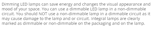

Supposing I have a mains LED lightbulb which is not meant to be dimmable.
Now suppose I accidentally connect a triac dimmer to it.
Will the constant "smashing" on and off of the mains by the triac switching repeatedly over-excite the LED bulb's EMI filter such that it fails prematurely?

I searched on this exact question,"do dimmers damage non-dimmable LED bulbs. Lost of hits. Everyone of them that commented on triac-type dimmers , including manufacturers, say they can be damaged. Here's one example (https://www.integral-led.com/education/dimmable-and-non-dimmable-led-lamps) :

For LED and CF bulbs there are many different ways to design them. The early designs often used a full wave rectifier and filter cap off the power line. This type of filtering only draws power at the peak of the cycle. Because only 15% of the time the bulb is drawing current.....duty cycle dimming is not very effective. AND Many of the power supply ICs do not function for 100mS after the power is applied. This soft start or start delay gets triggered at low duty cycle settings.
It is very possible to have the power line off for 50% of the time and the bulb pull the same power as at 100%. (same brightness)
Thanks, BTW, we are bringing to market a new type of LED lightbulb dimmer which will sweep the world!
So how long until you start a thread here arguing about some almost irrelevant design in order to get us to design an actual functional working circuit for your job and company that you can present to your boss as your own design? :rolleyes:
I can't find the patent now but...........
There are some designs where the IC watches the power line on a separate pin. If a triac is detected....(the power line drops to zero volts when it normally should not be zero)....the IC shuts off the LED for the time the triac is off. The power filter gets it power as described in my last post. The LED is enabled/disabled along with the triac.
The problem is that the LED bulb needs a load on the power line other than its self. When a triac opens up the power line, with out a load, the voltage does not drop instantly. There is capacitance on the power line that keep the voltage from dropping. When the voltage does not drop to zero the IC can not detect the turn off of the triac and does not turn off the LED for part of the cycle. There have been a number of papers written discribing LED and CF bulbs need one incandescent bulb in parallel to dim correctly.
Disclaimer: All this is dependent on what type of dimmer and what type of rectifier filter in the bulb.
