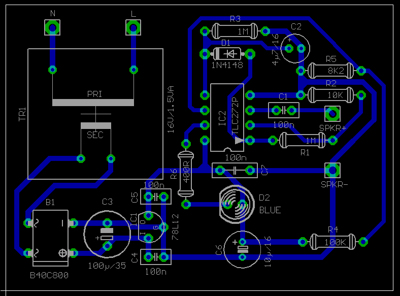

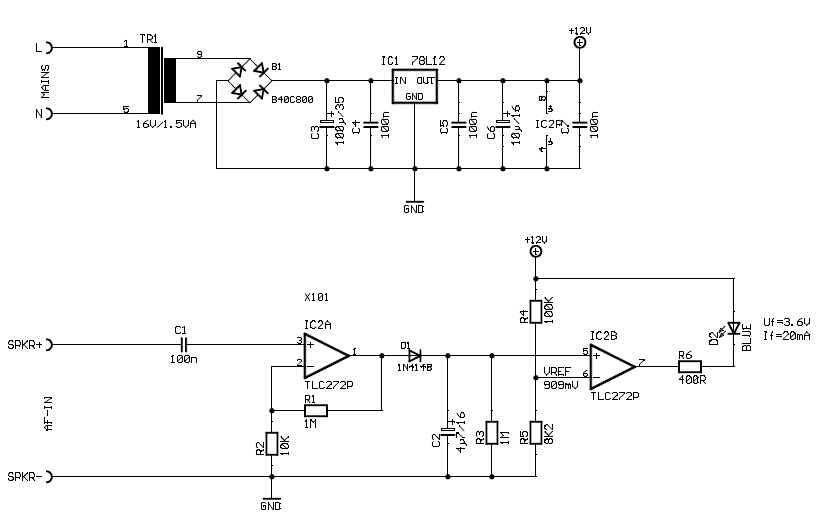

Hi Captain Colorado,
here is a circuit which might suit your needs.
Brief circuit description:
AF enters the amplifier (IC2A) via C1 (AC-coupling). There it is amplified by the factor of 101 (1+R1/R2). So the weakest input voltage of 10mV will be amplified to 1.010V.
The amplified signal is then rectified (D1) and fed into a comparator. C2 and R3 hold the signal for a short time while the input signal might be lost.
The comparator output swings high if the amplified signal is over the reference voltage of 909mV (voltage divider R4/R5)
For a blue LED you might use a 470Ω resistor (instead of 400Ω) for current limiting. 400Ω result in almost 20mA LED forward current.
The PCB design is purely single sided and measures 2.5750X1.9".
Boncuk

Your design budget and timeframe is way under though!
E
Oops!
Where do you normally purchase electronic components?
Without the transformer the part costs are below US$5.
Boncuk

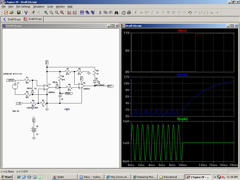

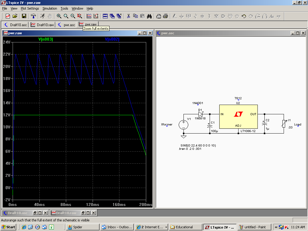

Here is a radio shack version of Boncuk's circuit. You shouldn't loose to much money if you run right down there. :+)

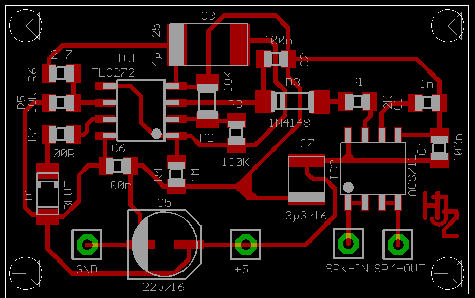

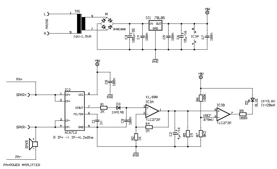

here are the parameters of my problem.
I am selling a sound masking system to a govt contractor. We are trying to make a SCIF room(Security Campartmented Information Facility) that is audibly secure. There are specifications for the walls to make them sound resistant but not sound proof. To lower the cost of sound proofing we add sound masking(random sound in the human voice spectrum).
Inside the room will be the sound masking system consisting of multiple 5w amplifiers, hung in the ceiling above the ceiling tile and next to the walls. Each amp can feed 2 speakers, the speakers will be outside the room.
I like the idea of a high frequency output to the speaker and listening for it on the other end. Both the HF source and the blue LED will be inside the SCIF.
If my cost has to go up then so be it, better to buy a BMW that works than a Yugo that doesn't.
The problem is the extremely low AF voltage which has to be made visible using an LED.
10mV equivalent DC voltage on a 16Ω load generate a current of 625µA.
The second problem is the fact that the sensing circuit is not supposed to reduce loudspeaker volume.
I doubt you'll be able to find a current transformer for that kind of extremely low power.

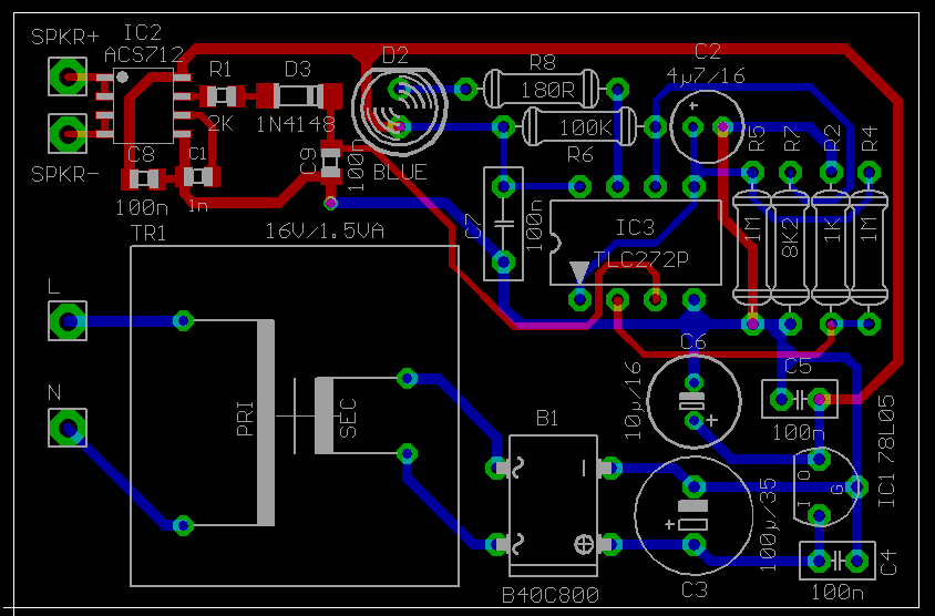

Here is another approach using a current sensor ACS712 from Allegro micro. It puts out 66 to 185mV per Ampere, which is pretty high for your application, but it should work with high amplification after the sensor circuit.
I used the sensor with the foregoing design with some modifications.
The sensor is connected in series with the loudspeaker. It has an internal resistance of 1.2mΩ which should not affect loudspeaker performance. The output is connected to an amplifier with an amplification ratio of 1,000 : 1.
The remaining circuit is unchanged with the exception of the LED current limiting resistor (now 180Ω) since the supply voltage had to be reduced to suit the ACS712 for a VCC of +5V.
Here are the altered schematic and PCB design. PCB dimensions are: 2.3815X1.56875".
If an amplification factor of 1,000 : 1 won't suffice you could use an instrumentation amplifier with a factor of 10,000 : 1. This of course will increase the cost for the circuit considerably.
Boncuk

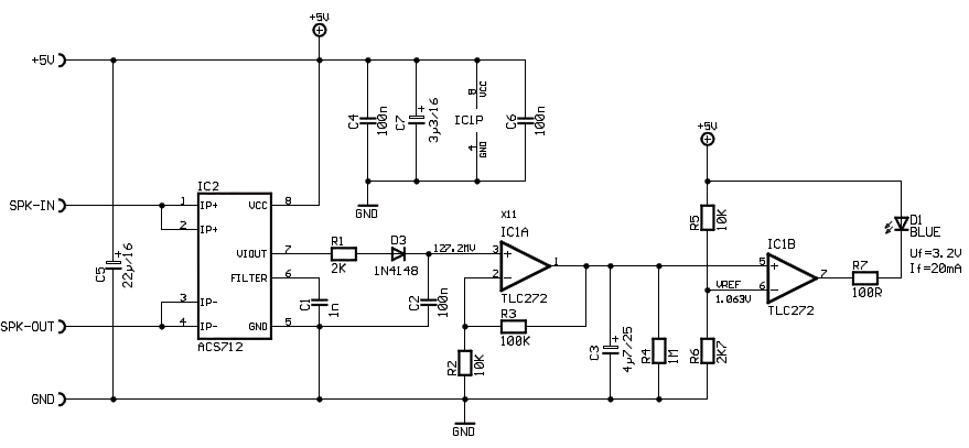

Boncok,
thanks for all your help.
I should say that the value of 10mV will probably never be used.
the settings for the system when tuned to the sound masking specification for the job will almost always(98% of the time) be 100mV or higher.
I expect that normal settings will produce at least 200mV 80% of the time.
Can we add or change the value of a cap to hold 200mV for 1-2 seconds?
will the top end of 11V cause any problems for the circuit?
CC
P.S. - the transformer will be external to the gang boxes and one transformer will supply power for all the circuits. No need to place the transformer on the board.
the ACS712 is designed to measure AC and DC currents of ±5A. 100mV at its input won't do any harm to the chip since it can also measure mains currents.
Additionally the minimum isolation voltage is 2.1KV(RMS) between pins 1 to 4 and 5 to 8.
With the speakers almost supplied with maximum power the chip should generate a usable output voltage.
C3 (4.7µF) together with R4 (1MΩ) should hold the signal for one to two seconds. If the time period is too short you might use 2.2 or 4.7MΩ for R4.
This design is purely SMD and also purely single sided.
The supply voltage should be well filtered and stabilized for +5V.
PBC dimensions are: 1.39X0.87"
If you wish to use this design please PM me your email address for the Eagle files and a BOM.
Boncuk
