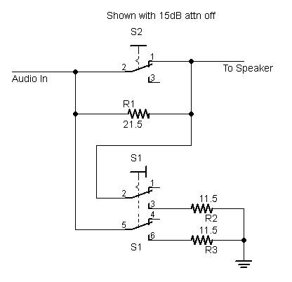

I need to amplify an existing sound by precisely15 decibels. I am unsure as to what type of device I need to do this. The existing sound will vary in intensity from 0 decibels up to about 60, but at any point in this range I need to be able to bump it 15 decibels higher than the existing setting.
Could any of you provide any assistance in what I would need to do this? The sound I am referring to would be just a buzzing sound or perhaps an electronic tone.
i am trying to do a demonstration for a class that I teach about hearing loss. I want to utilize a buzzer or tone-type sound hooked to a volume control, the be able to boost the volume precisely 15 decibels by pushing a button. Short version, a 15 decibel loss in hearing is considered significant for reporting purposes and I want to show the difference between the two.

I would like to do this without utilizing a computer; make it very portable and simple as possible. I was hoping that there was some type of resistor or capacitor that I could splice in between the volume control and the buzzer/mini speaker and use a single pole push button to intitialize. Also, you are absolutely correct that loss is not linear, it occurs and different frequencies at different rates, this is just a simple demo to show students and patients after I conduct their hearing tests and before we begin discussing hearing loss.
Two 50K logarithmic pots with one end to the audio signal, the other end to gnd and the wiper (middle) one to each side of a SPDT switch with the center pin going to the amp should work. Trick will be calibrating their levels.

Mike, the attenuator for 15 dB is fine, but when the switch is closed, the impedance will be far less than 8 ohms and will probably cause some attenuation.
The switch should be arranged so that when the attenuator is not wanted, it is not connected at all.
Yeah, I just realized that and deleted my erroneous post. Ya caught me before I could remove it :) Need to change the switch config. I posted correction in next post.
Okay, here is a 15dB attn. Assumes 8 ohm impedance.

A speaker is 8 ohms only at one frequency. It is about 40 ohms or more at resonance and since it is inductive then its impedance rises as the frequency rises.

Use an amplifier with voltage gain of 5.62 or power gain of 31.62 to obtain a 15 decibel increase.
