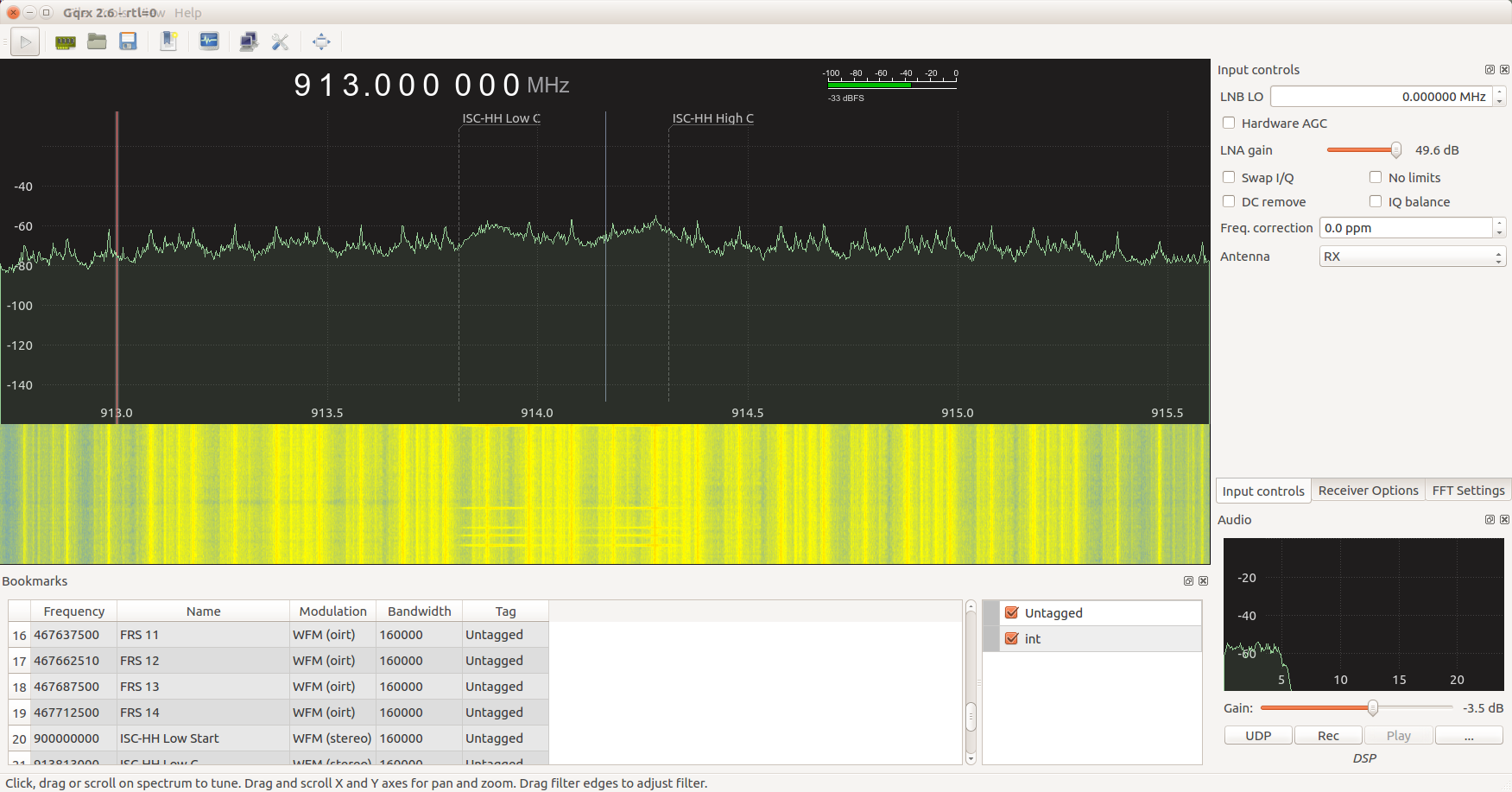

I volunteer at a local basketball club, and we use wireless shot clocks. some of the locations we use those clocks in, have a big problem with use/reliability.
I purchased an SDR and was able to identify why there is a problem, and I have some ideas on how to fix it, but I've never really done RF related projects so I'm not sure if I'm on the right track..
Details:
The hand-held transmitters are transmitting at 913.75 mhz
There is a "master" / "slave" relationship between the 2 clocks so they keep themselves in sync. (So 2 transmitters, and 2 receivers )
At one location with the SDR & GQRX , I was able to see what appears to be a "repeater" that operates from 907.5 to 923.0 and has some very distinctive patterns in the signals ( each repeating pattern is ~0.5mhz wide)
the manufacturer (who I was able to contact initially but has not really been much help since) said the remotes are channel hopping ( but I've seen no evidence of this in the spectrum of the signal it uses)

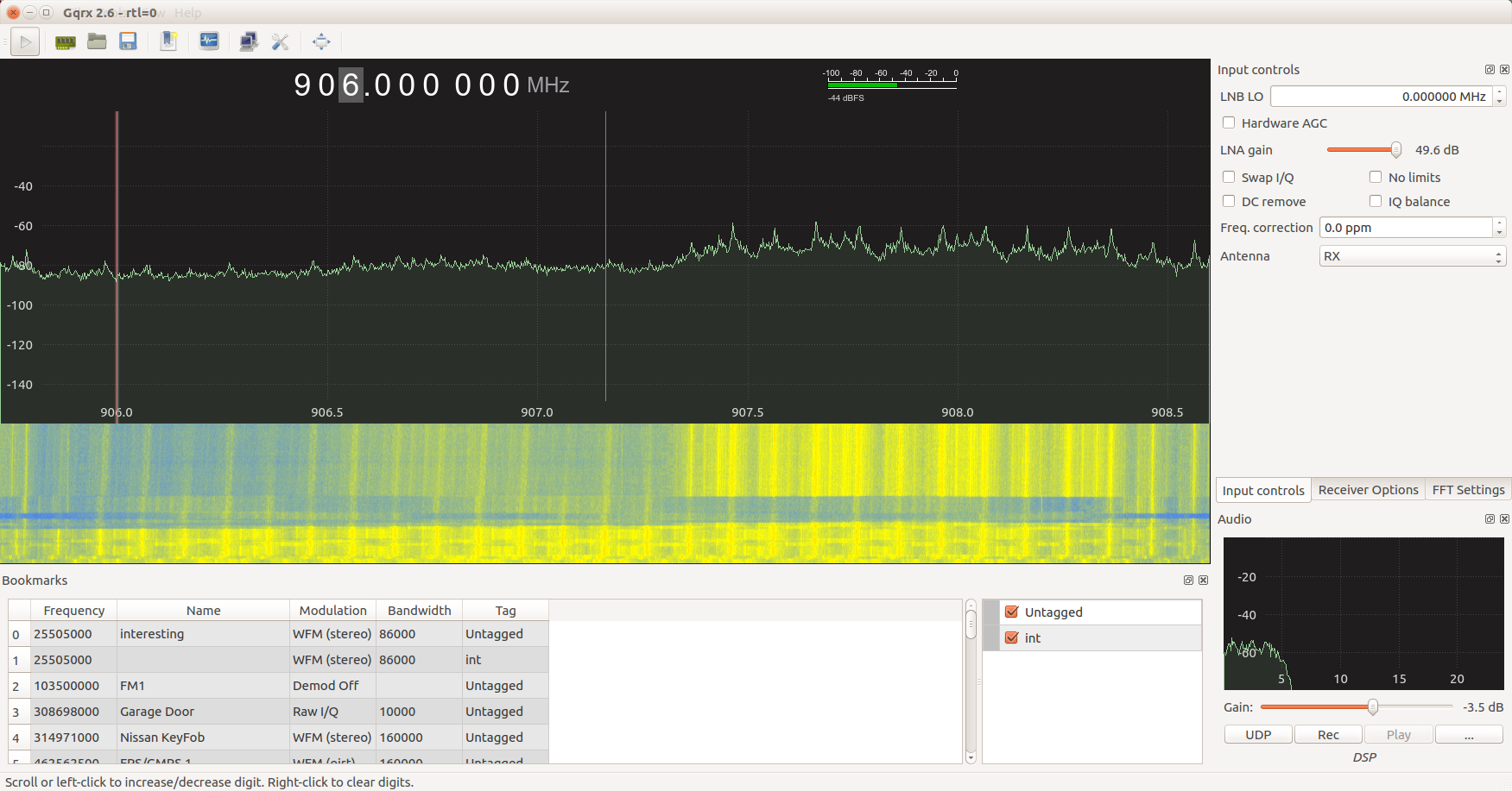

I suspect it's creating "noise" which is drowning out the signal. see attached gqrx screen cap

Looking at the waterfall and spectral display, I do not see what you think is the "repeater". Can you repeat the run with a wider bandwidth so we can see the "edges" of the spectrum attributable to the repeater? Ideally, catch a spectrum where one of your transmitters is active at the same time as the repeater.
I agree, Mike. The spectrum looks to me like it could well be a hopping device, but that depends on how slowly the spectrum was acquired and how fast the hopper operates. Most hoppers tend to look like direct sequence spread spectrum on an analyzer if they are hopping quickly, but slow hoppers, those that hop once every few hundred milliseconds are more confusing and look a bit of a mish mash depending on when you capture their spectrum. On the other hand, the spectrum also looks a bit like what you would see if the analyzer dongle front end or A/D converter was overloaded by a narrow or wide bandwidth signal, but hard to say.
The plot is from an FFT analyzer which means that maybe it is taking a pretty big slice of time, I can't tell from the screen shot.

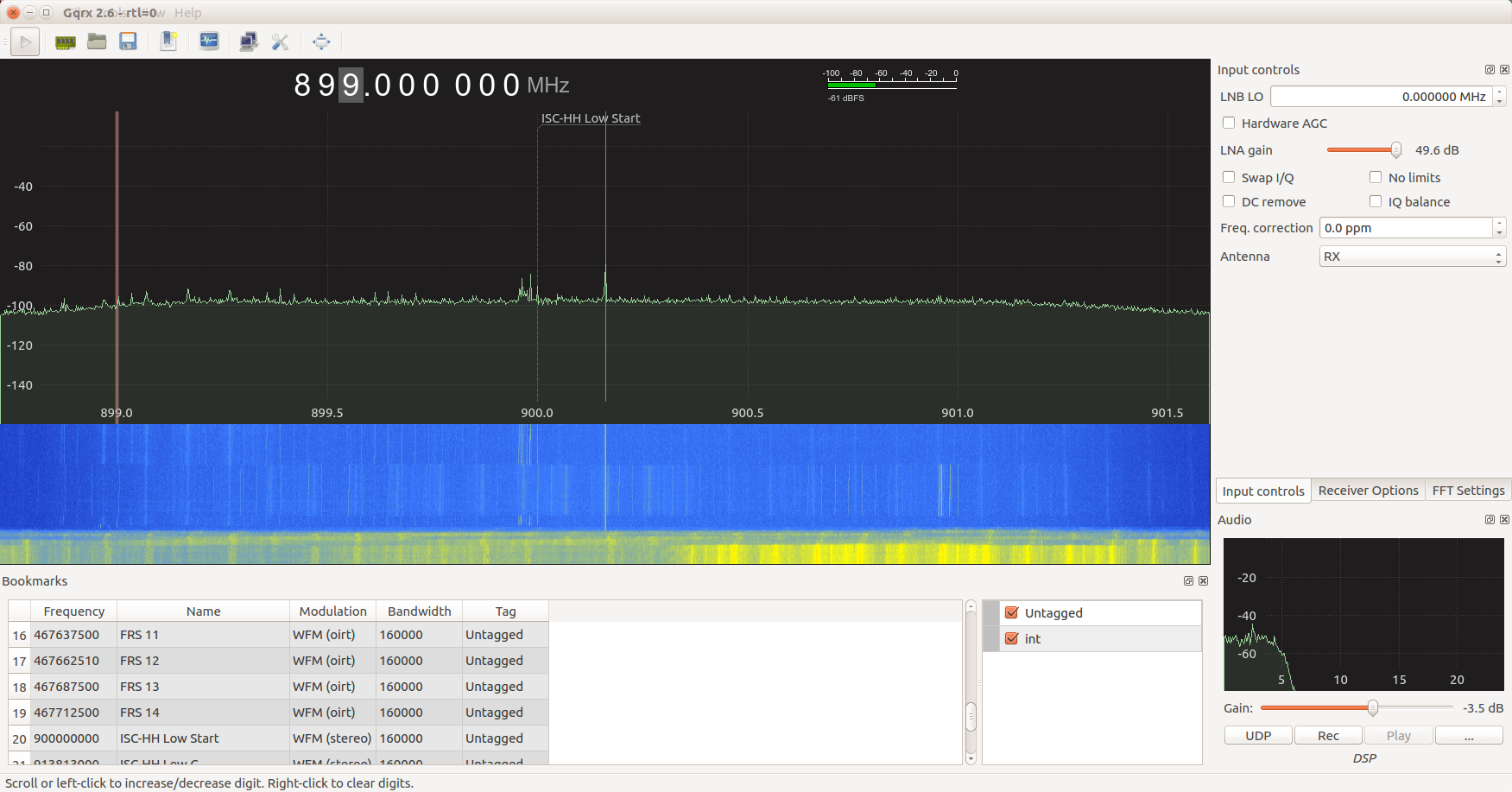

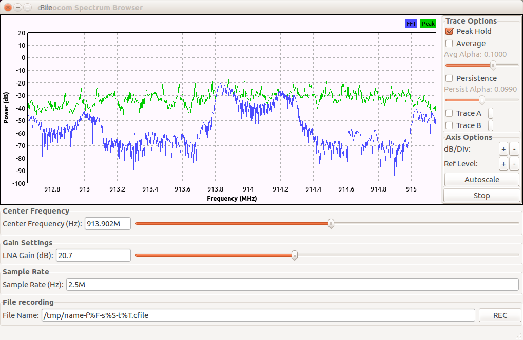

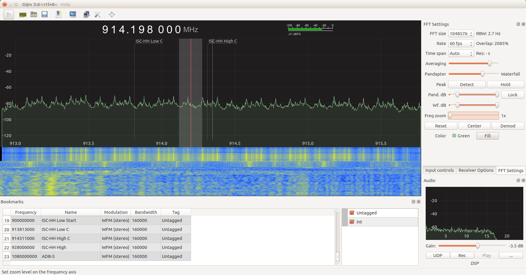

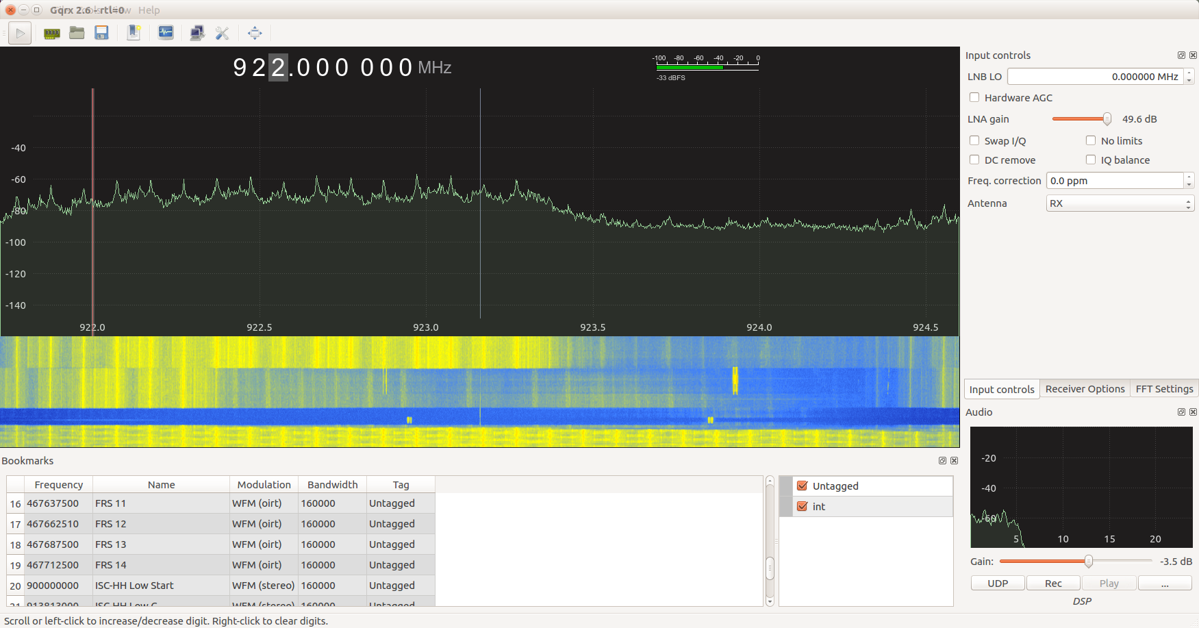

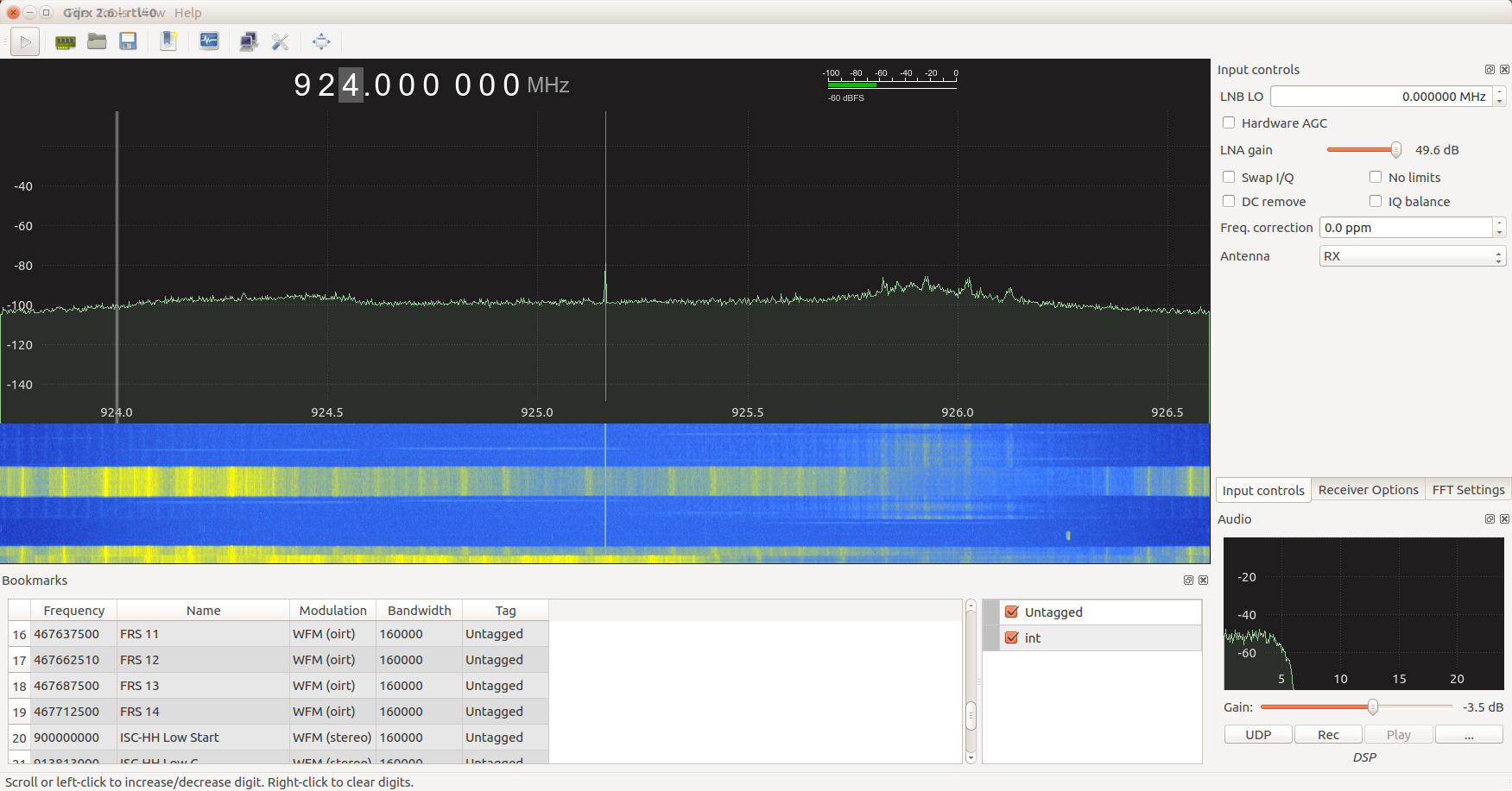

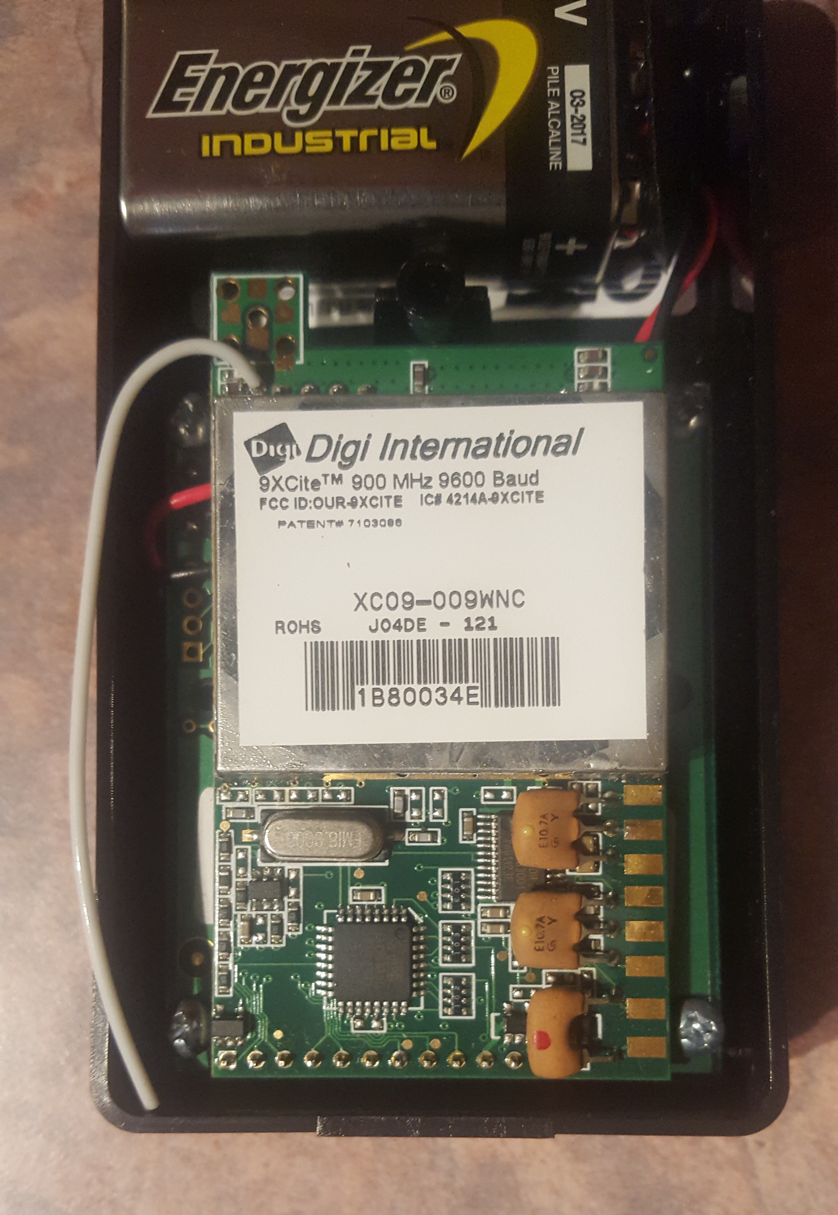

So a gold mine of info here.. I was able to get the shotclock to the location tonight, as well as I opened up the remote and found some interesting things
1) There are some pictures showing the "background" " transition" and "signal" for both the low and high end. "Start" of the repeater at 907.5 up to 923 (backgrounds so the complete clean background) there are also to screen shots showing the overlap of the remote and the repeater.
2) The remote is using a Digi International 9XCite 9600 baud board.. which has a mounting point for an external antenna !! I managed to find the technical docs for the boards
https://www.digi.com/support/productdetail?pid=3238
so I guess my first to look at would be to put an external antenna on it and see what happens.. with that in mind I have a few questions on the antenna
1) based on the way the board is mounted in the remote, I would have to rotate it 90 degree from the pictures in the manuals.. is this a problem?
2) are there any specs on the antenna I should be looking for (900mhz and 50 ohm based on the doc.. but not sure if there is more..)
Some other things now come to mind..
I noticed that the board use UART to connect.. and I have a USB/UART I'm guessing I can hook it up and see the serial message it's sending between the remote and the clock..

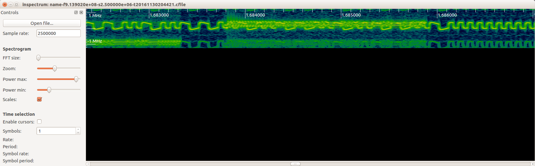

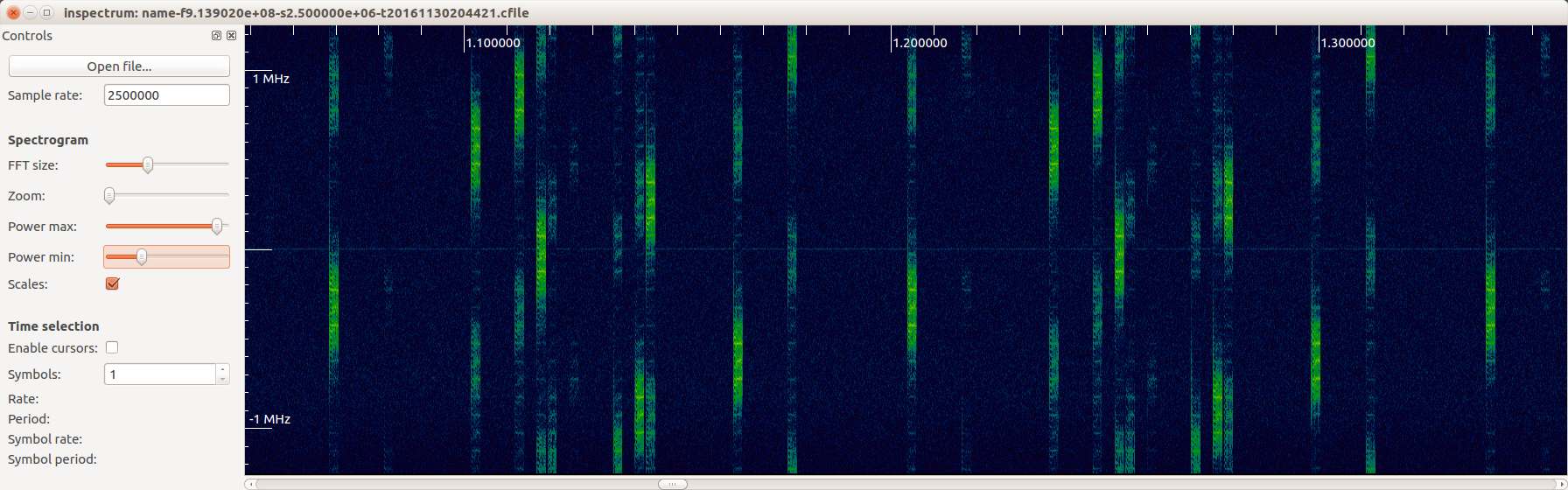

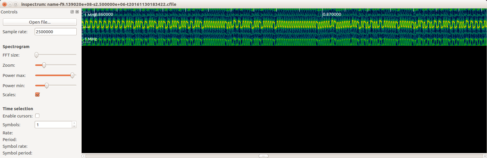

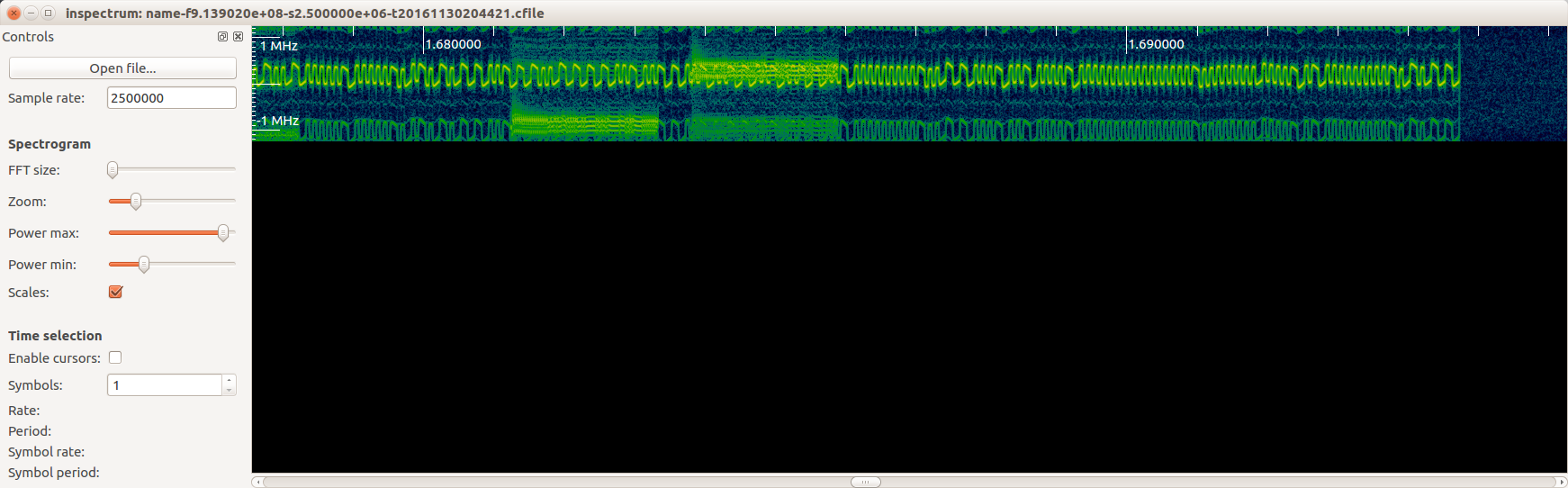

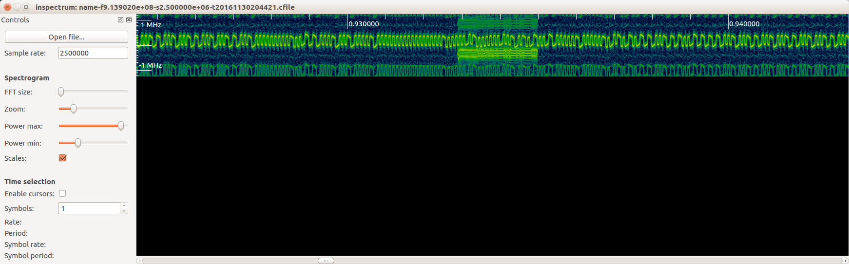

Double Bingo.
Found the exact problem when you compare the FM modulated signal in a "clean" (home) environment and at the location... Note: as per the documentation the signal is NOT repeated, and has a CRC ..
You can see a clean signal, (home) and the general repeater signal at the location.. then you can see the actual overlap/interference on the Signal 1 and signal 2 screen captures.. now it's obvious why it's interferring..
still not sure how to solve it though.
