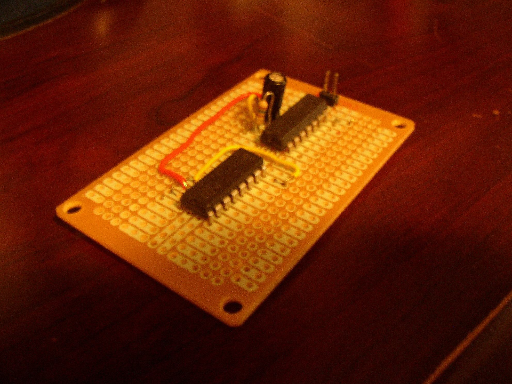

Okay, so i made it and it doesn't work. Now I'm screwed. I don't have even the slightest clue as to what it could be. I soldered all the joints (I think correctly, I'm sure many will think otherwise), and when I test it with my 9v battery I get readings of 9.02V on the right pins (and also on the negative input). So I don't know where I should begin troubleshooting.

To start with, take the 4017 out of the circuit by either removing it from it's socket (if it is in one) or by removing the link to pin 14.
Connect the black lead from a meter ( set to DC volts ) to 0v (ground) and the red lead to pin 4 of the 4011 to check that you are getting pulses. If not, the fault is with the 4011 part of the circuit.
Check and check again all connections and polarities.
Post pictures if you can.
Is the 4011 IC backwards?
Is the 4017 IC backwards?
Are the LEDs backwards?
Two connections on the schematic must connect to the + of the 9V battery.
Two connections on the schematic must connect to the - of the 9V battery.

Whoops didn't see HouseofWaxes' post. Hmm there's no pulses coming, it's just staying solid at 8.7 volts.

Are you sure everything is connected up correctly ?
ICs the right way round ? LEDs ? The resistors and the capacitor ?
I'm not really sure of anything anymore, but I'm pretty sure that everything is hooked up correctly. What are the reasons why the 4011 wouldn't be pulsing?
Note my inability to solder well (I don't think I crossed any connections I shouldn't have though).
It sized it down a lot, if you'd prefer a higher res one just hit me up.
Also if you'd like an undoctored one tell me
EDIT: better image

First, where is the capacitor for your 4011? I can't see it.
EDIT: On second look, I see a cap, but the one I am referring to should be C1, coming from pin 4 of the 4011 to one end of your variable resistor. Without this capacitor, the 4011 will not "pulse".
In the first picture it's at the far left, right below the - (black) wire. in the one with all the colors it's the blue line on the lower half right side. It's a light orange color.

I may be wrong here, but pads 1 & 2 look like they are shorted to pad 3 on the 4011.
Here's an idea, remove the 4011 ( observing anti-static precautions ) and using the multimeter ( set to low ohms ) check for solder bridges. If you find any re-melt the solder and run a knife or similar sharp pointy item through the bridge.
