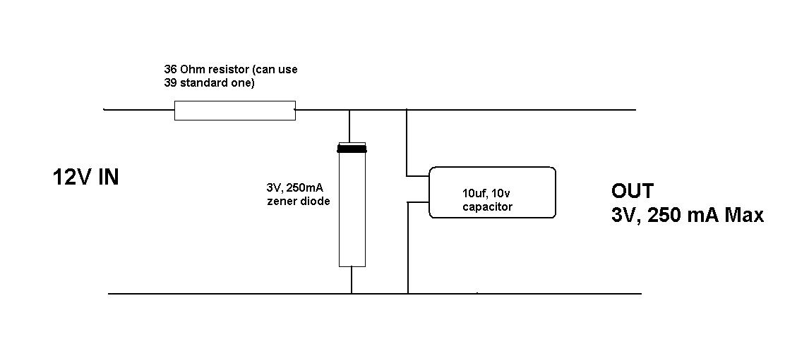

Looking to remove the AA x2 source 2x1.5 to being a 12v to 13.4v source. What would i need to make this work? I'm thinking just the resistors but i'd like someone with a bit more experience to give me a little helping hand if possible please!
