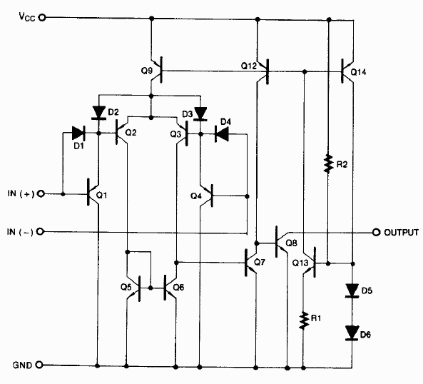

my very first post! as a noobie to electronics this will seem silly to most of you. but it's something i can't find a answer to.
with a LM339 comparator, is it O.K. to have a input voltage higher than the supply voltage? example;
+ input 12VDC
- input 5.5VDC
supply(Vcc) 5VDC
any help anyone can give is needed! thank you ,cary
It won't hurt the input, but the device won't work.
If you don't put current limiting resistors in series with the inputs the internal protection diodes will burn out causing destruction of the IC.
Why didn't you look at National Semi's datasheet? It says that the positive input voltage may exceed the supply with a max input of +36V.
The LM393 dual comparator is the same.
That's conditional, and the OP's inputs violate common-mode input voltages. Best to just try to keep the inputs within VCC whenever possible.
I did look at the datasheet, I looked at the schematic not the technical specification and totally misread it. You're right, the diodes won't be overheated because D1 and D4 feed into PNP transistors which will be turned off and D1 and D2 will protect Q9.

thanks for all the replies. but i still need to know, is it able to work?
to me the schematic of the internals of the ic looks like it doesn't out put any voltage when the output is "high", right? a "high" just shuts off the output transistor and lets the pull up resistor feed to the next component in the circuit, right?
like audioguru said i went back and reread nationals data sheet, on page 7 it says the output doesn't have to be tied to Vcc, it can be anything from +2VDC to +30VDC. what i am doing is trying to use the lm339 to control a stepper motor driver board that needs to have 5VDC to change the motor direction.
so will it work to ;
feed 12VDC to the Vcc pin on the lm339
then feed 5VDC through a 3.3k resistor to the output pin
then to the stepper driver board control pin?
again thank you for your time and answers, cary
If you read the data sheet very carefully, you'll recognize that in your original scheme, you were violating common mode input voltages for that chip. While it's true that you can exceed VCC on an input pin, you can't exdeed it on both pins. The output of the amp will be indeterminate if you do. You can usually divide the input + and - voltages to get them into spec.
That should work.
If you have 12VDC on the LM339 Vcc pin, then the normal operating range on the inputs would be anywhere between 0V and 12VDC.
Connecting 5V through a resistor on the output pin will give you an output of either 0V or 5V, depending upon the differential input signal level.
Yeah, you're right, the new scheme will work. I was confused because you were originally powering the chip with 5V. Using 12V buys you the wiggle room you need for the input voltages.
