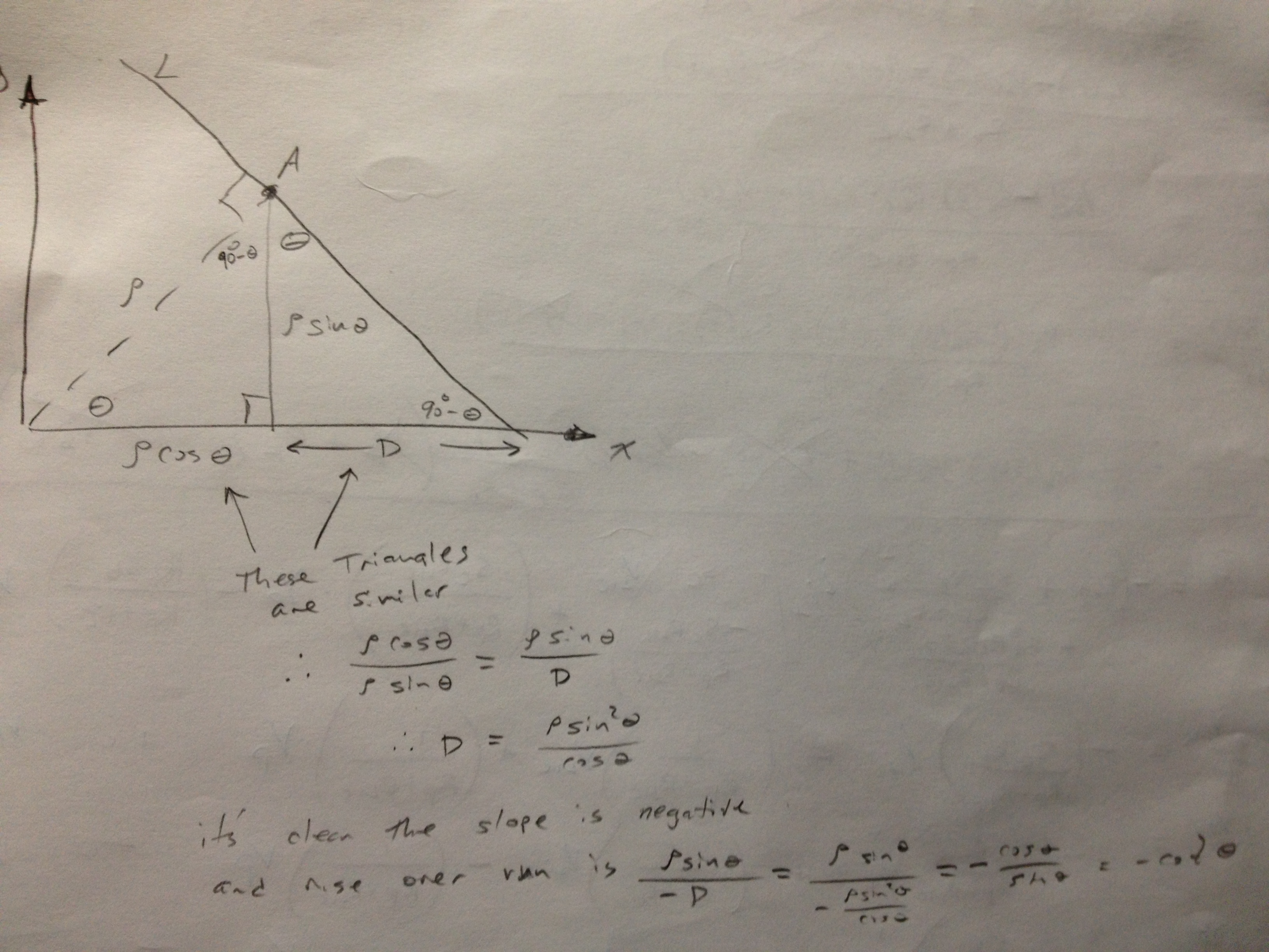

The slope of a line 90 degrees from the radial is -1/m where m is the slope of the radial.
Another way of looking at it is if you add 90 degrees to the angle you get the angle of the 90 degree line, and the slope then would be:
m=tan(A+pi/2)=-1/tan(A)=-cot(A)
You can also use a little bit of geometry, as I've shown in the attachment.
Slope is rise over run, and I show a way to identify the rise over the run. Similar triangles can be set up to identify distance D which is the run (the run happens to be negative D here). The rise was already identified in your drawing.
Now, the triangles are obviously similar if you consider that all angles in a triangle add to 180 degrees. Then similar triangles may have different lengths for the sides, but the ratios between corresponding lengths are all equal. Hence a simple ratio identifies the length D.

Thank you, MrAl, Steve.
A picture is worth a thousand words!

Hi again,
We get another viewpoint from the language of vectors. Here r is the 2d vector:
r(t)=[R*cos(t),R*sin(t)]
and this is just a circle with center at the origin and the slope is just ry(t)/rx(t)=R*sin(t)/(R*cos(t)=tan(t).
The tangent vector is:
T=dr(t)/dt=r'(t)=[-R*sin(t),R*cos(t)]
and the slope of this is just ry'(t)/rx'(t)=R*cos(t)/(-R*sin(t))=-cot(t)
