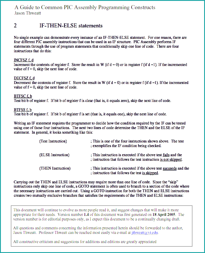

For the IF/THEN/ELSE construct, I found the following explanation clear and precise.
If you like what you see, you can read the rest here:
Is the IF/ELSE statement available in MPlab?
The IF/ELSE/ENDIF statements are available in MPASM. They are used as control directives for conditional assembly.
