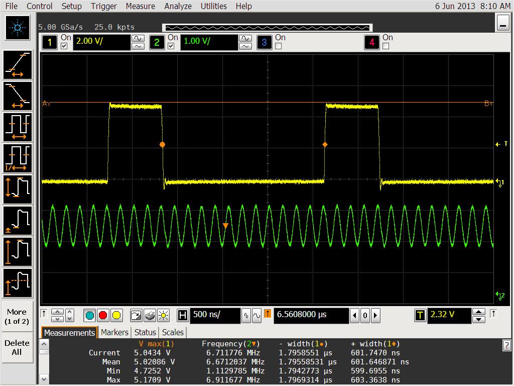

I'm trying to get a pulse to be 200ns. From what i have read, this can be accomplished by using a 20MHz crystal. I use a 12F683 and the capacitance with the crystal is 22pF.
When i scope the output the pulse width is 600nS. Why is it not 200? Also when scoping the crystal it shows 6.6MHz and not 20MHz.
I have attached both my code and the screen dump from the scope.
Thanx.

200nS to 600nS is off by exactly the same ratio as the 20Mhz to 6.6Mhz error of 3:1.
Your code is probably OK, but you have an error with the crystal oscillator. Double check your hardware and config settings.
I recently had the same problem myself.
I wanted to clock a PIC at 20Mhz, but the 20Mhz crystal was running at 6.67Mhz.
The thing is, crystals are often operated in "overtone" modes. It is common for the crystal to operate at 3, 5 or 7 times their fundamental frequency.
In your case, the crystal is operating on its fundamental frequency rather than its third overtone.
Usually the way to make the circuit work on the third overtone is to reduce the gain at the fundamental frequency, often by including a tuned circuit tuned to the third overtone frequency.

Oscillators specifically made to operate on crystal overtones are different than ones made to operate on the crystal fundamental frequency. They include LC elements that kill the gain of the oscillator at the fundamental frequency but boost it at the 3rd, 5th or 7th overtone. The internal oscillator in the PIC is capable of fundamental operation only.
The cutoff frequency where crystals are manufactered to be either a fundamental or an overtone crystal is about 20Mhz. That means if you grab an odd 20Mhz crstal out of the junk box, the manufacture could have specified that that particular crysal is to be used in a fundament mode, or that it was intended to be used in overtone mode. The data sheet (if you had it) would specify this. Without the data, you are guessing.
Note that a fundamental crystal will likely oscillate at it's overtones if placed in the correct oscillator, but its overtones are not exactly three, five or seven times the frequency stamped on the crystal. Similarly, if a crystal is intended to be used on a specific overtone, then it will not fundamentally oscillate exactly at one/third, one/fifth, one/seventh, etc., but it will be close to that.
btw- the period of a 20MHz oscillator will never be 200ns, it will be 50ns.

20 MHz is not likely an overtone crystal. What situation you may have is your circuit does not have enough loop gain to operate at 20 MHz with the feedback setup you have with parasitics of layout/hookup but enough gain to operate as a lower frequency RC oscillator.
A fundamental mode 20 MHz crystal will look like a capacitor below its mechanical resonance. In range of 6 pF.
One sure sign it is not operating at the piezo resonance frequency of crystal is to vary the power supply by +/- 10 to 15%. If the frequency moves dramatically as you adjust supply you are operating as RC oscillator.
Parallel stray capacitance between input and output of inverter can prevent crystal oscillator from operating properly. Superstrip breadboard have a lot of adjacent pin to pin stray capacitance. Be aware of your connection stray capacitances. Inductances will be insignificant at 20 MHz unless you are spreading oscillator circuit out across your workbench with several feet of wire.
Are you using the circuit in the spec sheet? Try R1 series to output of about 1K. 18 pF on each side of crystal, based on assumption that crystal is parallel mode expecting 10 pF load. 15M to 22M biasing feedback resistor across active inverter.
Only probe on output of inverter, not input or after R1 resistor. Remember to consider the loading of scope probe. 40 pF for 1X , 11 pF for 10x divider probe. Use 10x probe setting only to get lowest probe capacitance.
Other possibility is you are look as a processor port that divides the oscillator by some integer, in this case three. The duty cycle is typical of what you would see dividing a 20 MHz 50% duty cycle square wave by three. But also realize the output of the oscillator buffer will not likely be 50% duty cycle due to bias offset on oscillator inverter. Direct crystal frequency is seldom used by processor because its duty cycle is variable depending on biasing and gain of inverter stage. You almost alway see at least a divide by two internal to processor to ensure predictable duty cycle to run logic within processor.

Maybe the OP has got the PIC oscillator config wrong? Maybe set to XT mode and not HS mode?
I looked at the crystal and found with some googeling that the part number (CR-77/U) is an Overtone Mode Series resistance crystal. Sorry for not checking this earlier!
Are you saying that the right crystal to use is a 20MHz fundamental mode?
Yes.
And notice on that listing that the range of almost all fundementantal crystals ends at 20MHz and that the range of overtone crystals starts substantially below 20MHz, so if you pick the odd crystal out of the junk box, you really have to look it up...
The 12F683 is designed to have a maximum oscillator frequency of 20 MHz, and you may struggle to get a reliable oscillator to work at 20 MHz 3rd overtone. Your best bet is to put a resistor of around 2.7 kΩ in parallel with the crystal. Do not use any resistor in series.
The oscillator is designed to run anywhere from 1 - 20 MHz, so it is quite possible for an crystal designed to run at frequencies lower than 6 MHz to run at an overtone where it isn't expected. Where that happens, the series resistor, along with the load capacitor, reduces the gain at higher frequencies so that the overtone can't happen.
A 20 MHz fundamental crystal is around 83 μm thick (0.083 mm or 0.0032 inches) and will be fairly fragile. That is why 20 MHz is around the point where crystals change to overtones. Crystals at 1 MHz will be 1.66 mm thick. Crystals work best when the diameter is large compared to the thickness, so the smaller, lower frequency ones will not work very well, and the overtone modes may be difficult to avoid.

In my last job, I designed crystal oscillators, so I used lots of crystals. A crystal around 20 MHz running at 1/3 frequency is almost certainly a crystal designed to run at its 3rd overtone running at the fundamental frequency, especially if the frequency is stable.
You can certainly use a fundamental crystal quite easily, but you do have to get the layout reasonably good. Long wires between the crystal and the oscillator circuit will often stop it working.
32.768 kHz oscillators will often run at an overtone (although those are tuning fork crystals and the overtone isn't 3 times the frequency). That is partly because the oscillator circuit can have a very high cut-off frequency compared to the crystal frequency, which is less of a problem with 5 MHz+ crystals. For the 32.768 kHz crystals the series resistor is often needed, and it has to be 10kΩ or higher. The start-up time is often several seconds.
As soon as you get into overtone crystals, oscillators where the frequency needs to be better than 50 ppm, or voltage controlled, then there is quite a lot of knowledge needed to get the oscillator to work every time. (Oven oscillators or temperature compensated oscillators are another complete level of difficulty).
