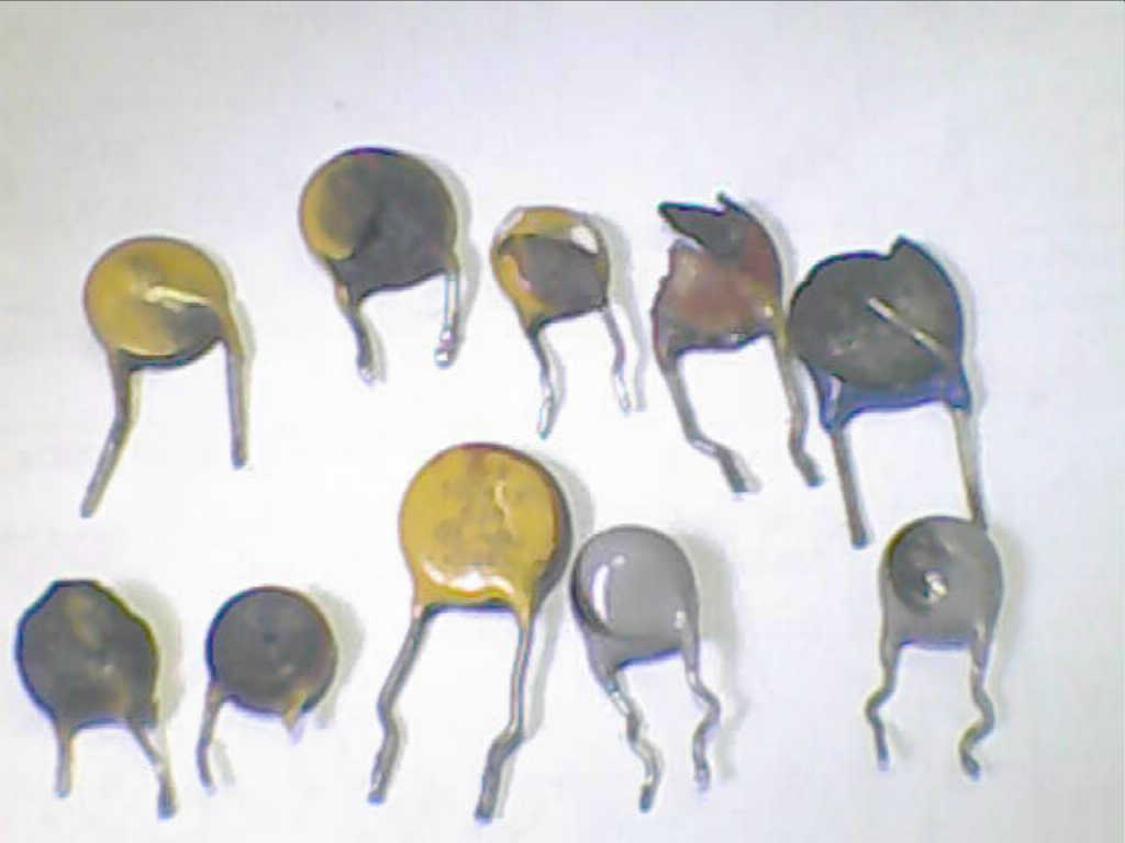

Did you mean the varistor will make short circuit at 150V AC? (to burn out the fuse instead of valuable device)
Exactly. Here are some brave varistors that sacrificed themselves to save the rest of the supply when high mains voltage was present.
An electrical surge arrestor was sold with a window that showed the MOV. It was labelled, "When it turns black then send it back".
With window??? Window of house?? Confused! To protect from lightning surge?
Meaning there was a clear window over the MOV. When it was blown by a surge or lightning it would turn black, signaling the owner it needed to go in for repair as it is no longer protecting.
