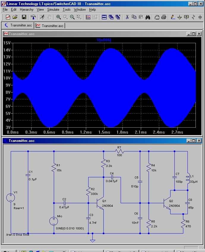

The fact is that we are talking about analog circuit (and very simple one)
so it is normal to get smoe parasite effects. The statement about AM is
quite true because AF signal comming to base of Q2 not only modulates
the frequency (B-C of Q2 acts as varicap) but by changing voltage of the
Q2 base it also affects the amplitude of oscillations. I've just done some
quick simulation to show how the RF looks when modulated with 1kHz AF.
To make it work in simulator I lowered frequency of the oscillator
by changing values of LC circuit and feedback. There are circuits using varicap on this forum or just use google. Basically you connect diode
(reverse biased) in series with a capacitor. Thic is then connected in parallel with LC circuit. The AF is brought through high impedance circuit
to midpoint of the diode/capacitor combo.
You can easily simulate this and you will see that AM in this case is
minimal or next to nonexistent. This is how signal looks on your circuit.
Note that Vpp of the RF signal is only ca 11V. With some tweaking you can get ca 30-40V peak to peak. Remember that power is P=V^2/R
so 3times higher amplitude means 9x higher power and 4x amplitude
is 16x higher power. The more power - the bigger the range...

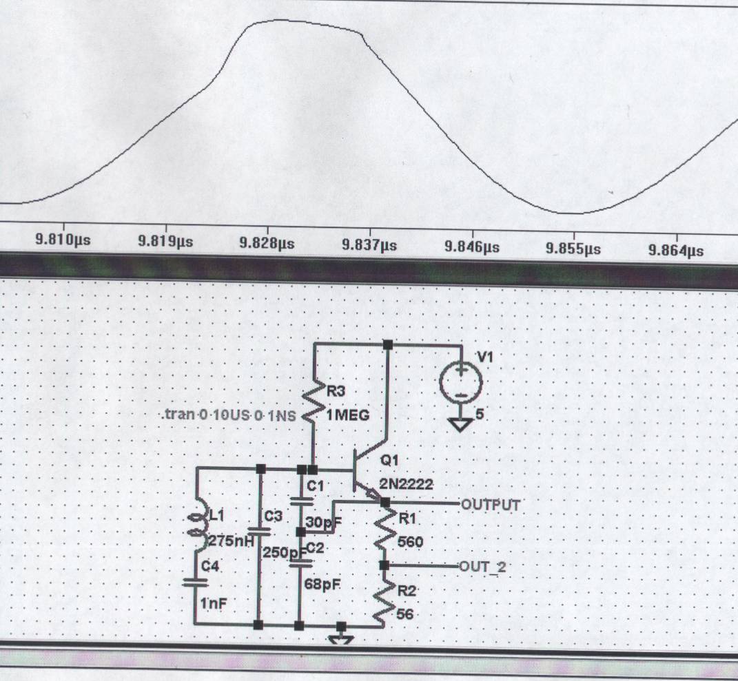

You can't p-p output voltage of more than twice the supply voltage, because of transistor saturation. The collector voltage will never go below GND in the limit.
:x
Well, if that's your idea of tweaking, OK. I was thinking bias voltage and/or current.
