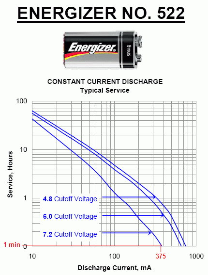

You'd need a wall transformer rated at 24VDC and 375 mA output.
I'd think you would be able to get away with using 3 9V's in series. Thats what I did for my potato gun, but I would just apply the voltage for a short period of time to fire the gun.

Name-brand 9V alkaline batteries won't quite do the trick:
