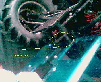

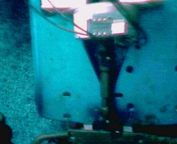

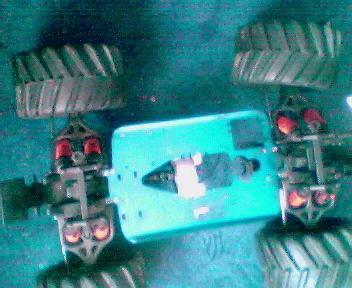

i have a pic of the model.
another
So this is the RC car.
Dose it alredy have the motors in ?
All you need now is the control circuts.
