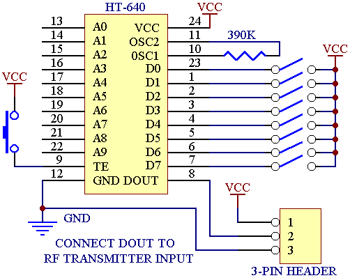

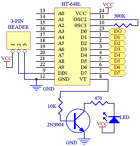

rf transmission files are attached here:
and you can use arduino board for the transmission :
@ Arduino - HomePage
magnatro...
