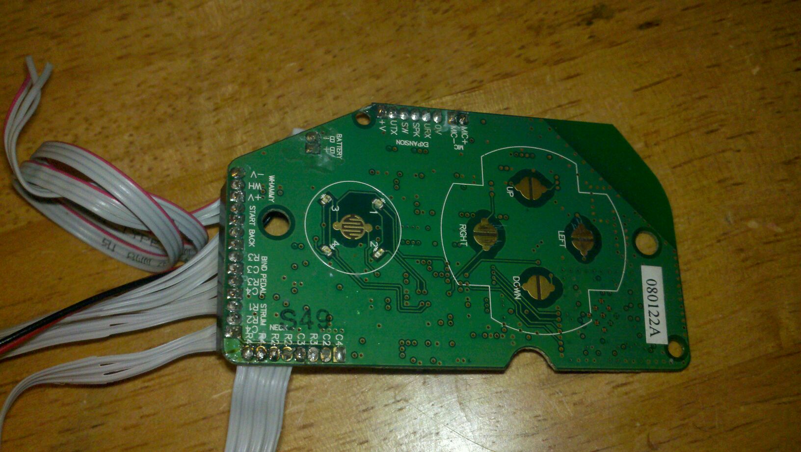

Thx for the reply. The 360 wireless uses 2.4GHz wireless technology with 30-foot range, Not sure if it is BT or not.. Still looking into that. I'm currently figuring out the workings of an existing controller that served me very well for a long time. I already planned to replace the factory contact-switches with momentary micro switches (mms) donated from some older equipment I had laying around. I have tested the mms and they work fine!
I worked out the layout for the controller on my CAD program last night.
As for the circuit board, I was actually thinking that there might already be a manufactured multifunction DIY remote board out there that could possibly work for me. But I'm unsure where to start looking for that. It also has to be programmable so I can sink it with the game console. Something like a 10 CH remote control.

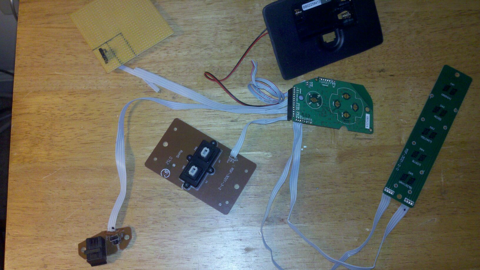

Thanks guys.. This was all very informational. For the sake of just learning my way around the xbox control circuit board. I'm going to be hacking a the circuit board I pulled from a plastic guitar hero controller. I looked at it over the weekend. Although not exactly like the hand held controller I think it has a slight advantage in that it is already partially pre-wired. After some testing the various connections I will only have to need to mess with the directional pad pads as far as adding new wires.
I ordered some short snap in 30M arcade style buttons for the first test of the controller. Once I'm comfortable with that I'll start looking into a new board. I think might be able to sell this controller. Not on a huge scale, but it could be as little as 100 I'm sure.

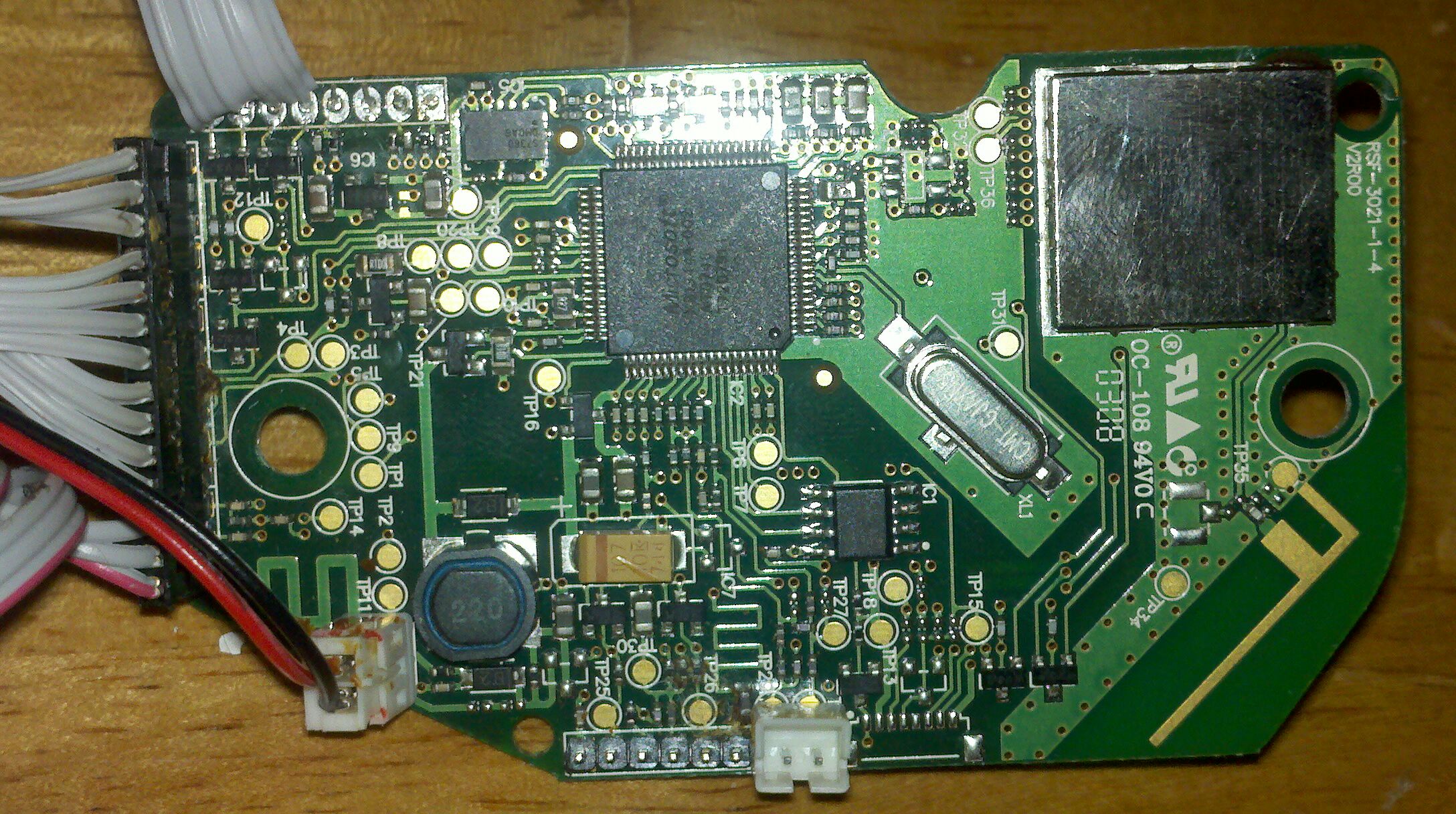

Ok A question... So the xbox controllers are powered by two 1.5V AA batteries for a total of 3V. The question is can I use a power supply that is 3.3V? will 0.3V make a huge difference or hurt anything?
Probably won't hurt anything. Although its proably not just a question of 'everything is powered by 3v', because AA's voltage drops to ~1.2V at the end of their life. Also, recharable NiMH kick out 1.2V average, making it 2.4V nominal. My guess is that theres a switched mode power supply in there, probably a buck-boost/sepic which outputs 3V with an input of 2.4-3.6V. If you look on the picture you posted (3rd) you'll see as 22uH inductor - that'll be part of a switching power supply or perhaps just a filter
If you're worried, and just want to power things up whilst testing out your mods, put a schottky diode in series with your 3.3V as these will generally drop 0.2-0.4V giving you 2.9-3.1V which is pretty much spot on 3V.

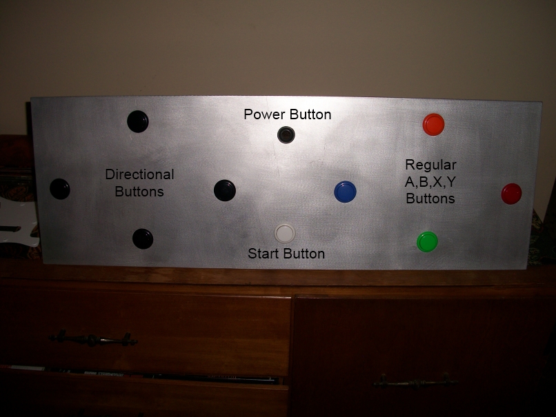

Controller Face Plate
Well as you can tell from the laps in time from my last post.. I finely got the arcade buttons in. Last week to be exact. So this past weekend after measuring and remeasuring and second guessing myself several times. I cut the first hole and there was no turing back from there.
The controller face plate grew to 30" long and only 10" tall. The spacing will work just fine for my size 13 grape mashers.. LOL
I added an additional spring to each button on the inside to get it a little more resistance and a more positive feel. As the buttons come stock they felt really light to the touch when pushed. I wanted to insure they would stand up to constant mashing with the foot.
I haven't finished wiring it up but once I do I'll post more pictures. Hacking the old GH controller has proved to be the smother route to this point.
