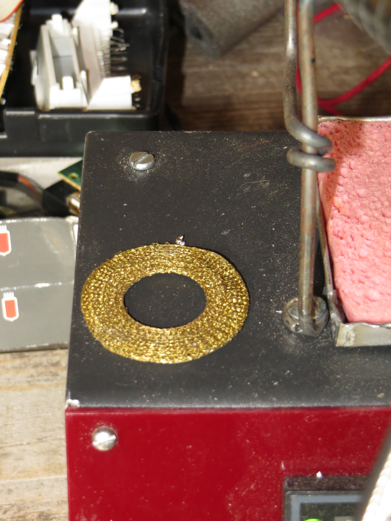

I pulled apart a microwave a couple of years ago so I could build a spot welder using the transformer, so naturally I also pulled apart the magnetron. The only thing I saved from that was the heatsink plates and this ring of brass wire mesh, just because it was interesting and I liked it.
Well, I thought I'd try using it to clean the really tough crud off my soldering iron tip, and it works really well! Going to make a little turntable for it to fix to the top of the iron's station :)

At the risk of sounding like a lurker, I'll just say that the ceramic ends of the magnetron contain beryllium which is very nasty, dont breath the dust if you break it.
I didn't break it - but thanks for the heads up, since I'm sort of vaguely looking out for another...

The "matt gizmo" is part of a magnetron from a microwave oven - not something you can buy. Most definitely do not substitute a Brillo pad, they are made of steel wool which is very abrasive and will destroy your bit.
Edit: Having said that, normal steel wool is manufactured as a form of swarf - long strips of shaved off metal with sharp edges. "Brillo" may be made differently since it is for household use.
I was inspired to try it from having seen brass wool tip cleaners you can buy, such as the ones from Xytronic.

You can buy Brass mesh pan scrubber pads from your local hardware shop, that work as tip wipers.
