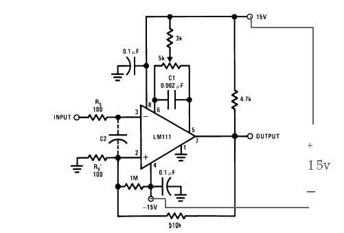

Could someone help me get a better understanding of the basics.
I have attached a circuit & is where i get confused.
It shows four ground symbols a signal input & output & a 15v source, then it has -15v & is what i don't understand when there are ground symbols as well.
I have drawn a 15v source & added the positive & negative signs to it.
Is this correct, so the -15v is just the ground side of the 15v supply?.
If this is correct, are then the four ground symbols just a circuit ground-- 0 trace & there interconnected together & not the 15v supply ground?
Basic, but i get confused with this being a learner?

No.
The ground symbols are all at zero volts, are connected together, and serve as a common between the input and output. The 15V line is +15 volts above ground. The -15V is minus 15 volts below ground. So between the 15V and the -15V lines you should have a total of 30V.

Ok, i understand, but how do i get the (-15v) 15v below ground to do it?
I am not sure how to go about it?
Just to add to what Kchriste said, think of the ground symbol from two standpoints; one, to simplify the schematic, it is an implied connection to all other ground symbols without explict lines drawn, and two, think of it as "0V".
btw: lots of older opamps (LM111 is a special type of opamp called a comparator) utilize split power supplies, which are really two supplies sharing a common tie point which is tied to the ground of the opamp circuit, even though the opamp IC does not have a ground pin itself. Newer CMOS (especially rail-to-rail) OpAmps typically only use a single supply.
Requires two independant 15V "floating" power supplies. Tie the minus of one to the Plus of the other, and call that connection 0V. Now you have three terminals: +15V, 0V, and -15V,

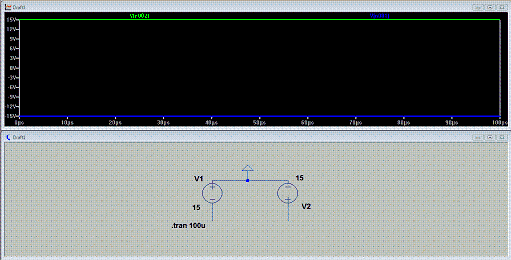

I have not been considering two independant power supplies & this has confused the begeesus out of me, i get it now, thank you!
I have attached a picture of LTSpice to make sure i have it correct.

By Jove, I think he's got it :D
