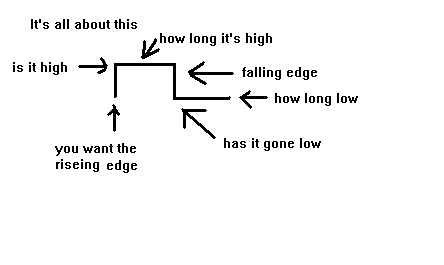

MrDeb this is all you need to think about with swordfish learn how to write basic for all
six states and you'll be on your way to happy coding
