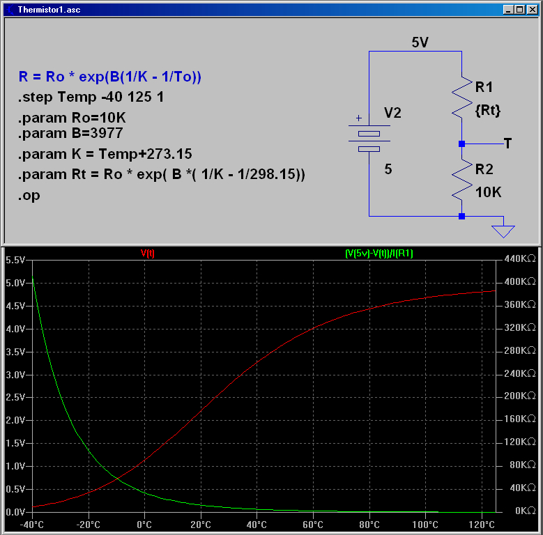

Here is what you can expect. Very non-linear circuit when you try to operate over such a wide temperature range.

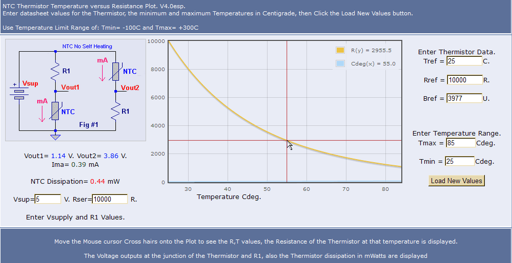

hi sam,
Look here.
Enter your thermistor values.
E
EDIT:
This image shows what the typical response would be of the Thermistor, just add your top 1K resistor value.

that tool uncle eric pointed to is the business! saved me loads of time and effort!
