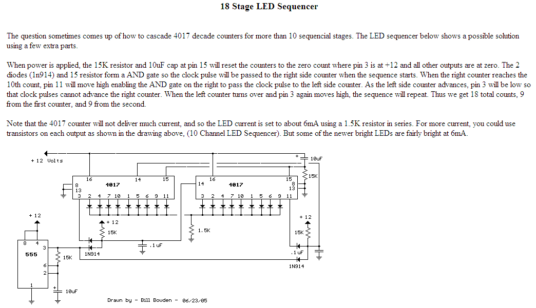

Hi Ian,
I thought about cascading decimal counters of the type CD4017 and came to the conclusion that it can't be done just by wiring an output of one to the clock input of the follow on stage. That way the second counter would only advance by one if the preceeding has counted through 10, meaning the second stage would be clocked at 1/10 of the original frequency.
To overcome this problem an analog multiplexer can be used. I made up a small sample circuit showing the idea.
Inputs A,B, and C are binary coded inputs switching the common input to one of the outputs X0 through X7. All inputs low means X0 is active, input A = H means output X1 is active. To activate X7 all three inputs A,B and C have to be high.
The sample circuit does not include a logic coder to activate any desired output. If A and B inputs are high output X3 will be active. To have output X2 activated, input A requires turn off which can be accomplished by a coder circuit.
Anyway, the complete circuit lets you count from zero to 79 at the same time intervals.
Hans

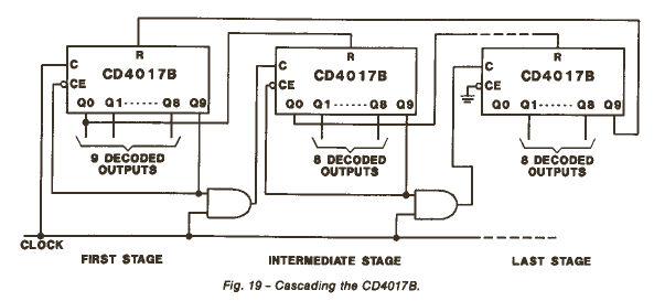

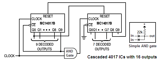

Datasheets for the CD4017 show how to simply cascade them to get more sequenced outputs.

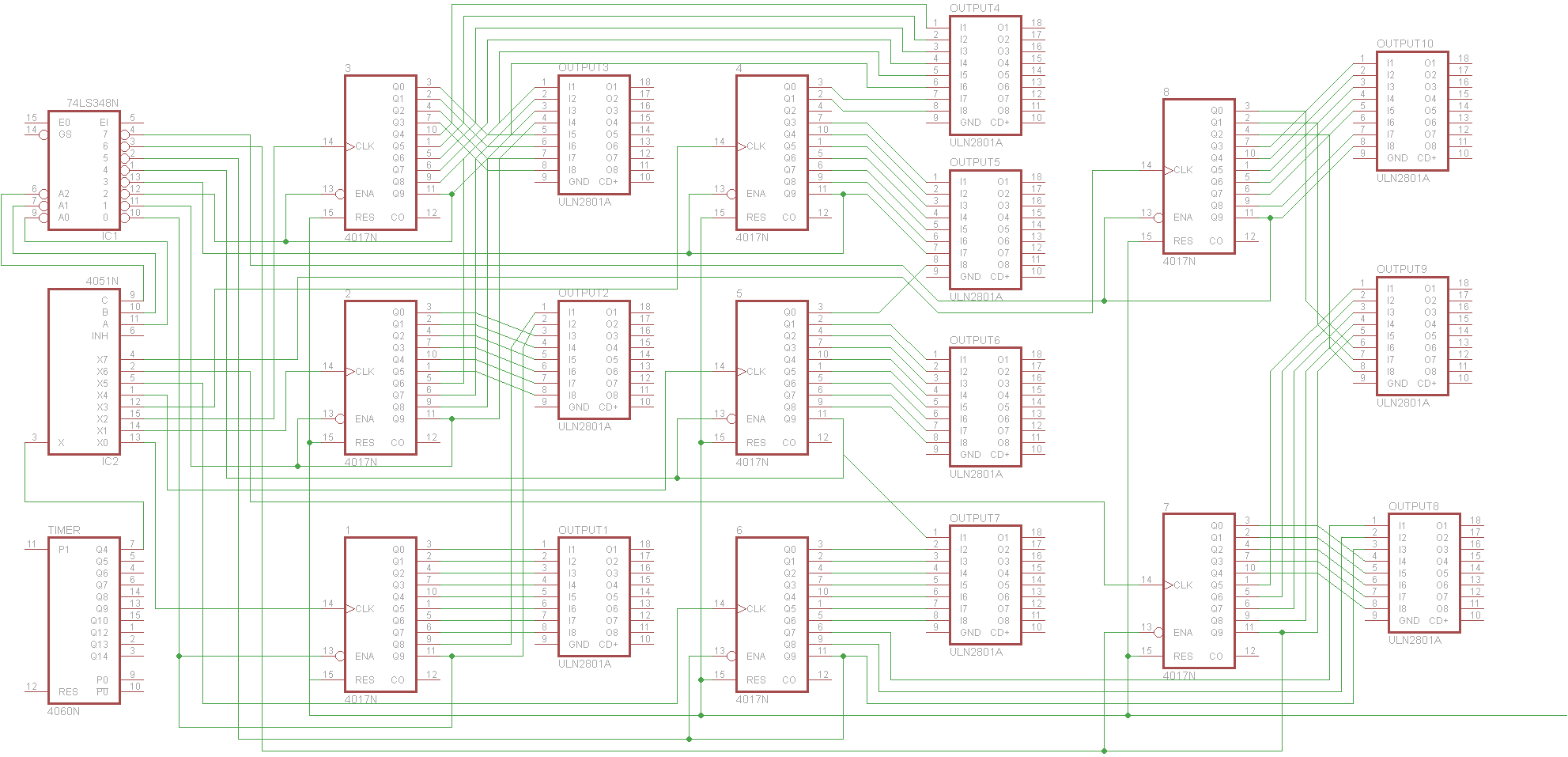

I was looking at the data sheet on the uln2803 I am going to put 12v to fire the talons but what I am wondering is what voltage is needed to turn on the 2803 it will be coming from the 4017 EAGLE Schematic

triing to post a picture of my schematic but it wont let me for some reason sorry for double post
What is the file extension type and file size.??
Are you trying to upload using 'Go Advanced' features.?
E
it is the right extension type file size not sure have not looked and where is advanced features
You are mixing 5V TTL 74LS with 12V Cmos. A CD4017 with a 12V supply probably will not be triggered from the 3.5V output high of the TTL IC.
When an output of the CD4017 goes high then the output of the power darlington IC goes low.
The ULN2801's are missing input current-limiting resistors that were on the NTE2018 so the CD4017 ICs might be damaged.
the 74 are not triggering the 4017 the 4051 is triggering the 4017 and the 4017 are triggering the 2018
You do have the 74348 interconnected with the 4000 series parts, so you do have 5V and 12V logic intermixed. But you can run the 4000 stuff on 5V.
The unselected outputs of the 4051 go hi-z, so that leaves the inputs of the 4017s that they drive floating, which is a big no-no for cmos. Put pullup/down resistors at each input to prevent spurious triggering of your igniters.
I still feel that a 7 or 8 bit counter driving an array of decoders would be a better way to accomplish your task. It would be a lot more straight forward.
I have all the outputs connected on the 4051. can you show me or give me the part# for a counter.
in the circuit I have drawn I plan on using the 5v for the 4051 and the 4017 and when the 4017 fires the 2801 it will put out the 12v. I do have a resistor of 10k at the outputs of the 4051 to ground just could not put them on the plans
