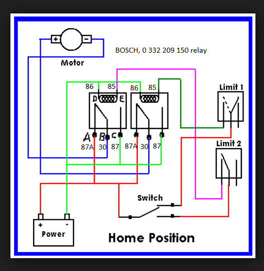

I know numbers for icons is so lame. However would someone/someones please put the numbers for a SPDT relay, 30, 85, 86, 87, 87a by each letter?

I would not bother trying to identify the numbering system. I would first identify the coil with a multimeter. I would then Identify the NO contact as follows. Test which of the remaining three (After the coil.) show continuity between them. These will be the common anf NC contacts (But you do not know which is whic at this point) The one that does not show continuity is the NO contact. Now apply power to the coil. Test which of the two that had shown continuity now show continuity to the NO contact. This will be the common.

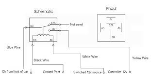

I've just Googled "automobile relay connections" an found this information which agrees with the information that Max has given you. I think I may have missunderstood your problem. I think now that your problem is that you do not understand the schematic. In the diagram in post #1 the coil connections are D and E which will be pin numbers 85 and 86 (It does not matter which is which.) The common contact is B which is pin 30. Assuming the relay is shown de energised (No power to the coil) then A is the normally closed contact (Pin 87A) and C is the normally open contact. (Pin 87)
Les.
What would help is a photo of the particular relay you are going to use from the bottom & side views. Theres just too many combinations of Automotive relays. In the Bosch range for example ones used by Ford are not interchangeable with ones used by GM, they look the same but are wired internaly diferent.
Biba doesn't like my posts for some reason.
https://www.12voltplanet.co.uk/relay-guide.html
Recommended polarity
According to DIN 72552 the coil should be fed with +12V to terminal 86 and grounded via terminal 85, however in practice it makes no difference which way around they are wired, unless you are using a relay with an integrated diode (see more info on diodes below).
Not all automotive relays have the same pin numbering
You will notice that on the Type B layout pins 86 and 30 are swapped over compared with the Type A layout. The Type B layout is arguably easier to work with as the connected terminals are in-line, making the wiring easier to visualise. If you need to replace a relay make sure you use one with the same terminal layout as it is easy to overlook if you're not aware of the difference.
Pinout
See the article for details. So we really can't give you a pinout without the relay. Ohmmeter is a good suggestion.
Suppression diodes
Important: There needs to be a diode across the coil where the band points to the negative voltage of the coil.
Motor should short to ground --> schematic shows short to +12
Not a good idea (Les and Max, back me up) to have the motor "shorted" to +12 at rest. It's better to "short to ground".

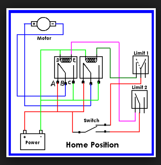

Scroll down to Simple DC Motor Control'. What is laid out is 'almost' exactly what I'm looking for. I've wired up what he has except I do not understand how two SPDT momentary contact limit switches can be used. The limit switches on the spoiler have three wires with the minus common to the both of them. I'm using a SPDT momentary switch to control it, but nothing is happening. I'm sure it could be made to work. That said if it turns out to be a dead end, I'm open for a more complex solution.
Biba:
KISS works.
That webpage has a lot of gotcha's neglected. Those I covered in post #9.
Two momentary limit switches will work without issues ignoring the gotcha's. They need to be independent and open when the system is at a limit. They are momentary because they close when the system is not at a limit allowing both an RETRACT and DEPLOY command.
Conceptually, the idea is to have a relay that grounds both ends of the motor when at rest, This grounding causes the motor to act as a generator into a short.
The author decided that both sides at +12 accomplishes the same end result - the motor stops quickly. This makes the motor stop really fast and not overun.
Each of the relays can be thought of DEPLOY and RETRACT. Use whatever opposites work for you CW/CCW; UP/DOWN, OUT/IN whatever. Whatever floats your boat.
So, if you IGNORE the limit switches for the moment, activating the DEPLOY relay (energizing the coil) makes the motor go in the DEPLOY direction.
Activating the RETRACT does the opposite.
To activate that relay you can employ positive or negative logic which means a switch to ground or a switch to positive. I, sort of, care.
It's then easy enough to wire an SPDT switch (on)-none-(on); call it S0 or Switch(Operate), to activate one or the other relays. Ignoring the limit switch, it's one of the power door lock circuits that I linked too.
Since the automotive relays have different wiring schemes and terminal assignments, you have to pick the right one. USUALLY the diagram is on the relay itself in schematic form. That's what you need to use. If you don't have that provide the model # of the relay.
So, if you can't make the motor do stop/brake, forward, reverse with the momentary switch there is something wrong with the wiring. We know that not all automotive SPDT relays use the same terminal nomenclature. Way back when the 30's and 87's were circuit numbers, so this tradition carried forward.
It was also decided that some terminals should have a positive voltage on it as a "CONVENTION". You can get relays with an integral suppression diode or not. In that case the terminal has to follow the convention.
The right wiring is really simple. The common terminal gets connected to the motor. The normally closed terminal of each relay goes to ground and the normal open terminal goes to the motor supply voltage, The website you referenced ignores the details. it's wired in a way that will work, but it's not the way that most of us EE types would do it.
Your left with two coils and if you follow a convention spelled out by the DIN standard, you would make the designated terminal always positive. You can pick. When using a switch, switching the positive makes sense. In automobiles, the dome light switching ground is a cheaper switch to make. So, grounding one of the relay terminals and moving the positive wire makes more sense. A short to ground would blow a fuse instead of making the motor run which is a good thing.
At last count, you were unable to achieve that. You have to be able to achieve that basic functionality. You can pretty much BUY this functionality already wired with the dual socket, because it's a common thing to do.
No relays activated - motor stopped
Two relays activated - motor stopped
one relay activated - one direction or the other depending on what relay

Before adding limit functionality. the relays must function in the following manner:
I want to stop here and see if you (Biba) understands what was said in this post.

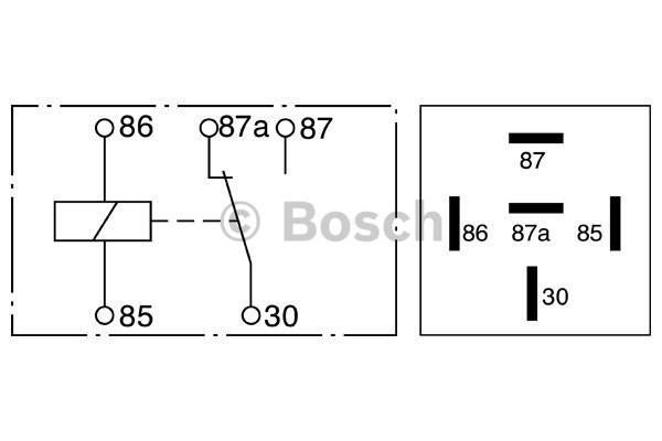

The relays are Bosch 0 332 209 150. There is another number but I assume this first one is the model number - the other is V23294-A1001-Y036.

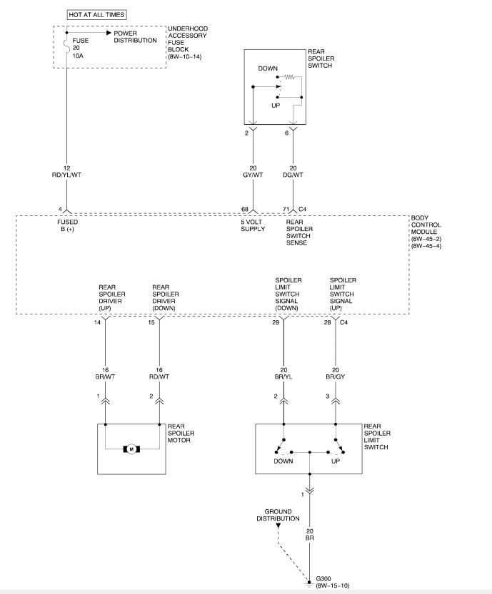

There is a fellow on the Chrysler Crossfire Forum who has a Miata with a working Crossfire Spoiler. I gather it is activated by a simple switch. Unfortunately, if it is possible, he has less of a clue how it works than myself. He bought it that way.
Of course I do know how the XF (Crossfire) spoiler works - in general. When I checked the voltage of the spoiler's motor on the Ltd while opening it through the dash switch, it was 13.5V. The voltage for the limit switches was 12.5V.
I do not need any kind of warning chime. No one is in danger of getting hurt when it is deploying.
I've just ordered a new multimeter which should be here in a few days so that I can check out the voltages on my set-up.
Please feel free to contact me directly on biba@earthlink.net since I would like a ball park cost on both the Basic and and Moon options - along with time frames.
Now that you have identified the particular relay you are using, is this of any help.
Even though I don't LIKE the wiring take out the limit switches in the picture and replace the contacts of the limit switches show in the pocture with shorts.
If you use your motor only, you should get CW, OFF/BRAKE and CCW using the SPDT Center off, momentary switch.

The limit switch voltages, I would have expected around 5 VDC when not at a limit and 0V when they were at a limit. Good to know. Can easily mimic the 12 V thing.

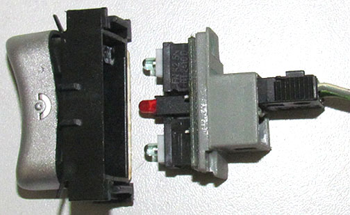

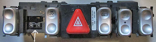

I want to take a few "baby steps" concerning the SWITCH. Link to or post a pic of the switch front and back if you can. I think you did somewhere.
How many wires does it have?
I know it has two terminals and two resistors inside that need to make 3 states. The resistance of those two terminals and the position of the switch needs to be known.
DEPLOY ; R=?
OFF; R=?
RETRACT; R=?
The positions are momentary center off, correct?
I was unable to uncover anything about the spoiler malfunction indicator wiring. Is it likely 2 wires and a LED? No multi-color stuff?
Does the switch have Illumination (Dash lights)? What do you know about it?

SS, keep in mind the spoiler switch on the dash in the SRT6 is just a dummy. A couple of things: What is the chime situation? Is it supposed to be a warning chime like a backing up one? I'm quite sure there is no chime for the spoiler; I'm guessing that the 'rpm' of the motor is about 4 - 6 seconds per one revolution.; I do not want a colored lighted switch; if at all possible I would like to cut out the dummy switch and - if not possible to use the original momentary rocker switch - then one which is 11/16 W - 1 9/16 H; I'll add there is a click when pressing the upper/lower switch which also has a fairly light spring; you'll note that on the partial dash rocker panel the lower white arrow is pointing to the mini LED light connection.

Coutesy of a post at crosfire.org, here's the schematic of the spoiler/spoiler switch.
This schematic should, in my opinion, show the malfunction indicator, but it does not. I THINK it's lumped into all of the other malfunction indicators on the ECM shematic.
Note that the spoiler switch has an internal resistor. I can't see that on the pic you posted, UNLESS it's on the other side.
Down should have some resistance What is that resistance?
Off should have Infinate resistance and
UP should be a short.
I asked, how many wires on the switch. I can't even tell that from the pic you posted. In fact, I'm not sure it's even a spoiler switch. The spoiler switch looks like the second switch from the right, but why is it labeled OFF?
The LED could be a "naked LED" or the current limiting resistior could be on the switch PCB.
It doesn't even look like the switch can go in the vacant position and it looks like there are only two contacts (The added arrow in the top pic)?
The pins are labeled 2 and 6, so the connector would be expected to have at least 6 pins. (2) Illumination; (2); MF LED; (2) Funky switch or something else. Some could be vacant.
So, very, very confused.
I was the one that posted the schematic above along with others. The real problem of trying to imitate the opening and closing of the spoiler is because it goes into the very dark hole of the Body Control Module. It might be possible that there are tons of lines of programing - along with all of those necessary electronic do-dads - for the various cycles.
I've barely used the dash switch to open and close the spoiler on the Ltd. I've certainly not heard a chime - but even with help, my hearing isn't all that great.
The switch has two wires - one for up, one for down. The switch looks just like the off switch (to help you keep the car on the road) but has a side diagram of the car with the spoiler extended and the other with no spoiler. The switch fits fine. Looking at the side view you see the upper far right black plastic with two wires 9which turn to the left when iinstalled. The black one which is built into the dash unit slips right under the wire section and connects two pins for the center LED. The pins are hidden behind the gray plastic section just to the left of where the black section plugs in. From the left edge of the black vertical plastic to the end of the push-in plugs is 1 5/16" - so yes, it is deep.
I'm having no luck with getting continuity on the switch/relays and have no reason why this is the case. Do you have any thoughts on a different type of switch other than the Spal type one I've been using? You did say that the relays I have are the 'correct' ones?
Getting the limit switches to work shouldn't be too difficult and you can't get much simpler than a wire for each side and common ground wire. How they know how and when to switch off poles is something else. But having the motor trying to go past where the stopping limit is - so it then rotates the outer portion of the motor, causing the contact on the low side to get bent, along with shorting out since the contact hits metal - makes the limit switches mandatory. However, we could use other limiting switches if that would help.
