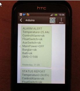

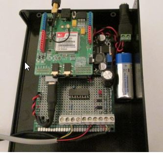

For your remote notification how about an Ardunio SMS, again just need a trigger from the buzzer to activate, or like mine, from a source of different sensors.
If using sms, check what band your coutry is using, many of the cheaper SMS shield/modules only use 2G, some coutries have moved to 3G only.

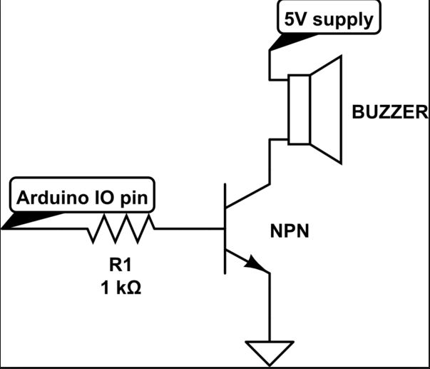

A speaker with the Ardunio typically uses a frequency output, a buzzer just needs a port to be on or off, though for either you may need a transistor if its current is more than the Uno port can deliver on its own.

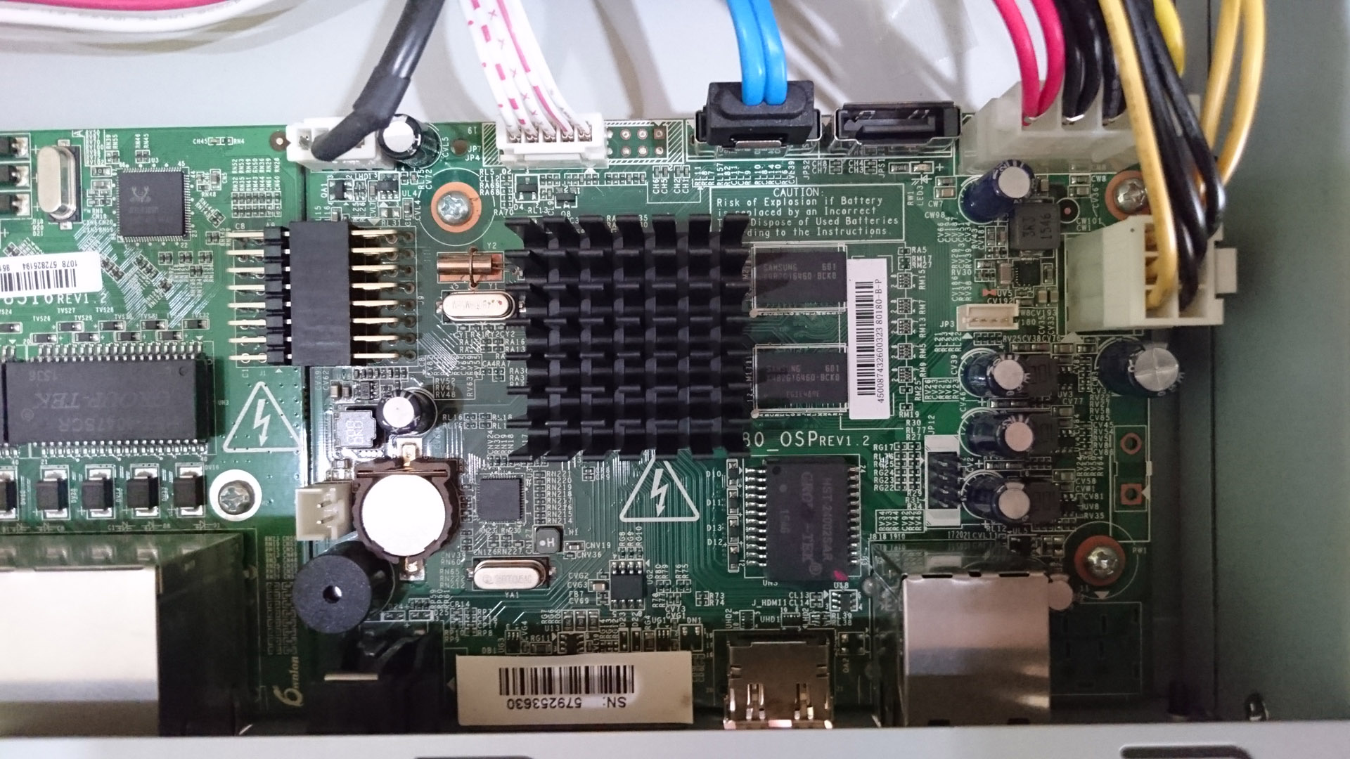

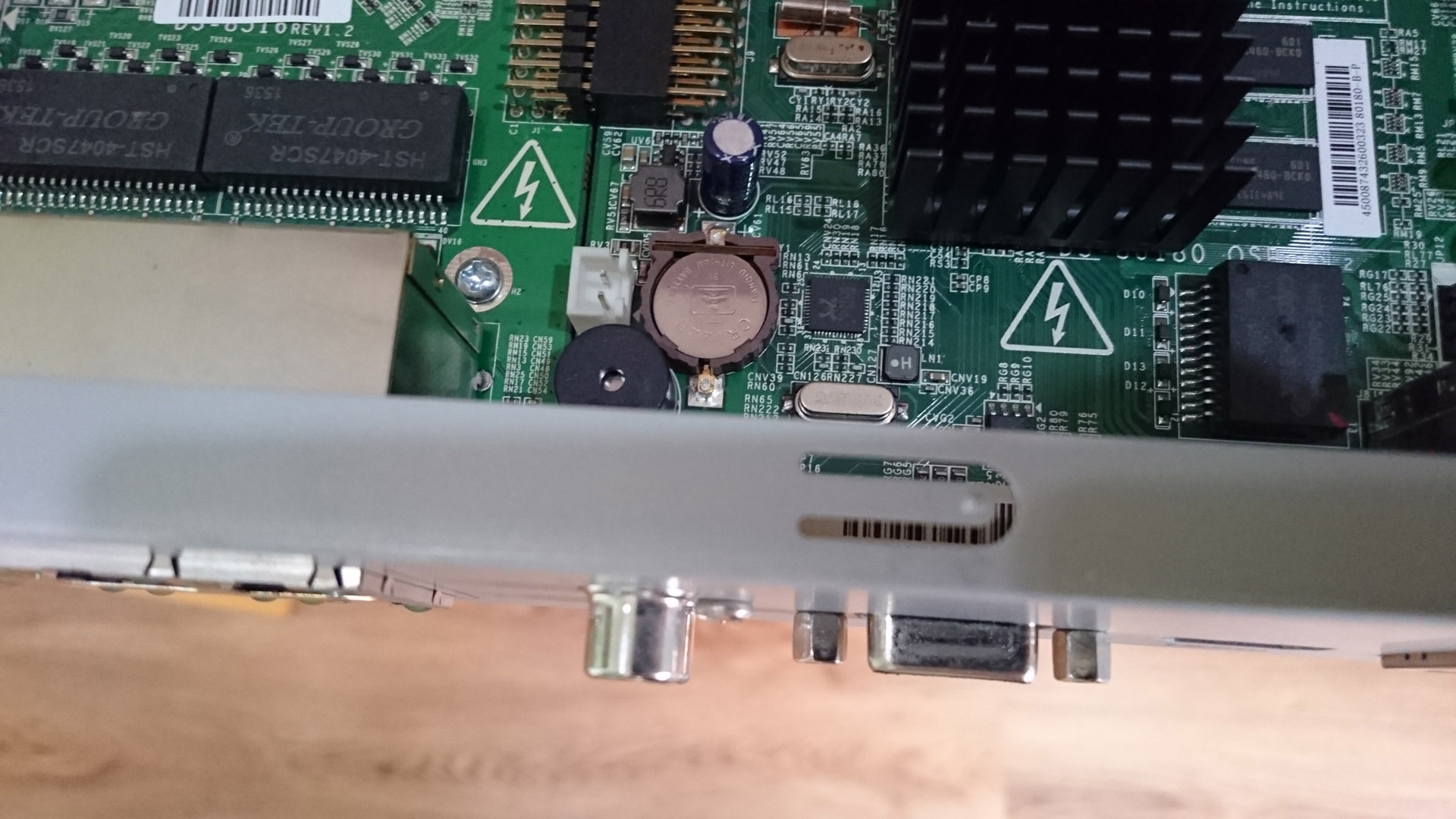

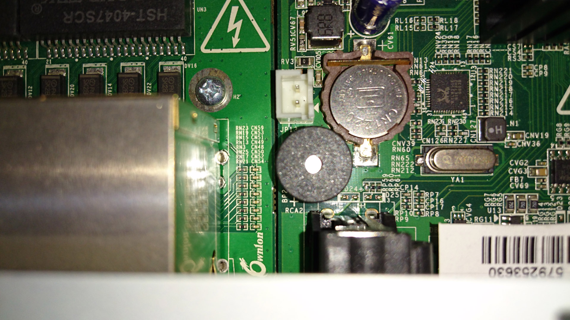

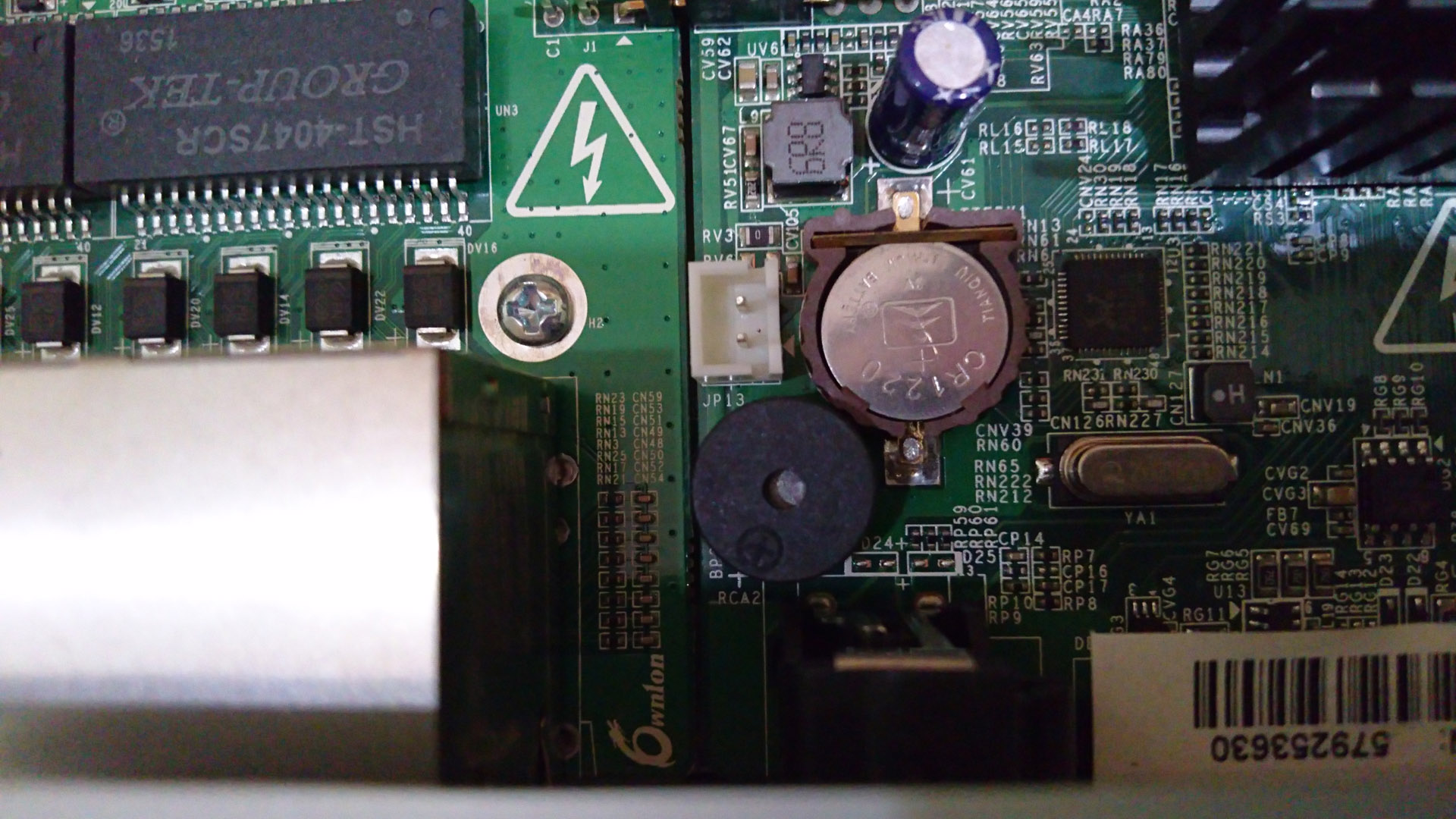

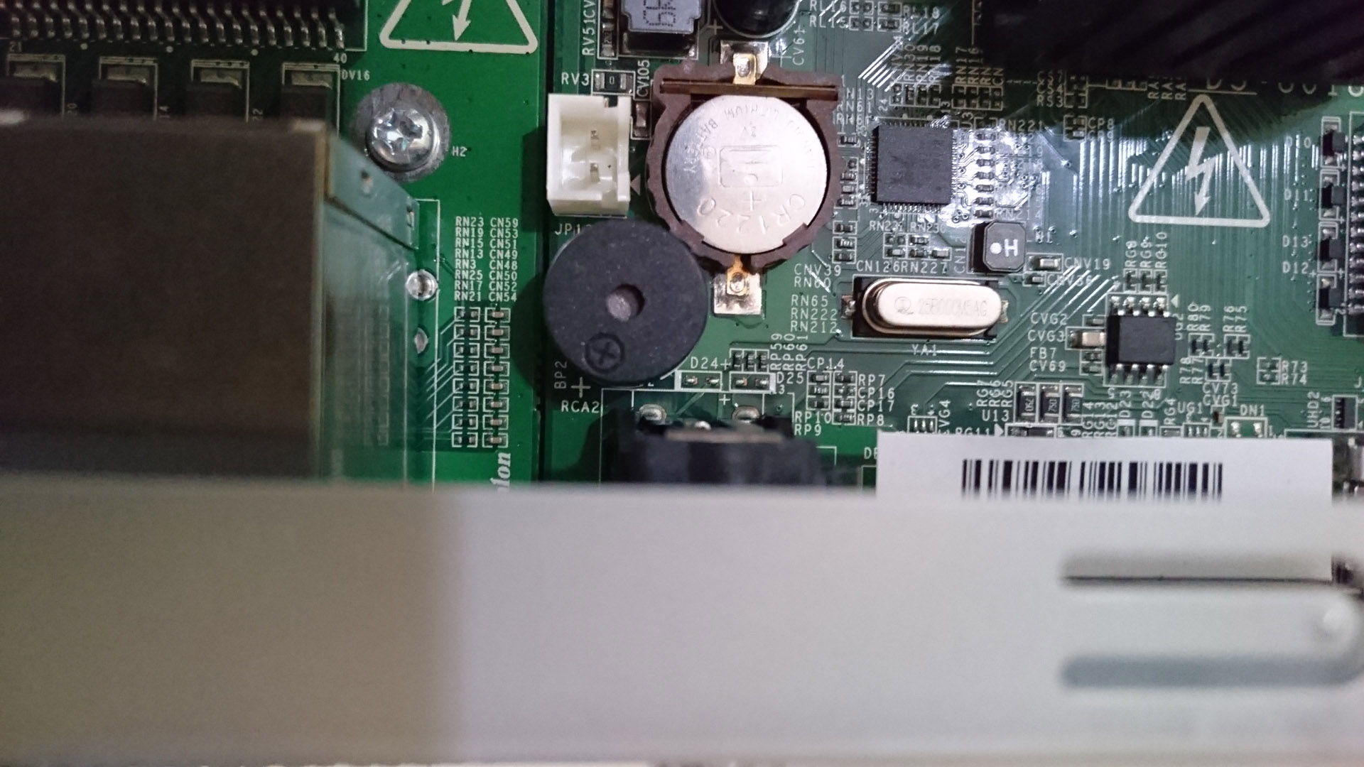

I took pictures of my NVR buzzer. I wanted to ask you what you think of it?
It was suggested that I solder wires to the contacts and then hook it up to an Arduino.
I can't find any drawing diagrams of the board. The model is DS-7608NI E2/8p.
Here is the manual: **broken link removed**
Still looking for the board drawing...
Cheers.
