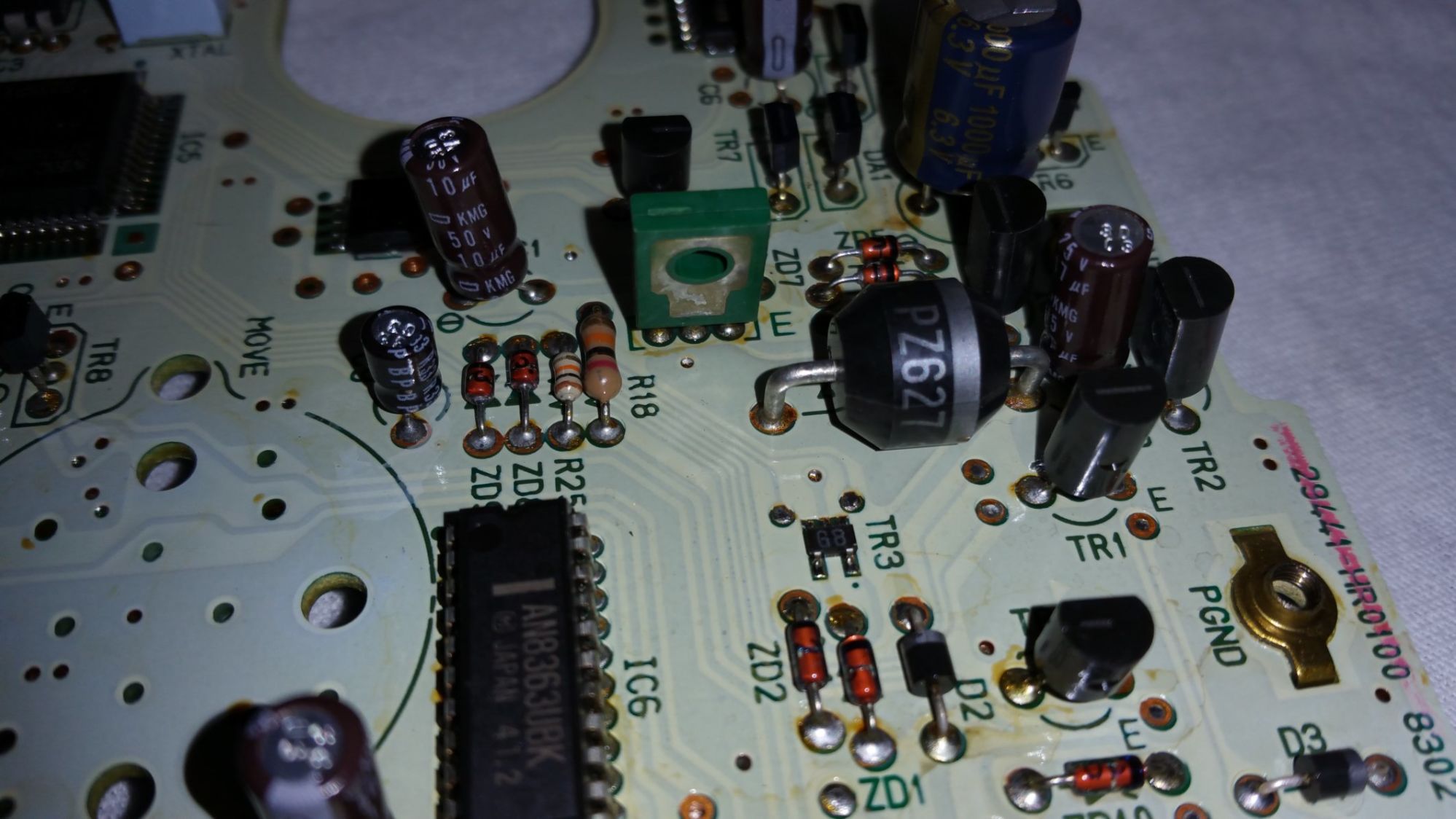

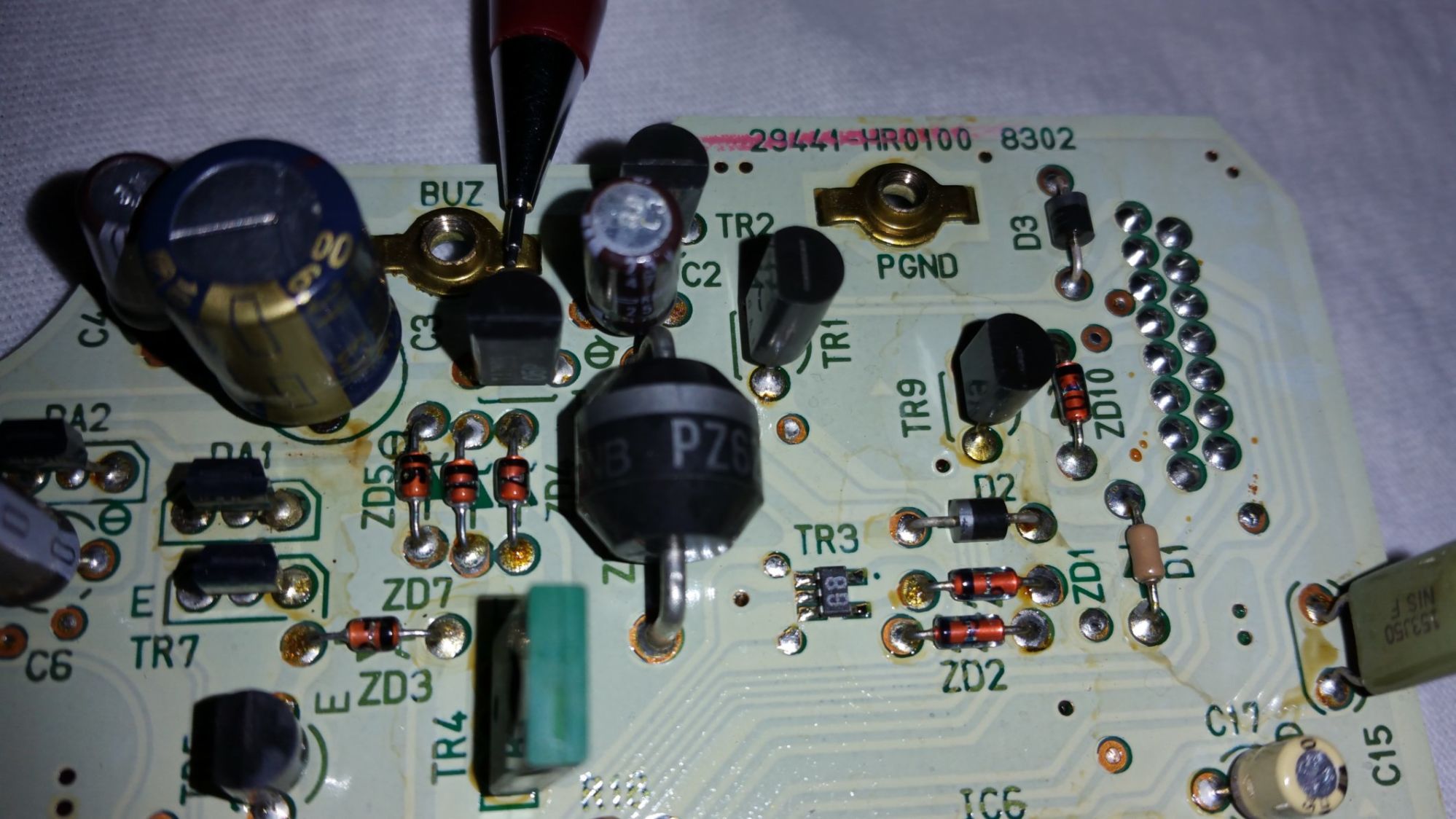

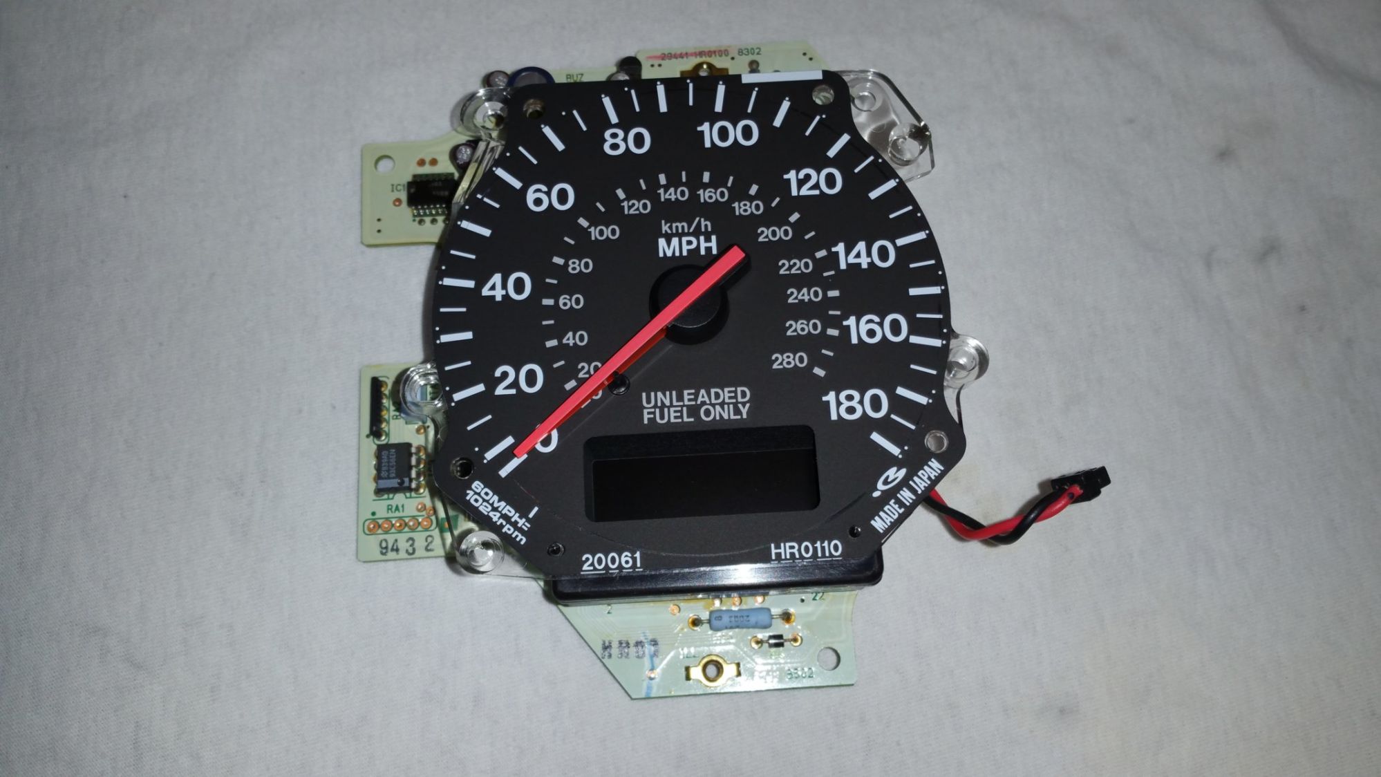

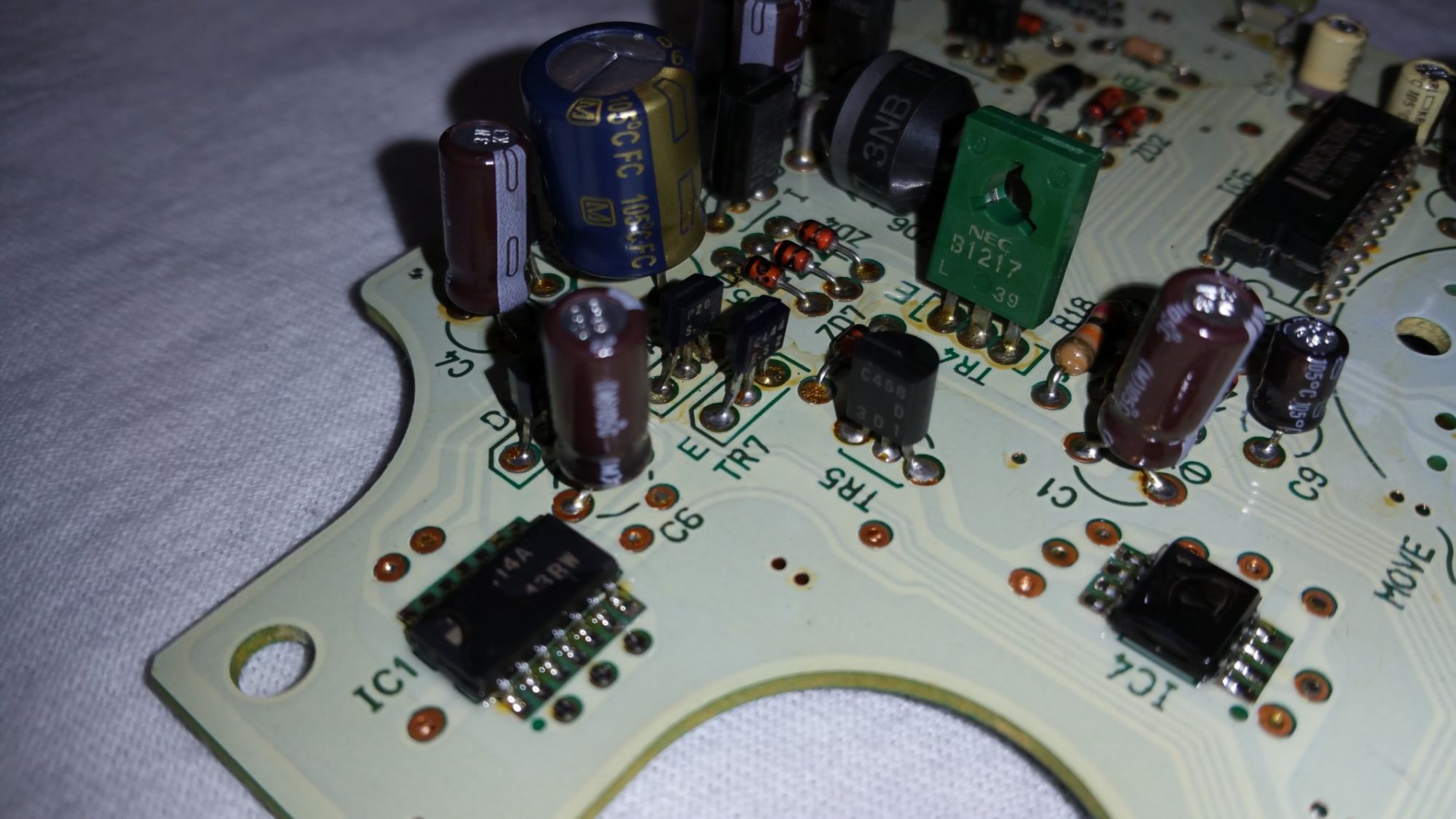

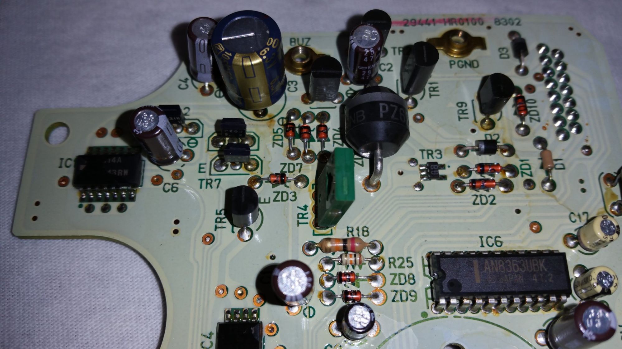

I need help finding equivalent parts to repair my Odometer to one of my cars. So the problem was that the Odometer display wouldnt show, stopped working. Everything else on the gauge cluster worked. When I took it apart, C3 Capacitor was blown. I went ahead and replaced the surrounding Capacitors being 10uf/50v as listed below. Plugged everything back in and still nothing. So I took apart again and checked all connections, all the surface mount chips had good connections. I checked the below described diodes and transistors. Used my desolder gun to remove them and check with meter as they looked corroded and two of them pretty much crumbled when removing (the leads that is). So now I am stuck needing replacements.
So this was taken from another forum. I need to know TR6, DA1 and DA2 (in red lettering below) equivalent replacements. This is for a 1993 Mazda RX7 car. This is the only information I have, so i dont know any more about the diodes and transistors.
