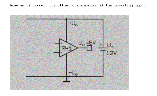

can anyone help me with this pls?
Define offset in this context.

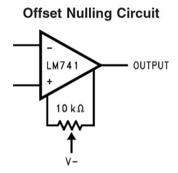

Maybe your teacher does not know that most single opamps like the lousy old 741 have input offset terminals.
