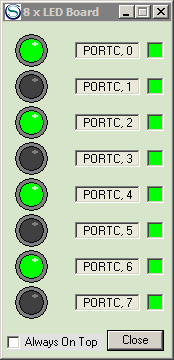

This code will work, assuming you're using a simple _RC_OSC instead of a crystal, if you're using crystal try _XT_OSC or _HS_OSC instead. I've also modified it to light even bits on PORTC
PS your old code may also work, if so it's most likely your Mac emulation is not perfect, try it on a real XP machine before you give up on it.
    list        p=16f877A    ; list directive to define processor
    #include    <p16f877A.inc>    ; processor specific variable definitions
    __CONFIG _CP_OFF & _WDT_OFF & _BODEN_OFF & _PWRTE_ON & _RC_OSC & _WRT_OFF & _LVP_ON & _CPD_OFF
    ORG     0x000             ; processor reset vector
    bsf    STATUS, RP0    ;B1
    MOVLW     b'00000000'    ;B1
    MOVWF     TRISC        ;B1 all outputs on PORTC
    bcf    STATUS, RP0    ;B0
    MOVLW  b'01010101'
    MOVWF  PORTC
    GOTO   $            ; loop forever
    END
