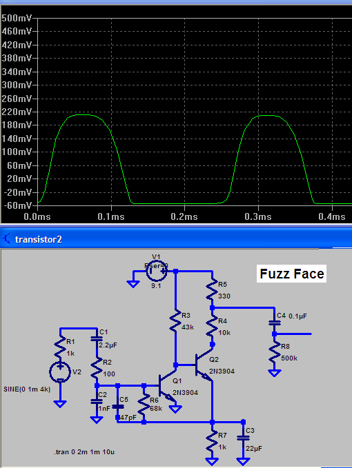

How does the fuzz face operate like a rectifier ?
Because it doesn't have negative feedback and it is improperly biased.
Here is a sim of it playing a pure sine-wave. Notice how the lower part of the sine-wave is removed, like a rectifier:

"Notice how the lower part of the sine-wave is removed, like a rectifier"
How does the fuzz face "Remove" the lower part like that ?
How does improperly biased circuit act like a rectifier?
If the face face had "negative feedback" would there be "more" or "less" 2nd harmonic distortion?
Learn about how to properly bias transistors.
Negative feedback reduces distortion.
