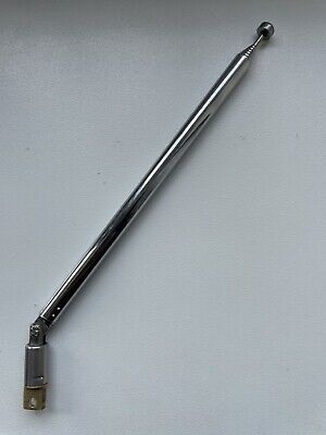

It should look like this:
The end "knob" screws on to the centre rod in the aerial; what others have referred to as a nut. Either that has fallen off & the rod fallen back inside, or the entire centre rod has pulled clean out of the other tubes.
Replacement antennas are fairly easy to get for better known types, eg. this may be suitable:
