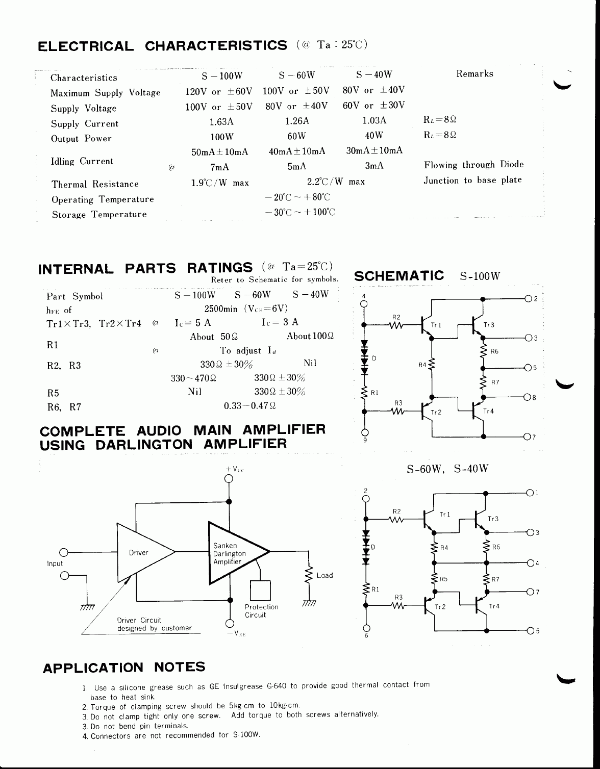

I am in search for an old amplifier in an old receiver. I figure if I can get the amp portion of this receiver working it could be a neat thing for me to continue using it. It is an old Nikko NR-815. It has two SanKen s-60w amps in which one, I believe is bad. I probably could not find an equal replacement. But I have found a s-100w which is on the same spec sheet. My question is, could anyone tell me if I could replace the 60's with the 100's without blowing anything up or without wasting a few good dollars on something that would not work in the first place. What I hope is, attached to this post is a spec sheet showing both of these amps. Would you ever put the 100's in place of the 60's is my question?
Thanks, RLH

I see no reason that you couldn't use the 100W version. The quiesent current might be a bit higher 50mA vs 40mA, but that shouldn't hurt anything...

My take: If you have a +-50 V supply, then yes provided you re-route the pin numbers.
If you have a +-40 V supply, then probably not.

Compare the pin numbers of the 60 and 100 to what they are connected to. They don't match up.
Look closely at the spec sheet. At 50 V they both will work, although I'm never too happy when one channel is different. If you replace a single tweeter with an unidentical one, the system may sound different.

Yeah, if I should try a 100 I certainly will get two(one for each side). I must be missing something. BeerBelly must have been talking about the same thing as far as pin outs. I guess I don't understand what you guys are talking about. The schematics are nearly identical, but the pin numbers are different. Are you saying because of that they couldn't be interchangable even though schematically they appear the same?
Well, now that I think about it, I think I see what you guys are talking about. The pin arrangement might be identical but what each pin has on them must be different? They both must have 7 pins and would mount and connect to the CB in the same way but you are saying that each or some of their pin values are different. I find it curious that the 60 is numbered 1-7 but the 100 is numbered 2, 3, 4, 5, 7, 8, 9 (no pin 1 or pin 6). So I'm not quite sure how to interpret that. I guess I would have to have both to ohm out each for comparison. Right now I have not even removed either 60s. I am just assuming one is bad. I guess I should at least switch them and see if the problem switches to the other side or at least remove both and ohm each one out to see if they are same. At least that way I would be more knowledgable about what to expect the ohm readings of a good component to be. Right?

Well, I have some good news. I took out the amps and started ohming them out, looking for differences between the two and low and behold I did notice a difference between pins 2 and 6... the input signal ... between the two. On the one in which came from the bad side it was intermittent. It appeared that when I pressed down harder on pin6 it leveled out. So I bent with my fingers up and down a couple of times and then I started getting a consistent ohm reading. With that I put them back in but switched sides. Both sides are back to full strength. I really do think that there was something with pin6 that was mechanically inteferring with the electrical signal. As old as these are it doesn't surprise me. When in doubt, jostle connections. It seems to so often come down to connections. I believe that was the problem here. So glad am not now tempted to try the 100's! From the different numbers on the pins, that could mean that the surrounding circuits for each of the 60s and 100s are different from each other, which sounds like what you guys had already determined. Figuring that out I think would have been above my head.
