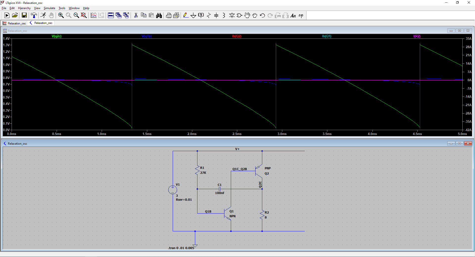

this is complementary multivibrator.
here is what I can understand: at first,vcc goes through r1,c1,s,to charge c1 . when c1 left voltage goes to about 0.5v, q1 starts to conduct. and that makes q2 to conduct. and collector voltage of q2 goes high. this is coupled to base of Q1 by c1. this is positive feedback.
my question: what will happen next?how vibrator works?

That is a really old circuit that produces "Geiger counter" style clicks. It's a relaxation oscillator, not actually a multivibrator.
It's not a nice circuit; when the transistors turn on, it's effectively shorting Q2 base-emitter across the power supply... It does work, but I'd suggest only running it from smallish batteries that cannot supply high currents, to avoid cooking the transistors.
Connect eg. a 1M pot in series with R1, to be able to slow down the clicks.
This is the sequence:
C1 charges via R1 until Q1 starts to conduct, That in turn causes Q2 to conduct, and it's collector (the speaker upper terminal) is pulled positive.
That makes the right hand end of C1 positive, and that then has to charge in the opposite direction, via the base of Q1, "locking" that on until the charge current through C1 drops down enough, then Q1 & Q2 turn off.

I think voltage of right hand end of c1 goes up doesn't charge C1 to opposite direction. c1 will couple it to base of q1.
I think q2 base will be fixed to vcc-0.7v.
It will but the base is also pulled down to ground via the other transistor when it turns ON, so the 'be' junction of Q2 is directly across the battery - BOOM!!!!!. As has been said, a crappy circuit with important components missing.

This is a simulation of the original circuit, operating from a 3V power source that can provide very high current.
Q1 base current peaks at ~30A and Q2 base current peaks at ~40A.
The load current in to the 8 Ohm resistor (representing the speaker) peaks at about 150mA
Q1 base voltage stays around 0.7 - 0.8V, the right hand side of the cap (Q2 collector) swings between 0V and 1.3V

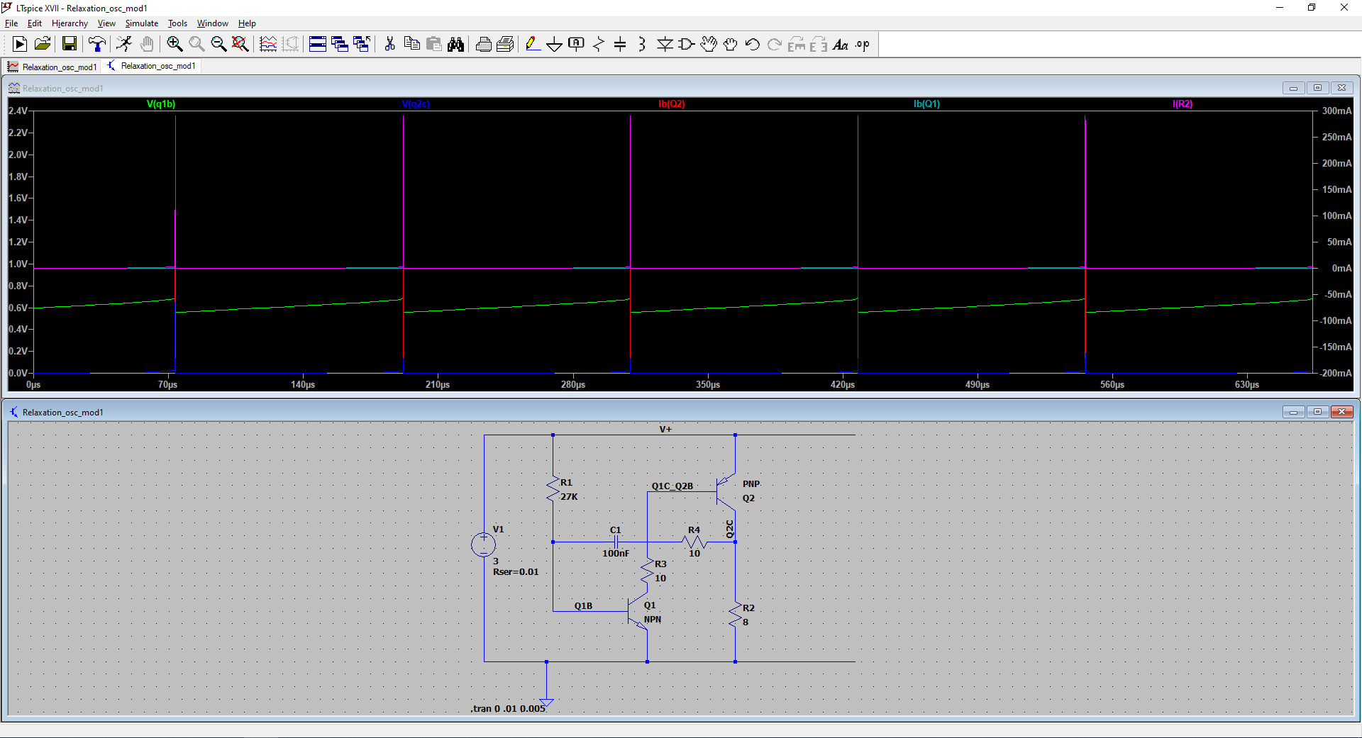

Adding a couple of low value resistors to limit the base currents takes the peaks down to more realistic levels, and increases the current through the load to around 300mA peak.

When the circuit triggers and both transistors turn on, the right side of the cap is pulled to power while the left cannot vary much from 0.7V, so it very rapidly charges in the opposite direction.
is it charge or discharge?I think it is discharge. the road is: c1 left ---q1 base-emitter---gnd---vcc---q2 emitter-collector---c1 right. but the problem is c1 right hand voltage is high, should it be low? and how?
why should it discharge? why not stay at the transistors turn on state?
The transistors do not have enough gain to stay saturated "on" and sustain the current through the 8 Ohm load, with just the 27K providing base current.
It relies in the capacitor reverse charge current to hold it on, once it starts to turn on; as soon as it starts to switch out of saturation & the voltage across the load drop at all, that change is coupled to the first transistor base and both shut off.
To me, "discharge" is reducing to or towards zero voltage, like "stopping" is reducing to zero speed.
Reversing voltage like reversing direction on a motor is charging / accelerating in the opposite direction. It may go through zero but that's not the end state.
Look at the sim of the unmodified circuit:
The blue trace is cap left, the green cap right. The green trace goes both far more positive and far more negative than blue: The cap is charged in both directions / both polarities.
