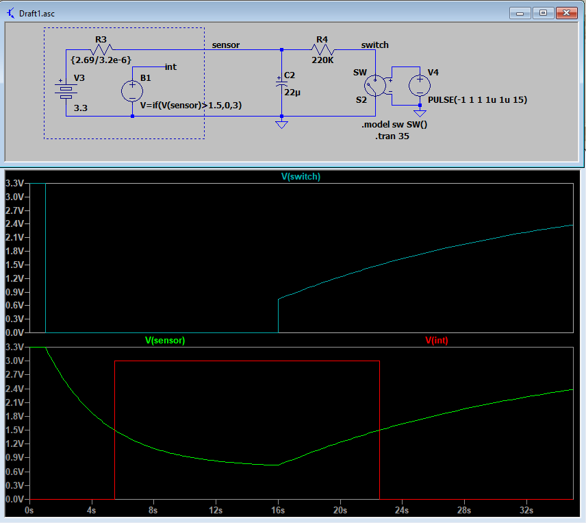

I need a simple solution to introduce a delay for a sensor that monitors a dry contact switch. The delay will prevent false sensor activation on transient switch closures.
The sensor uses a 3v CR123A battery. When the monitored switch closes the two contacts on the sensor are connected and the sensor transmits a signal.
Can I connect the sensor to resistor in series with a capacitor, then to the monitored switch, then back to the sensor? If so, what R & C values should I target for a 5-10 sec delay?

The monitored switch is a normally open set of contacts on a residential heating boiler. The contacts close if the boiler has a fault condition. However, for unknown reasons, it momentarily closes the contacts at the end of each run cycle which causes false alerts.
Hi, I don't know what type of trigger the sensor uses. It's an Aeotec (Z-Wave) dry contact sensor. Their tech support could only say that "we don't think a resistor/capacitor would affect the sensor as long as it does not add voltage."
I found a simple and cheap on-delay relay that allows for a user determined delay on the input side prior to closing contacts on the output (which now connect to the Aeotec sensor). The only downside was the need to supply 12v DC for the relay, but it only uses power when the boiler fault contacts are closed.

Thanks for taking the time to do that. The open-circuit voltage is 2.69v, the current is 3.2uA. The Aeotec support responded again and said that the voltage at the terminals should be 3-3.3v. But the battery is nearly new with the readings I got.

Here is a hack at a passive circuit:
Presumably, there is some sort of circuit inside the sensor which is watching V(sensor). It makes some decision about if the "switch" is closed or open based on V(sensor). I model that as a behavioral voltage source which is low if V(sensor) is > 1.5V, else 3V. You could refine that estimate of the internal trip point by actually controlling V(sensor) with an external pot, and seeing at what external resistance from V(sensor) to ground causes the sensor to report that the switch is closed.
In the meantime, here is what would happen if R4=220K, C2 = 10uF, and my guess of the internal trip point is ~1.5V. Notice the value of R3... That might be revised when you answer the question in the previous post.

Lets assume that your meter is sufficiently HiZ input.
In lieu of getting the specs for the sensor, you can do this experiment: Substitute a 1megOhm pot for the "switch". Starting from max resistance, slowly reduce the pot resistance until the sensor acts the same as if the pot was a closed switch. Disconnect the pot and measure its resistance with your Ohmmeter.
Now turn the pot to zero resistance, reconnect the pot and turn it the other way until the sensor acts the same as if the "switch" is open. Measure that resistance, too, and report back with the measured values.
