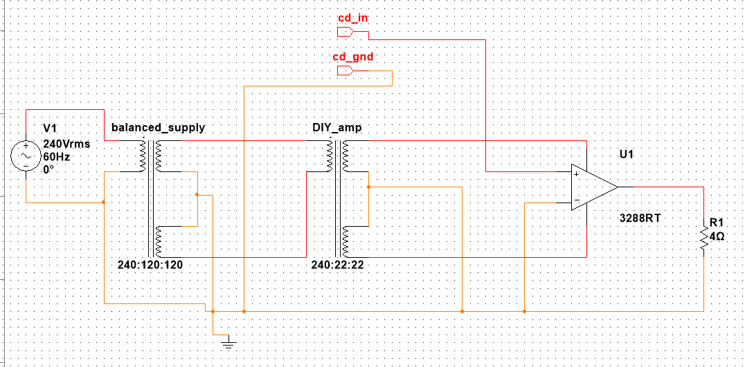

on-line UPS or balanced power supply?
You do not say what you are trying to achive. I suspect you are havinig a problem with hum or noise on audio equipment. The two diagrams on your first link show the power from the substation. The transformer shown will be is the substation (It will be one of the three windings on a three phase transformer.) It is unlikely that a separate earth wire is run from the substation to your house. The earth and neutral are probably connected together where the cable enters your house and this point will also probably be bonded to your gas and water pipes. (Assuming they are not plastic.) and possibly a ground spike. Although there will probably be a difference of potential between the substation earth and the earth in your house there will be very little potential between the earth wire in your house and the earth in your environment. I think adding a UPS will cause more problems as there will be radiated interference from the high frequency switching circuits in the UPS.

When I built my home theater room I decided to provide power to the room using it's own sub-panel that was powered from a 240 transformer circuit from the main panel to create a 120 0 120 separately derived power system with it's own neutral/ground connections only for the room to eliminate ground loops. One 120 leg was dedicated to AV circuit power while the other 120 leg was for lighting and general power circuits. Just having a transformer or UPS on one device does very little to to improve electrical power quality or the noise floor from hum.
all devices have to be behind the balanced supply or the UPS. Seems to work (see omage). UPS has the advantage, it makes 240V. In Australia there are plenty of brownouts and blackouts. Plus the actual voltage is 250V and more.
I don't see why you think a balanced supply will help. Other than the capacitance between the primary and secondary of the transformer there is no electrical connection. Also in reasonable quality transformers there is a foil screen between the primary and secondary which eliminates this capacity coupling. With older audio equipment that had an earth wire there were always earth loops formed as the earth on the mains leads was in parallel with the earth of the signal leads. There could also be small currents on the earth wire due to the current though capacitors in mains input filters if fitted. (These normally have a capacitor to earth from neutral and live as well as one between live and neutral. More modern filters tend not to have a capacitor from live to earth as the accumulated current from a number of filters may cause RCDs to trip.) More modern equipment tends to have double insulated tranformers and do not require a mains earth so this eliminates ground loops and reduces hum problems. You need to treat hum and noise pickup as two separate problems.

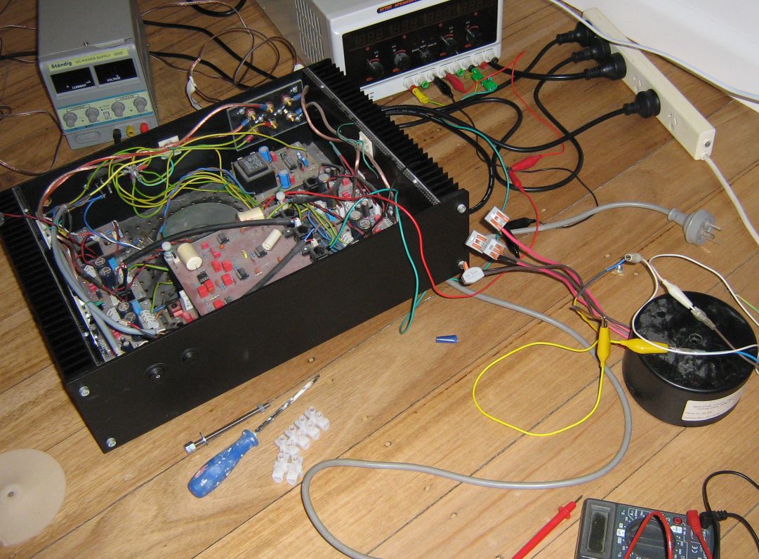

I am worried the whole thing swings at 50Hz and thats why I cannot get rid of the hum. Put it all on star ground, its not helping. Have to find some time and connect the amp secundary to a lab power supply, see what happens then.
Just in case, it will be a struggle to get cast double insulated transformers with shield and all that in Australia I guess. Its pretty light on suppliers for electronic components...
if feed DC in fom a lab power supply its all quiet, but as soon as I plug the power cable into the housing, the noise is back. Its not actually a pure 50Hz hum, more a scratching noise, 50Hz with lots of over tones. The housing has a ground connection, one of these 3 pronged ones like PCs.
Suppose thats why the osci would not show anything, hangs on the same messy ground.

Maybe I should put the power supply into a separate box and only feed DC in. Most of time an amp draws a few mA and conducting DC has less resistance than AC, no inductive and capacitive part.
It seems to be higher frequency, I got some 2 way speakers someone threw out, its only in the mid/high driver. In my active speakers it comes out from every driver, must be induced into the amplifiers after the crossover.
Since lab power supplies are switch mode and there was no noise, maybe I go for switch mode. Without any input it drew about 100mA on the DC end
I think I found it. Made a special cable and only connected the ground to the housing. Alas, its quiet. Put the 3 pole cable back on, the noise is back. If I leave the amo running and take the earth cable off and put it back on, there are tiny sparks.
So I reckon I put the 240V part into a separate housing. There are 2 options, take the 2 analogue ones with massive transformers or buy 2 switch mode supplies at **broken link removed**

I think we need to see some sort of picture.
ok, I mean the safety ground, the green-yellow. This meets the blue/neutral at the meter box. There is a connection to the earth spike. But as mentioned, earth spike is useless at 240/0 V.
So, only safety ground to the metal housing, its quiet. Putting the full connection back, L/N/safety ground, the noise is back. So I guess the main transformer (220W) makes the hum and induces it into the housing, even when switched off. As the off switch is single prong, so one end of the transformer could sit on L or N. .au plug is not symmetrical, have to check. So the L end of the transformer should be actually disconnected. But I built it in Europe initially, where the plugs are symmetrical, so did not bother. It did hum back there as well, so its nothing to do with my particular home.

hm, ok, its more a buzz. When I run the emps via wht lab power supply, there was a very faint 50z sine tone from the low driver, but that I can live with. Not listening to it wtih 2cm distance. So now, put transformer into separate housing. Power supply needs ceramic caps across diodes (instead film caps). Will pull out the transformer tonight and move it away from the housing, see what happens then. Would a double shielded transformer help, read something about some special shield?
edit: yes, the life wire was connected to the transformer, the switch went to neutral. Took the transformer out and now is quiet, even power cord pluuged in.
