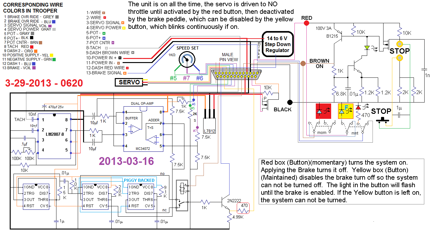

On my off road vehicle, 08 Joyner Trooper, I have installed a engine speed controller that I use as a cruise control to maintain speed, nice thing about it, it does not care about speed, circuit attached. I also have a power steering unit of my own design, but I'm still refining it. Here's the problem, While cruising along with the engine speed controller working just fine controlling my speed, when I turn the steering wheel, engaging the power steering unit, it causes the cruise control to reduce the speed all the way to idle, basically it shuts off until the power steering has finished it's job and returned to idle.
I've tried to decouple with capacitor, but no luck. It's not really a problem, but definitely a curiosity.
Got any ideas as to what's happening?
Thanks, Kinarfi

The high current draw of the power steering is perhaps pulling down the 12V supply of the speed controller.
Try feeding the speed controller 12V line via a diode and use a few-hundred-uF cap from the diode cathode to ground. That should hold up the 12V.
So, what your saying is that the power steering is pulling the voltage down enough to effect the cruise control, right?, if that's the case, maybe a larger cap is in order to keep the voltage to the R/C servo up is in order.
I doubt the 5V servo supply is dropping. Isn't that derived from a voltage regulator? I think it's the pulse generator creating the servo pulses which needs a more stable 12V supply.
