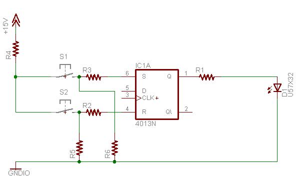

there are two buttons On and Off. When the On button pressed a light turns on and stays on regardless of how many times the On button pressed. The light could be turned off only by pressing the Off button (providing that the Off does not turn back into ON)
I have a power supply 15 volts and I'm looking for a chip (CMOS) that I could buy fom Digi-Key

I'm looking for a chip that would perform such a function

I checked some manuals and 15V is the upper limit on some , but not all CMOS chips , others are 18V .. so your 15V should work.But check the specs before ordering..S1 turns Led on S2 turns Led Off..R1's value depends on what you want to use as an indicator..R2 & R3 Should be 100K to 1Meg..
R4 = 100K ohms..
R5 & R6 =100K to 1 Meg
EDIT : Revised circuit..

Thank you, that what I need , but what about D and CLK inputs, should I leave them how you showed, or put on high or low level .
thanks again .
CMOS ic inputs cannot be left floating, as will damage the IC. Also U have to tie all the other inputs, of the unused section to GND.

i stand corrected.. ok then ground all unused inputs
please dont ground any unused outputs..
